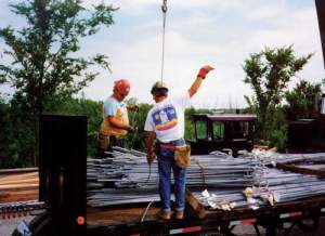

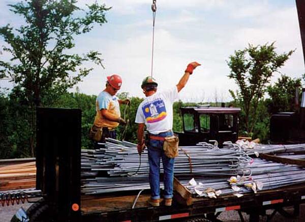

Durability & Bond Strength
A strong metallurgical bond between the steel rebar and zinc coating is created during the galvanizing process. Galvanizing is metallurgically bonded to the steel, meaning when rebar is dropped, kicked, stepped on, or rubbed against existing concrete or other rebar pieces on the job-site, the protective coating will remain tightly adhered. This durable zinc coating will withstand the effects of UV light, temperature extremes, and exposure to rain or snow, thus protecting the rebar both while it is stored and when in use. From installation through the use phase, galvanized rebar is abrasion resistant and durable.

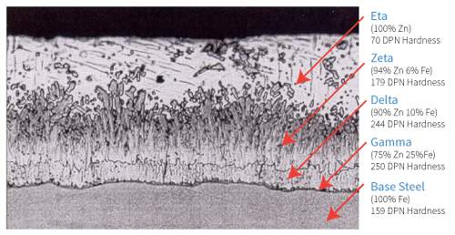

Abrasion Resistance
A unique characteristic of the hot-dip galvanized coating is the development of metallurgically bonded (~3,600 psi), abrasion resistant intermetallic layers. The photomicrograph below is a cross-section of a galvanized steel coating showing the three intermetallic layers (Gamma, Delta, and Zeta) and top layer of pure zinc (Eta). During the galvanizing process, these layers develop naturally during a metallurgical reaction between the iron in the steel and zinc in the kettle. As the photomicrograph also shows the hardness of each of the layers as a Diamond Pyramid Number (DPN), you can see the three intermetallic layers are harder than the base steel, while the eta layer has ductility which makes damaging the HDG coating very difficult. Hot-dip galvanizing's abrasion resistance provides unmatched protection against damage caused by rough handling during transport and erection, as well as in service. Other coatings with lower bond strengths (300-600 psi) can be easily damaged during shipment and construction, weakening their effectiveness, as barrier protection is dependent upon the integrity of the coating.

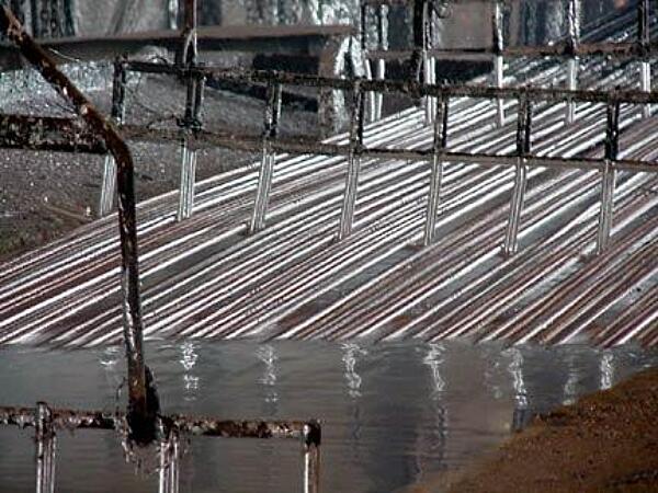

Complete Coverage
Hot-dip galvanizing is a total immersion process, meaning the steel is fully submerged into cleaning solutions and the molten zinc coating all interior and exterior surfaces. This complete coverage ensures the entire bar and all design details are coated. Fully coating bars is equally important as they are utilized at connection points which are critical to structural integrity.

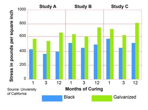

Bond Strength
Good bonding between reinforcing steel and concrete is essential for the reliable performance of reinforced concrete structures. When protective coatings on steel are used, it is essential to ensure they do not reduce bond strength. Studies on the bonding of galvanized and black steel bars to Portland Cement concrete have been investigated.
The results of these studies indicate:
- Development of the bond between black or galvanized steel and concrete depends upon cure time and environmental factors.
- In some cases, the full bond for galvanized rebar may take longer to form than for uncoated steel, depending on the zincate/cement reaction.
- As reported by Stephen Yeomans in Galvanized Steel Reinforcement in Concrete, there are a number of studies that have concluded the fully developed bond strength of galvanized rebar has no significant difference from black rebar bond strength.
- A study by C. Andrade in Spain monitored bond strength of galvanized rebar samples over 10 years immersed in seawater and found no deleterious effects on bond strength over that time.
