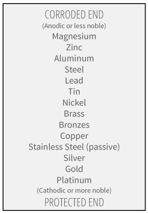

The Galvanic Series of Metals is a list of metals arranged in order of electrochemical activity in seawater (the electrolyte). This arrangement of metals determines what metal will be the anode and cathode when the two are put in an electrolytic cell. Metals higher on the list are anodic to the metals below them meaning they provide cathodic or sacrificial protection when the two are connected. Therefore, zinc protects steel. In fact, this cathodic protection ensures even if the HDG coating is damaged to the point bare steel is exposed (up to ¼ inch in diameter), no corrosion will begin until all the surrounding zinc is consumed.

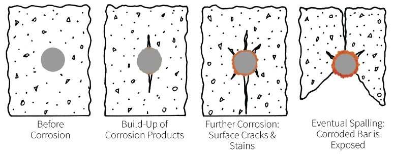

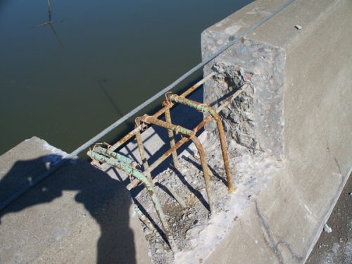

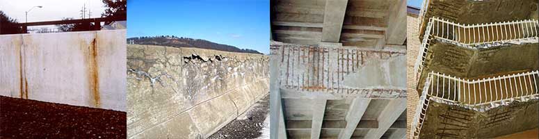

In addition to the higher chloride tolerance, once the zinc coating does start to depassivate, the zinc corrosion products formed are less voluminous than iron oxides and actually migrate away from the galvanized bar into the matrix of the concrete. Unlike the development of iron oxide, the migration of the zinc corrosion products from the rebar prevents the pressure buildup and eventual concrete spalling.

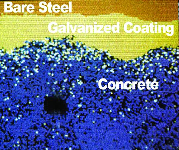

Zinc's corrosion products are loose, powdery minerals that are less voluminous than iron corrosion products and are able to migrate away from the galvanized rebar surface into the adjacent concrete matrix. As a result, corrosion of the zinc coating causes very little physical disruption to the surrounding concrete. The elemental map (left) is evidence of this migration. The white spots in the concrete indicate zinc oxide which has migrated away from the galvanized rebar/concrete interface.
There is also evidence to suggest that the diffusion of zinc's corrosion products helps fill pore spaces at the concrete/rebar interface, making this area less permeable and helps to reduce the transport of aggressive species such as chlorides through this interface zone to the zinc coating. The reactions between zinc and concrete, and the resulting corrosion product diffusion, also explains why galvanized rebar has such good bond strength with concrete.

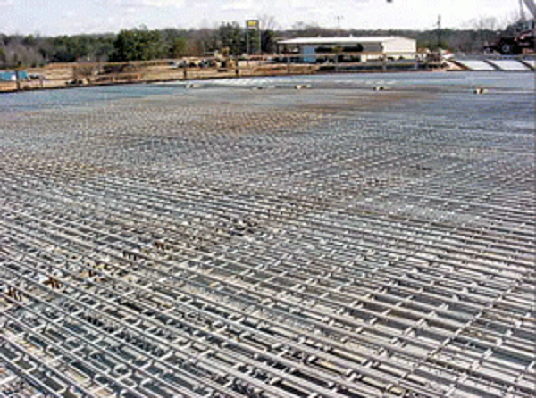

Corrosion Protection Case Study
The Reef- Southampton, Bermuda, 2008
Nestled in the midst of a tropical paradise, the Reef Plaza is also subject to one of the most corrosive environments imaginable. The aquamarine waters and sunny beach location of the concrete plaza floor are susceptible to harsh sun, beating rains, and briny saltwater - making the steel rebar within the concrete susceptible to aesthetic and structural damage such as cracking and spalling. By utilizing hot-dip galvanized steel rebar, the architect of the project was protecting the plaza from the inside out. The rebar will be protected from the nicks and scratches acquired during handling, meaning the pieces will enter the concrete ready to protect against the rust and corrosion that can cause spalling. Galvanized steel rebar will keep this plaza structurally safe and aesthetically pleasing for many years of tropical delight.
