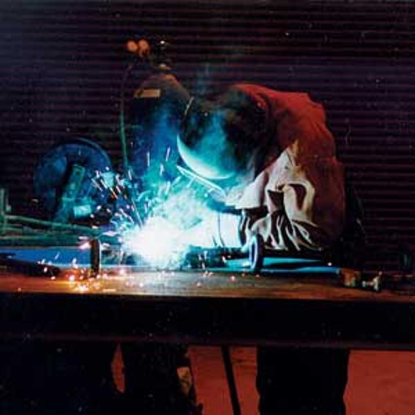

Welding
Welding galvanized reinforcement does not pose any problems, provided adequate precautions are taken. Steps include utilizing a slower welding rate and maintaining proper ventilation (ventilation normally required for welding operations is adequate). More details are outlined in the AGA's Welding and Hot-Dip Galvanizing publication.

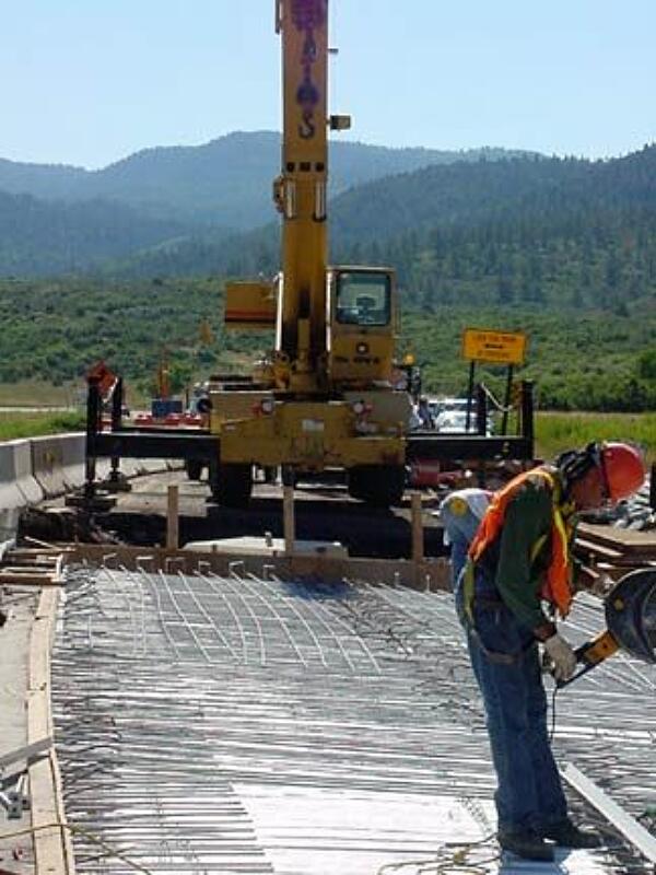

Installation and Handling
HDG can be handled in all temperatures. Epoxy coated rebar may crack when handled in temperatures less than 50 F. Galvanized reinforcing steel can be handled and placed in the same manner as black steel rebar because of its superior abrasion resistance. The zinc coating of HDG rebar is harder than the steel itself. Bundling, dragging, and rough treatment prior to and during placement have no detrimental effect. Epoxy coated rebar requires delicate handling to prevent damage to the epoxy coating. Any damage to the coating prior to placement will compromise the corrosion protection.

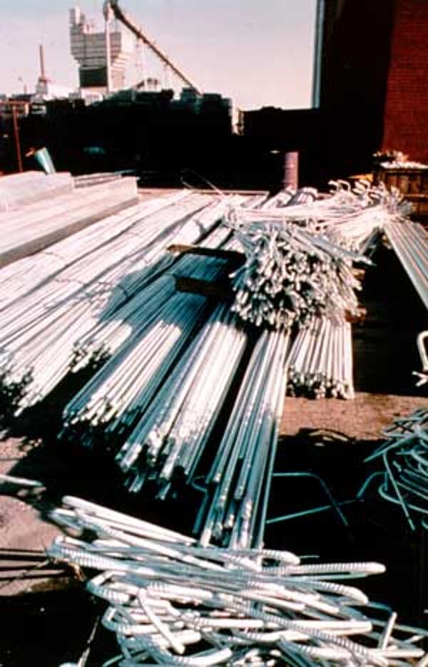

Storage
Galvanized bars can be stored outside without any degradation in corrosion performance from UV light. The ease of storage makes it feasible to store standard lengths of galvanized reinforcement so it is available on demand. (Please refer to the AGA's publications Hot-Dip Galvanizing vs. Epoxy-Coated Rebar or Field Handling Guide: Hot-Dip Galvanizing vs. Fusion Bonded Epoxy for additional information).

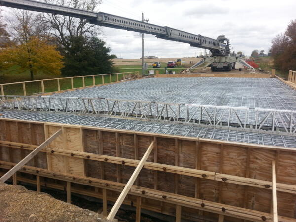

Overlap lengths
Detailing of galvanized reinforcing steel should conform to the design specifications for uncoated steel bars and to normal standard practice consistent with the recommendations of CRSI. Overlap lengths of hot-dip galvanized reinforcing steel are identical to uncoated steel rebar because of the equivalent bond strength to concrete. Laboratory tests show no significant difference in the slip for HDG and black rebar in loaded bars. American Concrete Institute (ACI 318) recommends 20% more overlap when using epoxy-coated rebar.
