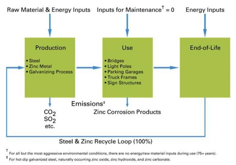

A life-cycle assessment (LCA) is an objective measurement of a product's environmental impact. Often called a "cradle-to-grave" study, LCA quantifies the environmental impact of a process or product from raw material acquisition, energy inputs and emission outputs during production and use, and end-of-life management (recycling/disposal). LCAs have begun to gain favor in the specification community as a means of gauging a product's sustainability. LCAs are used to develop an Environmental Product Declaration (EPD) which will be a requirement in the new LEED v4.

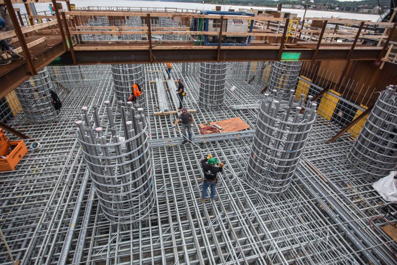

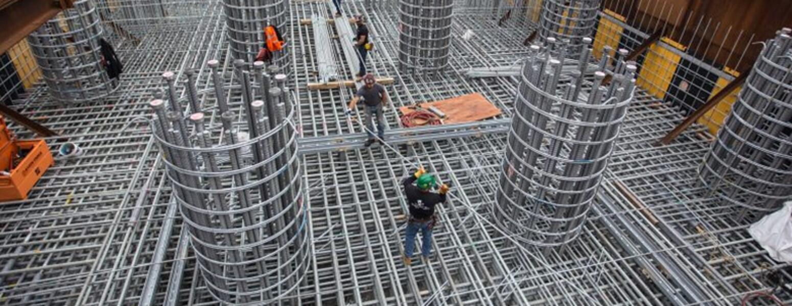

Case Study
The Governor Mario M. Cuomo Bridge- New York, 2018
The Governor Mario M. Cuomo Bridge, which replaced the Tappan Zee bridge, incorporated thousands of tons of galvanized rebar into the final design. The rebar supports concrete in the decking, supports, columns, etc. Galvanized rebar ensured the product withstands the rigorous handling the rebar pieces went through from the galvanizing tank to the pouring of the concrete.
- The bridge opened the first span in late 2017 and is estimated to be completed in 2018
- $3.9 billion project
- Two 3.1 mile-long crossings with 1,200-foot-long cable-stayed main spans
- Tappan Zee Bridge currently carries 140,000 daily
- 96-foot wide new structure began carrying eight lanes of traffic before the end of 2017
- Northern bridge will include bicycle and pedestrian lanes
- 100-year design life
- Uses as many precast elements as possible
- 68, 300-ton pile caps are reinforced with galvanized steel: each one is 13ft tall, 10.5ft wide, and 92ft long and reinforced with 70,000 lb of galvanized steel rebar and prestressed with 28 galvanized strands, then filled with 150cu yd of concrete.
