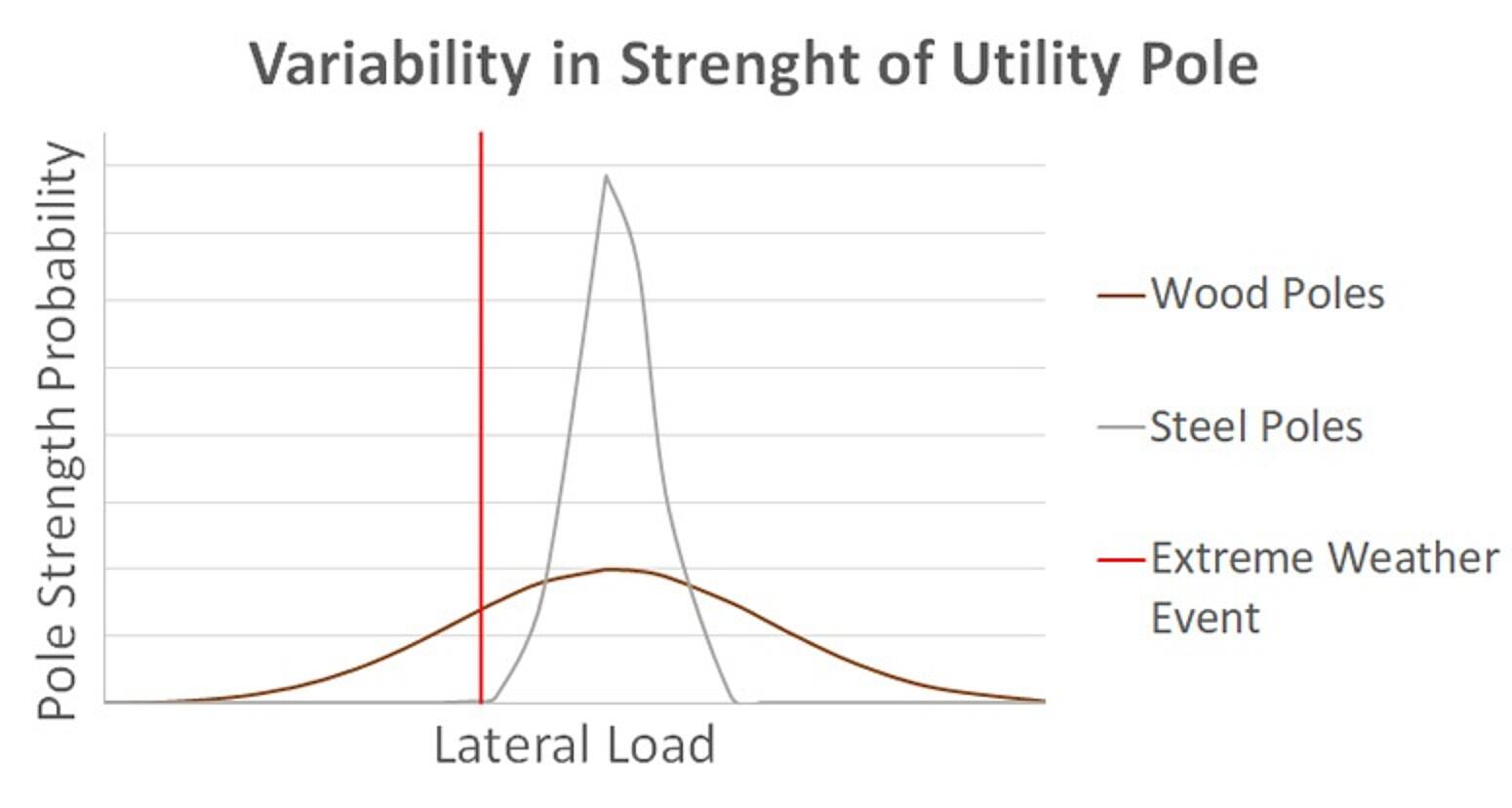

One of the biggest advantages of using galvanized steel in utility projects is its consistency in strength rating. In comparison to other materials, such as wood, steel is manufactured and engineered to a very strict specification. Wood is a harvested product, which contains varied grain patterns, knots and other imperfections.
The graph represents the range in strength of utility poles you can get for a certain size. With any product there is always some variability from pole to pole on its strength. You can see from the wood line the range of strength a pole can handle is much larger compared to steel due to the difference created in wood being a harvested product. This variability becomes a problem when you see larger loads or when you're approaching the design limit of each pole. Given that for most extreme weather events will be near the limits of the designed strength rating, more poles and structures will be able to withstand these events.
You may see a similar graph to this given by someone in the wood industry stating variability is a good thing. They point to the fact that a small percentage of poles has a much larger strength rating then was specified. What fails to be taken into account is that similar percentage will have a strength rating much lower then specified, which can create safety and reliability issues.
