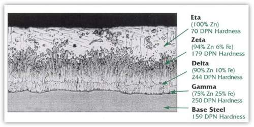

A unique characteristic of the hot-dip galvanized (HDG) coating is the development of tightly-bonded (3,600 psi), abrasion resistant intermetallic layers. The photomicrograph (below) is a cross-section of a galvanized steel coating showing the three intermetallic layers (Gamma, Delta, and Zeta) and top layer of pure zinc (Eta). During the galvanizing process, these layers develop naturally during a metallurgical reaction between the iron in the steel and zinc in the kettle. The photomicrograph also notes the hardness of each of the layers as a Diamond Pyramid Number (DPN). As you can see, the three intermetallic layers are harder than the base steel, while the eta layer has ductility which makes damaging the HDG coating very difficult.
HDG's abrasion resistance is beneficial in several power markets. For instance, in coal generation, there are jagged, hard coal rocks moving through the plant on conveyor belts, into hoppers and chutes, etc. which could easily scratch or nick coatings with less bond strength. Other corrosion protection systems, such as paint only have bond strength of 300-600 psi. Wind generation similarly can be very abrasive to the turbines and ancillary structures. Harnessing wind to generate power is inherently abrasive as wind carries sand, dirt, and other debris and the towers are often in remote locations without constant access for inspection, which means damaged coatings could go unnoticed. The abrasion resistant intermetallic layers of hot-dip galvanizing can withstand these daily rigors without damage or maintenance.

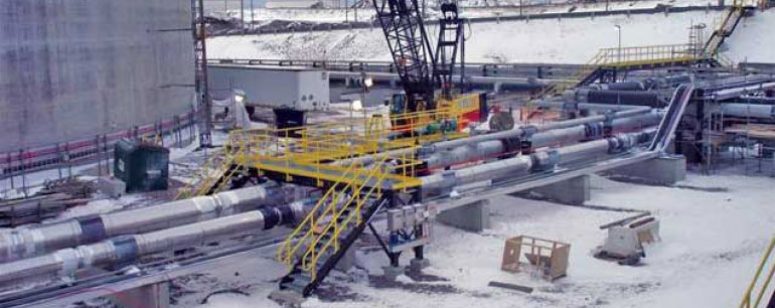

Durability Case Study
Canaport - Saint John, NB, 2008
The unforgiving environment of the northern Atlantic coast, replete with strong winds, salt water, and extreme winter conditions, makes the area primed for corrosion. Utilizing hot-dip galvanized steel throughout the Canaport Liquid Natural Gas (LNG) regasification plant will combat such corrosive elements with a superior system of cathodic and barrier protection.
Reaching approximately 1,650 feet into the Atlantic Ocean, the port serves as a safe docking environment for LNG ships arriving from around the world. Grating, guardrails, and support structures totaling 250 tons, exposed to the frigid, soggy environment were hot-dip galvanized to prevent the hazardous effects of corrosion in this busy port. Canaport connects natural gas fields from around the world to North America and will supply nearly 20% of the natural gas for the Northeastern US and Canada in the near future.
For Canaport, the importance of initial versus long-term cost was a high priority the company was looking for a protective coating that would provide a long lifespan with minimum future maintenance. Hot-dip galvanized steel will remain maintenance free for 50+ years, saving the cost of constant touch up and preservation, so the port can continue corrosion-free operation for decades to come.
