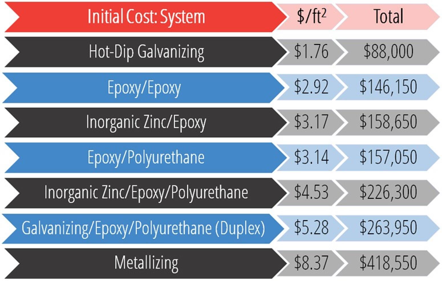

Steel Coatings Life-Cycle Cost Study Project Parameters
Let's assume we have a project that has 50,000 square feet of steel that needs to be protected from corrosion, is targeting a 70-year design life and is being erected in a moderately industrial (C3) environment. This could easily represent a small generation facility.
In this example, we are evaluating hot-dip galvanizing in comparison to several high-performance paint systems, metallizing, and a duplex system (paint over galvanizing). This analysis used the national average for hot-dip galvanizing ($0.27/lb or $2.16/ft2). All cleaning was done to SP-10 automated, other than the duplex system which was cleaned using SP-16 for HDG surfaces, and metallizing was blasted to a near white metal clean. All coats were applied in the shop, and the structures were all classified as simple for future maintenance costs.
As mentioned before, it is not recommended to analyze only the initial cost for a corrosion protection system. However, if it is the only analysis, galvanizing is still a solid choice, as it is often initially less expensive or very cost competitive with other coating systems. Keep in mind these costs are all coming from the manufacturer (paint manufacturer and/or galvanizer) and do not take into account fabricator markup which may be assigned at varying rates dependent on the material (i.e. galvanizing may be marked up more if the fabricator has his own paint facility).
As a reminder, this example uses a typical mix of structural pieces, which will typically yield an initial galvanizing cost lower than most paint systems, as the galvanizing process efficiently accommodates bundles and groups of steel. However, even if you compare medium or large structural elements, the galvanizing cost is less expensive or within a few cents per square foot of each of these systems as well. The strongly held notion galvanizing is more expensive initially is no longer accurate, as the cost of HDG has remained relatively stable while the cost of paints and other systems have increased significantly over the last 5-10 years.

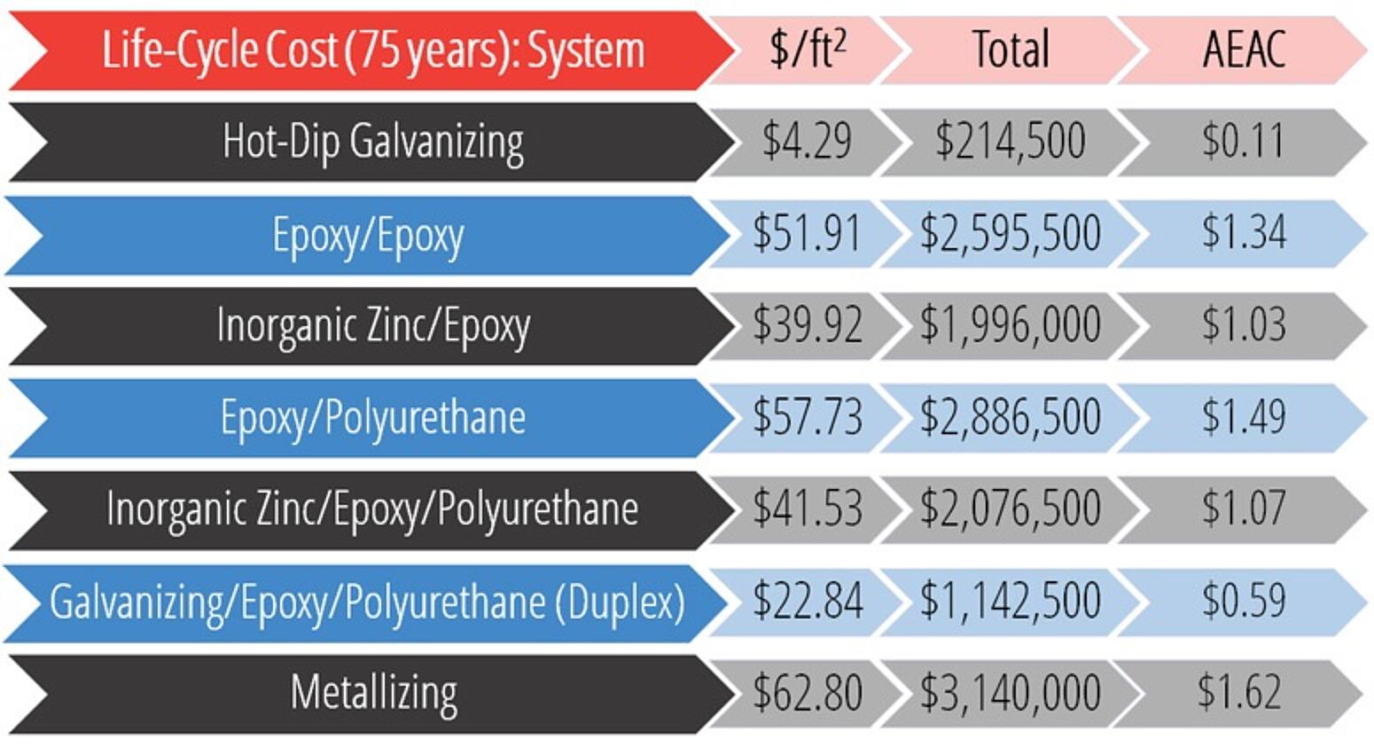

Note: Average Annual Equivalent Cost (AEAC) is per square foot (total LCC divided over years in service and size of project).
When life-cycle costs are considered, hot-dip galvanizing is the most economical system for corrosion protection. In fact, this analysis does not even include the hidden (or indirect) costs associated with touch-up, maintenance, and full repainting required for paint systems. If deviations from the practical maintenance schedule occur, life-cycle costs could be significantly higher than indicated.
After 70-years of life, the initial cost of the galvanizing is identical to the original cost as no maintenance would be required in this environment. Also, when comparing to the other coating systems, the life-cycle cost savings are significant in comparison. The second best option over the life of the project in this example is actually the duplex system of paint over galvanizing – because as mentioned before, the galvanized “primer” allows less maintenance cycles to the painted system than the same system (with IOZ primer) on bare steel.
Also, of note, often the least expensive systems initially (Epoxy/Polyurethane, Epoxy/Epoxy) are the most expensive in life-cycle cost (because they require more maintenance). Even though the metallizing system requires less maintenance, the cost to metallize (and touch up with metallizing in the field) is much higher than it is to use paint in the field.
It is also important to understand these costs are only the DIRECT costs, and do not account for the indirect costs (such as impact to businesses when a road is closed down, etc.) which are typically 5x-11x the direct costs of repair.
