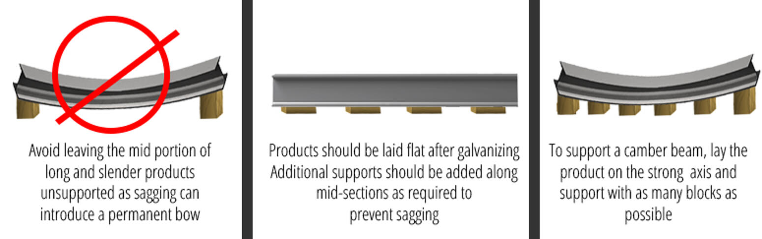

Ensure best Practices for Laydown After Galvanizing
If a hot-dip galvanized product is laid down haphazardly after removal from the galvanizing kettle, or onto supports which are too far apart, the product can sag under its own weight and permanently retain a bowed shape after cooling. To reduce or eliminate the potential for warpage/distortion due to poor laydown techniques, arrange products flat and free from external forces during the cool-down phase, and use additional supports underneath the mid-section of products to prevent sagging. To support a positive or negative camber, lay the product on the strong axis and support with as many blocks as possible.
