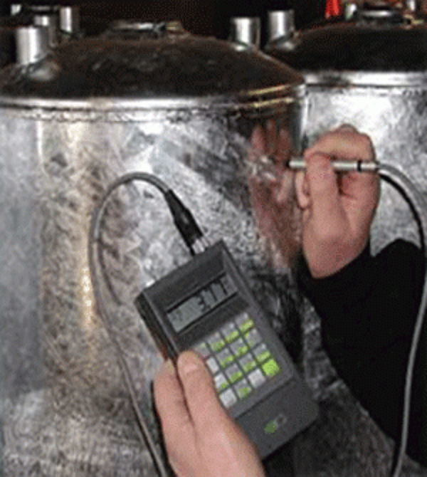

Magnetic Gauge
Sampling requirements are provided in the specs. At least five widely dispersed measurements per specimen. Average should not be less than one thickness grade lower than material category
Electronic Gauges
Electronic Gauges are the most accurate, and arguably, the easiest thickness gauge to operate. The electronic thickness gauge is operated by simply placing the magnetic probe onto the coated surface and then a digital readout displays the coating thickness. Electronic gauges have the advantage of not requiring recalibration with probe orientation, but do require calibration with shims of different thicknesses in order to verify the accuracy of the gauge at the time it is being used. These shims are measured and the gauge is calibrated according to the thickness of the shim, and then this process is repeated for shims of different thicknesses until the gauge is producing an accurate reading in all ranges of thickness. One benefit of the electronic or digital gauge is the ability to store data and perform averaging calculations which facilitates the whole process.

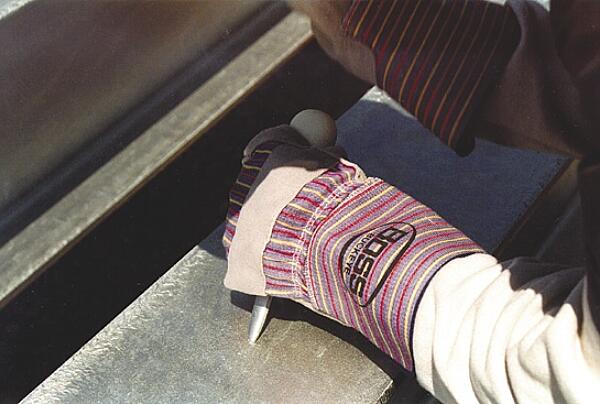

Stout Knife Test
HDG coating is metallurgically bonded to the steel at 3,600 psi. Do not perform this test on edges or corners. Run the point of the knife along the surface smoothly without gouging or whittling. In order to have a proper test, the coating must not flake.

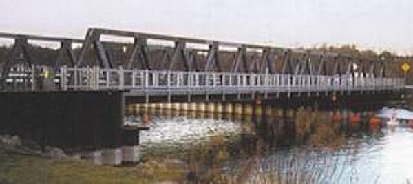

Field Inspection

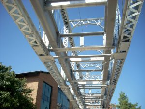

Inspection of hot-dip galvanized steel products does not end once they are accepted at the galvanizer's facility or job site. Once erected, any good corrosion protection strategy includes periodic inspection and maintenance to ensure the protective coating is performing as expected. When inspecting hot-dip galvanized steel in the field, the inspector should be aware of potential accelerated corrosion areas and aesthetic surface defects.
When inspecting a galvanized coating in the field, the number one concern is the number of years remaining before the coating will need to be touched-up or replaced. Fortunately, estimating the remaining time to first maintenance for hot-dip galvanized coatings in atmospheric exposures is relatively simple. For a ballpark estimation, use a magnetic thickness gauge to take a coating thickness measurement and check the thickness value against the AGA's Time to First Maintenance Chart.

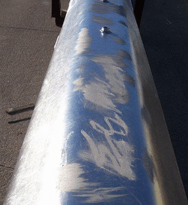

In addition to taking coating thickness measurements, the galvanized coating can be visually inspected for signs of accelerated corrosion in specific areas. Thickness measurements should be taken in these areas to ensure adequate zinc coating remains or if touch-up should be performed. Corrosion-prone areas to inspect further include:
