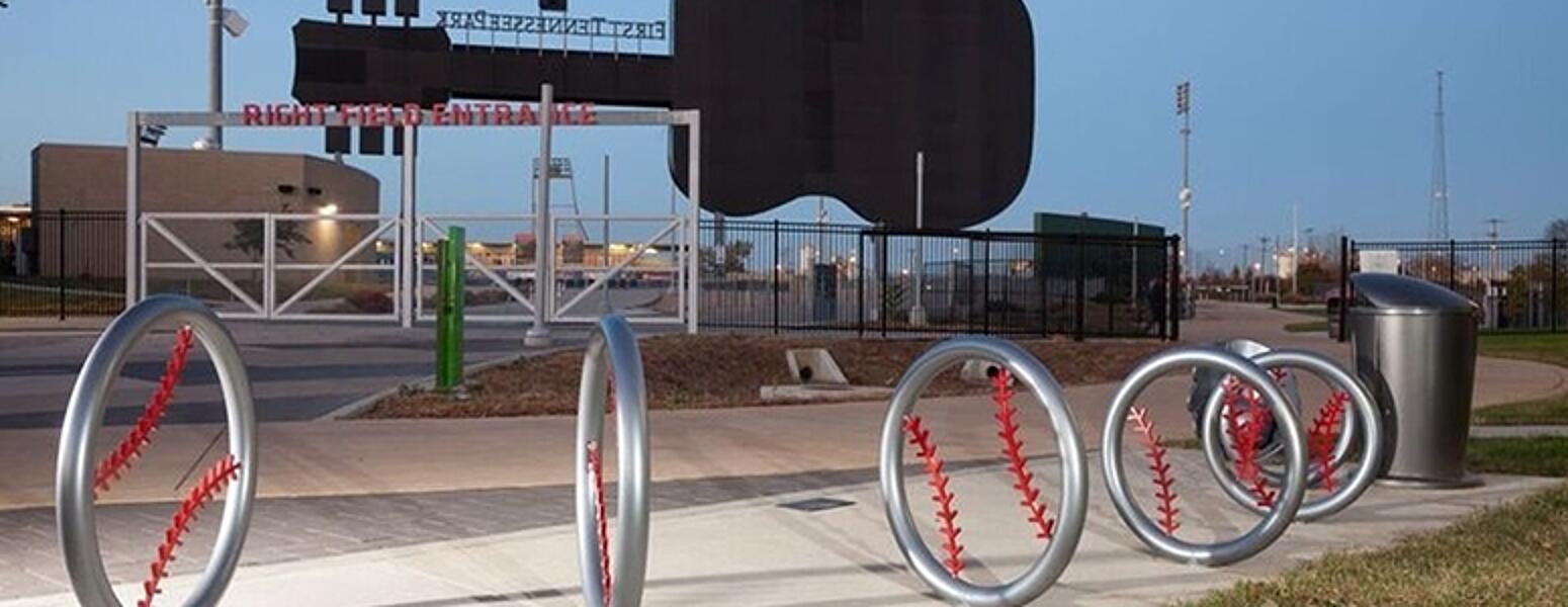

First Tennessee Park opened its doors on April 17, 2015 to a sellout crowd of 10,459 and welcomed a total of 565,548 visitors in 2015. Ground Ball is more than a bike rack it is also a public art installation. Because of its location outside of a new baseball stadium, and potential for large crowds, Ground Ball is designed to appeal to the non-cycling visitors to the ballpark as engaging public art. The fabricator and galvanizer were challenged to maintain the artists vision that incorporates movement, whimsy, and the universal appeal of baseball for people of diverse ages, languages, and backgrounds. Fabricated solely from a drawing on an 8x10 sheet, Ground Ball was a complex design.
The glove and ball were custom made using 10 gauge sheet steel with the ball fabricated in a spherical shape with stitches and seems welded to the exterior. Since the art installation has a dual purpose as a functioning bike rack, there is an increased potential for damage to the painted surface in the form of chip and scratches. To prevent rusting of the underlying steel, and discoloration of the art, resulting from chipping of the painted surfaces, the entire piece of art was hot-dip galvanized prior to painting.
The underlying galvanized steel will help maintain the original appearance of the bike rack/art piece installation for years to come. Preventing corrosion from use and time is essential to extend the life of design. As an added touch, the installation was powder coated after galvanizing to create a smooth texture as part of the artists vision. The artist kept the gray color as the top coat, so the color of the zinc would blend in as the paint chips, the color will also keep the gray theme of the surrounding building and Sounds Stadium appearance.
