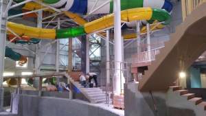

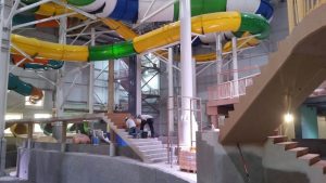

Paint
Indoor Water Park Village
After the surface of the galvanized part has been cleaned and roughened to provide a profile, the part is ready for the final step, painting. Paint can be applied by brushing or spraying onto the galvanized surface. Please follow the paint manufacturers recommendations regarding air conditions and application methods. Painting should begin as soon as possible after cleaning and profiling. There are some paint systems not compatible with zinc coatings; consult the paint manufacturer for information on paint compatibility with zinc coatings and/or refer to SSPC Guide 19.

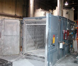

Bake
Oven for Powder Coating
After the galvanized surface has been cleaned and profiled, the part is ready for the next step, baking. This step is extremely important to prevent pinholes and blisters in the powder coating, commonly known as outgassing. Water and air molecules can be trapped in the zinc coating and must be removed through the baking process. The part should be thermally treated in an oven to remove residual moisture prior to powder application to reduce pin-holing and blistering. The temperature of the baking oven should be 30 degrees centigrade above the temperature used to cure the powder. The part should be baked  until the part reaches the oven temperature or a minimum of one hour. The part should then be cooled to a temperature that allows the powder application.
