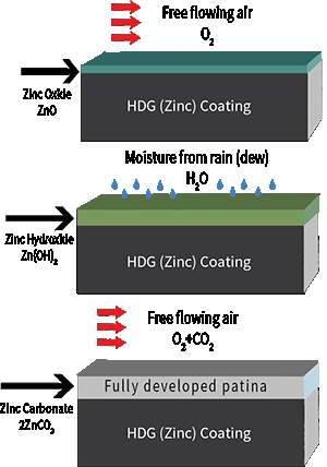

Zinc Patina Formation
The hot-dip galvanized coating is formed when the iron in the steel reacts with the zinc in the galvanizing kettle. This metallurgical reaction is a diffusion process, creating a growth of intermetallic layers perpendicular to the steel surface. Zinc, like all metals, begins to corrode when exposed to the atmosphere. As galvanized coatings are exposed to both moisture and free flowing air, corrosion by-products will naturally form on the coating surface, called the Zinc Patina. The formation of these by-products (zinc oxide, zinc hydroxide, and zinc carbonate) occurs during natural wet and dry cycles in the environment.
The rate of zinc compound formation is determined by a number of variables, including the amount of time since the part was withdrawn from the kettle, the temperature of the part, and the humidity in the atmosphere. Identifying the state of the zinc patina formation will dictate what cleaning/profiling steps are required, and what surface condition (as found in the specs) you should follow.
