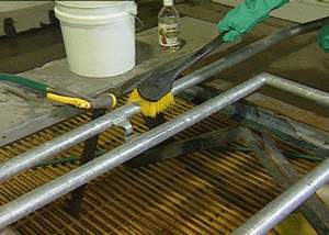

Remove Organic Contaminents
Cleaning Galvanized Steel Zinc Coating Surface With a Brush
Cleaning with brush
Once the galvanized surface is smooth, the next step for partially weathered galvanized steel involves removing all organic contaminants from its surface. Organic contaminants can be removed with an alkaline solution, acidic solution, or solvent cleaning. A mild alkaline solution, a mixture of ten parts water and one part alkaline cleaner, can remove all organics from the surface without damaging the galvanized coating. The alkaline solution can be brush applied or used with a power washer; however, if power washing the pressure must be held below 1450 psi to ensure the zinc coating is not damaged.
Organic contaminants can also be removed with a mild acidic solution, a mixture of 25 parts water to one part acid. The acidic solution will also slightly etch the zinc coating and leave the surface a dull gray color. Acidic solutions are usually brush applied and should be thoroughly rinsed off the part with fresh water no later than two to three minutes after application. It is good practice to rinse the part twice after using acidic solutions for cleaning.
Finally, solvent cleaning, applying solvents to the surface using a clean cloth, can be used. The cloth will pick up the organics, so it must be changed often to avoid re-depositing them onto he galvanized surface.
