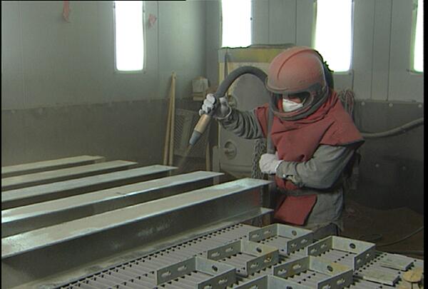

Sweep Blasting (Paint & Powder Coating)
The first method to provide a profile on the surface is to sweep or brush blast the part per SSPC SP16. Sweep blasting is preferred over standard blasting because the zinc surface is relatively soft and a standard blast would remove most of the coating. Sweep blasting is angled onto the surface at 30 to 60 degrees to remove only the zinc compounds and not the zinc metal layer. Avoid standard blasting process because it uses a 90 degree angle to the part and will remove most of the galvanized coating.
The abrasive material must be chosen with care to provide a stripping action without removing excess zinc layers. One material used successfully is aluminum/magnesium silicate. Particle size should be in the range of 200 to 500 micrometers. Other potential materials are soft mineral sands with a Mohs hardness of five or less, or organic media such as corn cobs or walnut shells, or stone materials such as corundum or limestone. Do not use any blasting material with iron in the blast media, as this will cause powder coating adhesion issues and contaminate the galvanized coating.
Sweep blasting of zinc should not be greater than 40 PSI while using these abrasive materials. The substrate should be maintained at a temperature greater than three degrees centigrade above the dew point temperature. If the blasting step removes too much zinc coating, the zinc may be repaired by the process described in ASTM A 780.

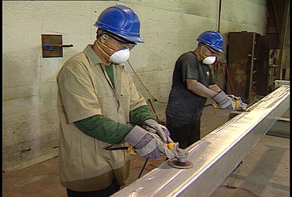

Surface Grinding (Paint & Powder Coating)
If necessary, power tools such as grinders or sanders can be used to roughen the surface of the galvanized steel to produce a surface profile suitable for paint or powder application and adhesion. A removal of up to 1 mil is acceptable, but the grinder should not be applied with enough force to completely strip the zinc coating. Afterwards, the surface should be blown off with compressed air. In some atmospheric conditions, such as high humidity, temperature, etc., the formation of zinc oxide on the surface will being very quickly, so the paint/powder coating should be applied immediately. Zinc oxide formation is not visible to the unaided eye; therefore, in any atmosphere, painting/powder coating should be started as soon as possible after surface preparation.
