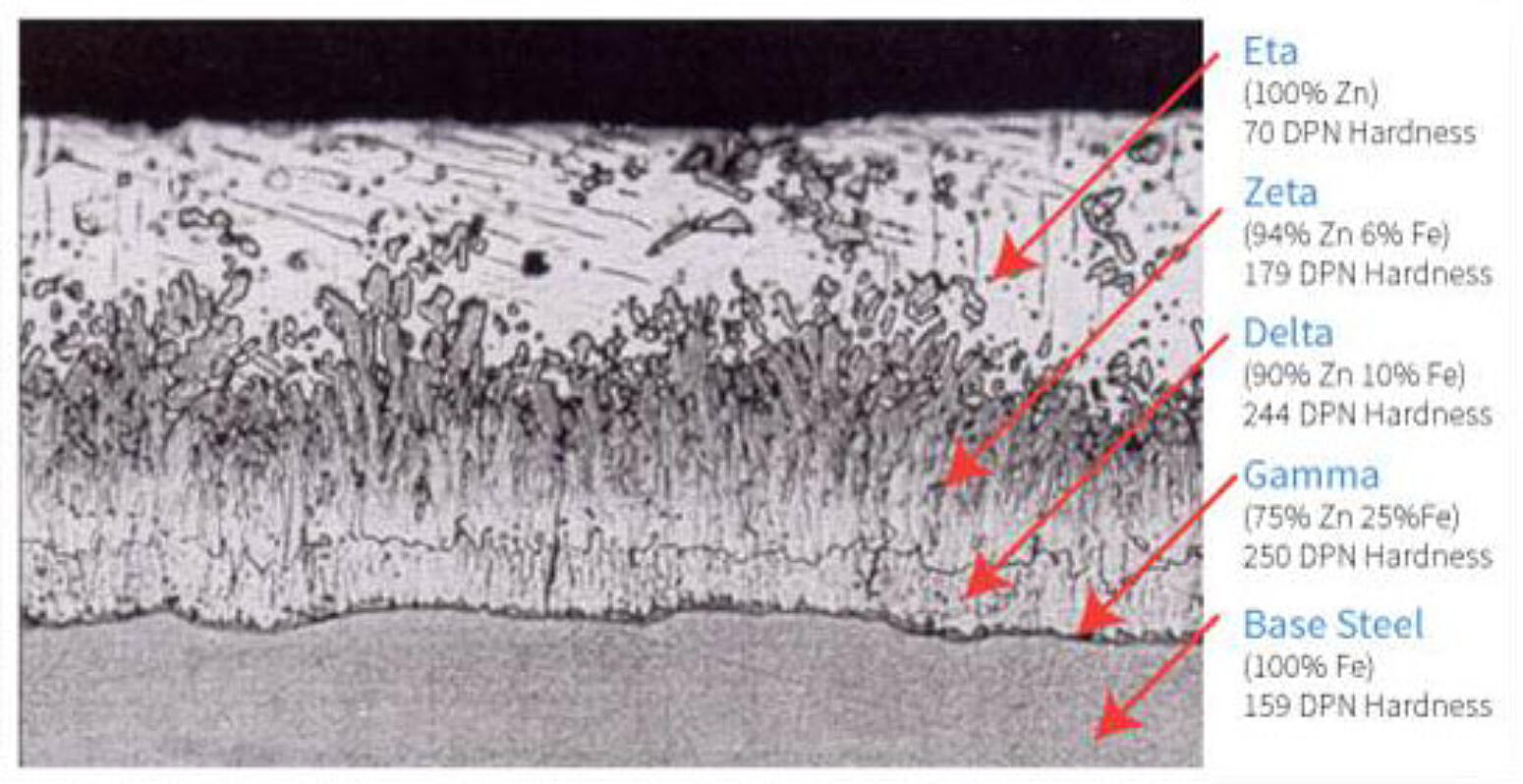

Another aspect of hot-dip galvanizing is proven, unmatched durability, even in harsh conditions. This is in part thanks to the galvanized coating's abrasion resistance, uniform protection and complete coverage. The intermetallic layers formed in the galvanizing kettle are metallurgically-bonded to and harder than the base steel, while the top, pure zinc layer is more ductile and able to absorb impact. Together these layers of the zinc coating provide unparalleled abrasion resistance.

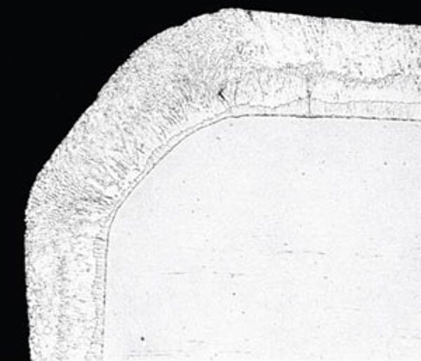

Hot-dip galvanizing also provides uniform protection and complete coverage. The zinc coating grows perpendicular to the steel, so corners and edges have the same thickness as flat surfaces. Furthermore, the total immersion process ensures hollow and tubular structures are coated and protected, inside and out. This complete, uniform coverage means there are no easy targets for corrosion to attack.
