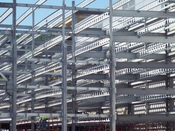

Not only does a smaller, stronger steel framing system support more design options in the conceptual and construction stages, it also sets the stage for future growth or adaptation. A lean, sturdy steel frame is the ideal setup for expansion.
As the American Institute of Steel Construction (AISC) states in Open Deck Parking Structures, vertical expansion can be easily accomplished in a steel-framed structure through the splicing of existing columns and the placement of steel members with readily available cranes.1 The most flexible option for vertical development, additional steel framing will couple easily with the original design to support the weight of new parking tiers.
Additionally, expansion of a steel frame will have less impact on the day-to-day functionality of the garage. Often times, only the top-most parking tier needs to be taken out of commission to facilitate the upward growth of the structure. With procedures that will not take the entire garage out of commission for updating or expansion, a hot-dip galvanized steel frame will unlock new possibilities for the future.
