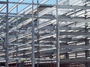

Sands Casino Garage
As the American Institute of Steel Construction (AISC) states in Open Deck Parking Structures, vertical expansion can be easily accomplished in a steel-framed structure through the splicing of existing columns and the placement of steel members with readily available cranes.1 The most flexible option for vertical development, additional steel framing will couple easily with the original design to support the weight of new parking tiers.
Additionally, expansion of a steel frame will have less impact on the day-to-day functionality of the garage. Often times, only the top-most parking tier needs to be taken out of commission to facilitate the upward growth of the structure. With procedures that will not take the entire garage out of commission for updating or expansion, a hot-dip galvanized steel frame will unlock new possibilities for the future.
Featured in Modern Steel Construction, the West Virginia University Medical School Garage was in desperate need of expansion. With real estate at a premium and the demand for parking growing quickly, it was essential for the hospital to maximize the capacity of its existing parking garage.3  Engineers incorporated a steel framing retrofit system to accommodate vertical expansion for the structure. The garage was able to maintain functionality through the entire process, and is now more spacious than ever.

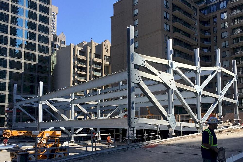

Charles/Hayden Parking Garage Expansion, Toronto, ON Canada, 2016
Charles Hayden Parking Garage Expansion 02
The ever growing metropolis of Toronto never seems to have enough parking so the Toronto Parking Authority is always looking for ways to increase capacity to insure sufficient parking in all areas to insure continued success of commerce and the well-being of citizens.  The decision was made to expand the Charles Hayden Parking garage by two additional stories.
Situated next door to the busiest subway station in all of Canada they knew every extra spot would be quickly filled but this location presented a challenge for expansion because the garage actually straddles a subway line that passes directly under the existing structure.  To prevent the risk of damage to the subway tubes a strict weight limit was imposed on the project by Transit Authority engineers.  Fortunately the light weight of steel compared to concrete structure made this badly needed expansion possible.  Light, strong and durable galvanized steel also can be erected much faster than concrete structures minimizing cost and lost parking revenues.  And the zinc will protect the steel against the corrosive road salts and high humidity the garage is exposed to several months a year.
This quickly completed expansion added 210 additional parking spaces to the 450 original spaces while meeting the weight limitations.  In other words versatile steel made it possible and fast while hot-dip galvanizing will make it last and last.
