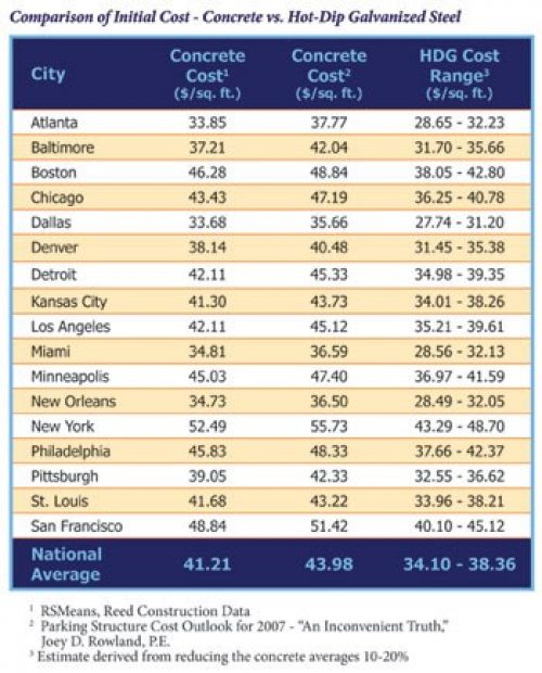

Because steel beams are considerably lighter than heavy, unwieldy precast concrete elements, transportation costs are significantly less as well. Less tonnage loaded onto trucks, train cars, or barges translates into a smaller transportation price tag. Once delivered, lightweight building materials will reduce onsite crane requirements - no special maneuvering equipment required. Additionally, less weight often means fewer and smaller diameter caissons are required. With all of these savings combined, steel-framed systems can typically be constructed with a cost savings of 10 - 20% over a concrete alternative.1 Figure 5 is a comparison of initial costs for both concrete and hot-dip galvanized steel construction applications.
1 American Institute of Steel Construction (AISC). Innovative Solutions in Steel: Open-Deck Parking Structures. 2003.
