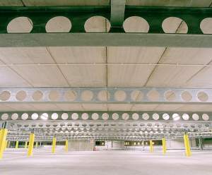

To create a feeling of safety in the garage, long-span castellated beams and slim vertical supports engender a sense of openness, allowing light to penetrate and encouraging air flow and circulation. Lighting is critical to the success of any parking structure, affecting visibility, safety, and patron comfort.
Eliminating the need for heavy shear walls means more natural light will flood the garage floors- the need for buzzing, glaring fluorescent lighting will be greatly reduced. Better lighting throughout the structure means an easier, safer drive for vehicles, preventing shadowy regions from inhibiting sight while driving.
In this case, safer for cars means safer for pedestrians. With greater visibility, patrons walking to their cars will be obvious no surprises around the corner. Fewer shadow areas also mean nowhere to hide for shady characters. Visitors can travel throughout the open, well-lit structure with confidence.
Beyond safety and aesthetics, the openness generated from utilizing galvanized castellated steel beams serves to increase air circulation. Open-deck parking structures do not require the use of mechanical ventilation systems, as fresh gusts and breezes work naturally to keep the air fresh and moving. Compare this to the dank, tinny air of an enclosed concrete garage, and steel framing is a significantly more appealing option.
