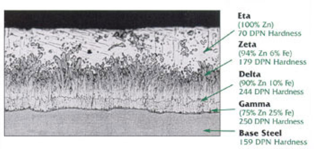

After surface preparation, the steel is dipped in the molten (830 F) bath of at least 98% zinc. The steel is lowered into the kettle at an angle that allows air to escape from tubular shapes or other pockets, and the zinc to flow into, over, and through the entire piece. While immersed in the kettle, the iron in the steel metallurgically reacts with the zinc to form a series of zinc-iron intermetallic layers and an outer layer of pure zinc.

![Metallurgically bonded, abrasion resistant intermetallic layers](/uploads/default/_1000xAUTO_crop_center-center_75_none/alloylayers.jpg)

The tightly adhered coating, which has bond strength of around 3,600 psi, is also extremely abrasion-resistant, as the intermetallic layers are harder than the base steel (Figure 2). However, even if the coating is damaged, zincs sacrificial action will protect exposed steel up to ¼ inch away.

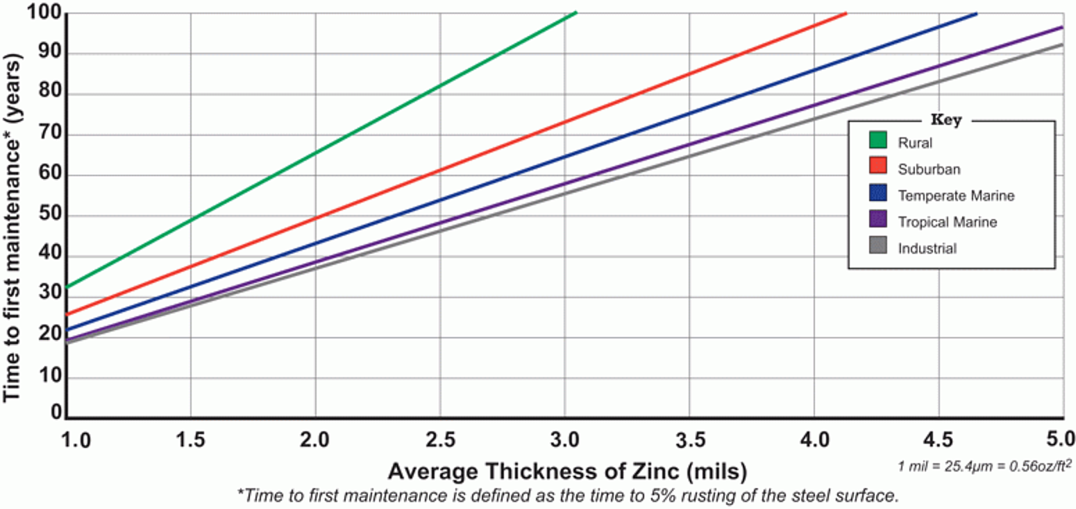

Finally, the zinc coating naturally develops an impervious layer of corrosion products on the surface, know as the zinc patina. The patina, cathodic protection, complete coverage and all of these other features, provide hot-dip galvanized steel with a long, maintenance-free service life. Thjavascript:void(null);e time to first maintenance for hot-dip galvanized steel can be seen in Figure 3.
![Time To First Maintenance Chart](/uploads/default/_1550xAUTO_crop_center-center_75_none/Time-to-First-Maintenance-Chart.png)
