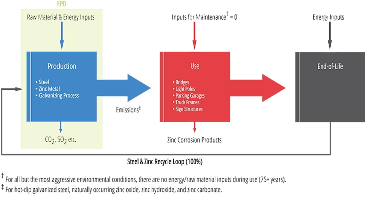

To make a case for the sustainability of hot-dip galvanized steel, it is helpful to examine data produced when a life-cycle assessment (LCA) of a structure is conducted. Life-cycle assessment often called a "cradle-to-grave" study, is the study of the environmental impact of a process or product, and includes measurement of energy consumed and all emissions during raw material production and manufacturing of the final product through use and end-of-life (recycling/disposal).
The AGA has worked with renowned sustainability practitioners Sphera to develop an industry-wide Environmental Production Declaration (EPD). The EPD tracks energy consumption and emissions during steel making and fabrication, zinc production and the galvanizing process. An EPD is equivalent to the production phase of a full life-cycle assessment (LCA) which AGA last had done by Five Winds in 2008. This chart shows an overview of the impact of hot-dip galvanized steel from production to end-of-life.
                                                                                        Production Phase
Long before galvanized steel is pieced together to form a parking structure frame, production begins on the steel and zinc metals. To begin, more than 95% of structural steel manufactured in the United States is fully recycled from previously used steel materials, making the initial environmental impact of using a steel frame minimal. By specifying a hot-dip galvanized zinc coating for corrosion protection, you are choosing to utilize yet another abundant, recyclable, natural metal to further the cause of sustainability, as well as protect your parking structure.1
The production phase for HDG includes the life-cycle inventories of steel, zinc, and the galvanizing process. All emissions, energy, and material usage for hot-dip galvanized steel are isolated to the production phase. As delineated in greater detail in the figure below, the initial environmental cost is the final environmental cost, because there are no environmental outputs in the use or end-of-life phases.
