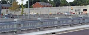

An often-overlooked sustainable aspect of hot-dip galvanized steel is the ability to reuse it. Hot-dip galvanizing provides maintenance-free corrosion protection for 70+ years in atmospheric environments. Often that is longer than the design life of the project. In that instance, it is possible to take the galvanized steel from one demolition site and repurpose it for use in a new site. There are a number of companies who specialize in reclaiming items from demolition sites to resell to new construction.
On the other hand, some projects reuse galvanized steel for the same purpose over and over by taking it down, stripping the remaining zinc off and re-dipping the steel to reinstall in the project. This also saves environmental impact and costs. It is a common practice with guardrail in many states.

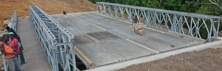

Riviere Cochon Gras Bridge: Perches, Haiti; 2019
![Riviere Cochon1](/uploads/seminars/_1550xAUTO_crop_center-center_75_none/RiviereCochon1.jpg)
There’s an old saying, “one person’s trash is another person’s treasure.” In the case of the Riviere Cochon Gras Bridge, that saying became reality. An 80-foot section of the temporary Fore River Bridge which carried people over the river between North Weymouth and Quincy Point, Massachusetts for 15 years, was reused to help the community of Perches, Haiti.
Perches is a remote community in Haiti near the Riviere Cochon Gras. The river crossing was prone to regular flooding and there was no bridge in place. When the river flooded, residents were restricted from medical care and local services, and there had even been a few cases of drownings over the year as people attempted to cross the river to get into town.
Hot-dip galvanizing was the only coating able to stand the test of time serving 15 years as the Fore River Bridge in Massachusetts only to be disassembled, shipped halfway around the world, and then reused in Haiti with no signs of corrosion or repair required. Hot-dip galvanized steel’s durability and maintenance-free longevity make the possibilities for other projects like this endless. Plain and simple, this project is a win-win.
