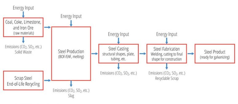

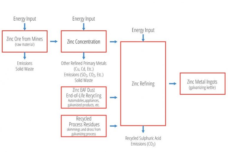

The EPD is a cradle-to-gate study representing the raw materials supply (A1), transport (A2), and manufacturing stages of hot-dip galvanized steel (A3), as well as the benefits associated with the recovery of zinc scrap during the galvanizing process (D). The raw material stage (A1) accounts for raw material acquisition of both the steel and the zinc, as well as steel making and fabrication and zinc concentration and refining.

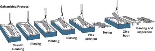

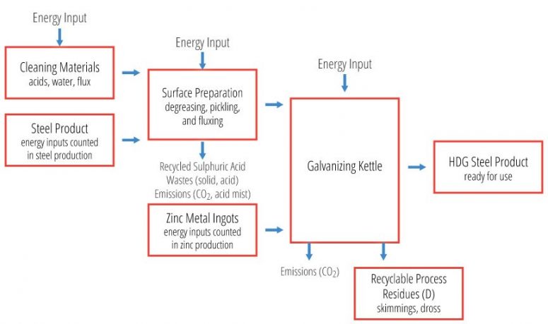

The manufacturing stage (A3) accounts for the application of the zinc metal to the steel through the hot-dip galvanizing process. The credit (D) only accounts for recycling during the production of the hot-dip galvanized coating (zinc dross and skimmings), and not for the full recyclability of the hot-dip galvanized steel product at the end of life.
