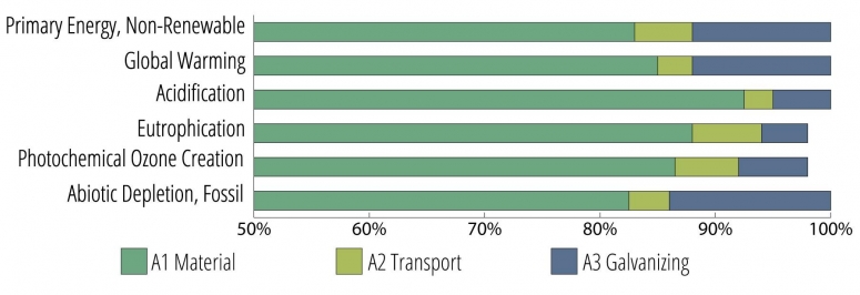

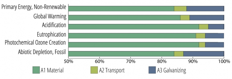

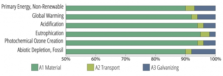

The AGA published three different EPDs, one for hot-rolled structural sections, plate, and hollow structural sections (HSS). All three used the same data for A2, A3 (galvanizing), and D (recycling credit), as the raw material and energy input and emission outputs are an average of applying the galvanized coating. The only differences in the products is from A1, as the steel making and fabrication requirements vary for each type of steel.

Looking at all three products input and output flows using the US EPAs TRACI 2.1 methodology, the EPD shows the overall impact of the galvanizing process is minimal in comparison to the raw materials supply. In each of the three products, the hot-dip galvanized coating application accounts for no more than 15% of the total energy or impact, and in the case of HSS, the HDG is no more than 10%. To view the full EPD, please visit galvanizeit.org/epd.
