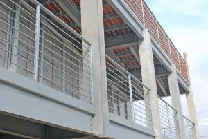

Case Study 1: Balcony Structure
The following parameters were used in the LCC comparison for the balcony structures:
- 60-year service life
- C3 Medium Corrosion environment
- Light structural pieces: 1.05 tons (420 ft2)
- Surface Prep: SP 10 automated
- Primer: Inorganic Zinc, in shop spray application
- Intermediate: Epoxy, shop spray application
- Topcoat: Polyurethane, shop spray application
- 3% inflation, 2% interest
The initial and life-cycle costs for the paint and galvanizing are shown below:
Coating System | Initial Cost | Life-Cycle Cost | AEACa | ||
Per ft2 | Total | Per ft2 | Total | Per ft2 | |
Hot-Dip Galvanizing | $1.10 | $ 462 | $ 1.10 | $ 462 | $0.05 |
IOZ/Epoxy/Polyurethane | $4.69 | $1,972 | $28.62 | $12,020 | $0.83 |
aAverage Equivalent Cost per ft2 |
Even for the relatively small amount of steel utilized in the balcony, the hot-dip galvanized balcony reduces the total cost over the life of the structure by 96%. The costs represented here may not seem like much, but the difference between the costs of the coatings is clear. Consider if you were developing a multi-family residential building, and were planning to install 100 identical balconies. Which coating would you choose?

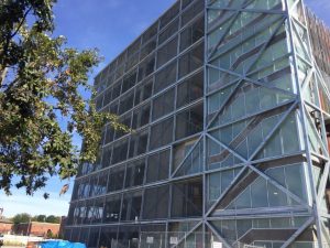

Case Study 2: Parking Garage
The parking garage LCC comparison was based on the following parameters:
- C3 Medium corrosion environment
- Typical mix size/shapes: 3,000 tons steel (750,000 ft2)
- Surface Prep: SP-10 automated
- Primer: Inorganic Zinc, shop spray application
Coating System | Initial Cost | Life-Cycle Cost | AEACa | |||
Per ft2 | Total | Per ft2 | Total | Per ft2 | ||
Hot-Dip Galvanizing | $1.76 | $1,320,000 | $ 1.76 | $ 1,320,000 | $0.05 | |
IOZ/Epoxy/Polyurethane | $3.82 | $2,881,250 | $23.26 | $17,445,000 | $0.68 | |
aAverage Equivalent Annual Cost per ft2 |
Although the same paint system applied to the parking garage costs slightly less than for the balcony, it is still initially more expensive than the hot-dip galvanized structure. Initially, the hot-dip galvanized parking structure provides a 54% savings over paint. However, when the life-cycle costs are considered, hot-dip galvanizing provides a 92% savings over the painted garage.
