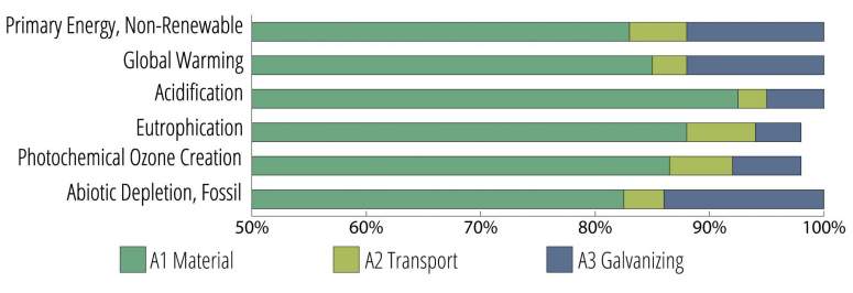

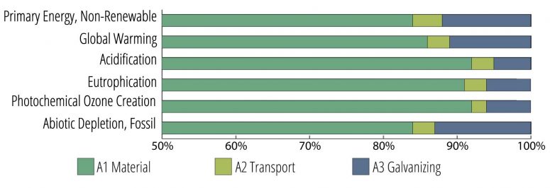

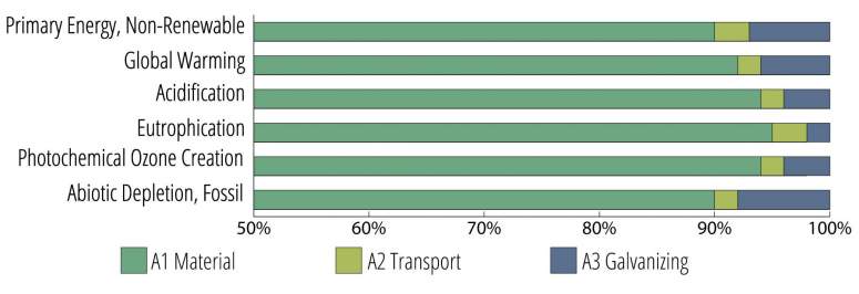

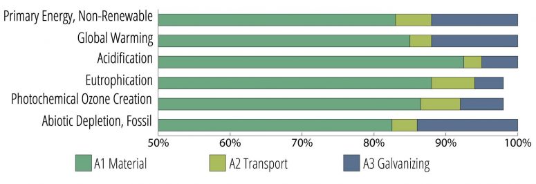

Each of the three products studied: hot-rolled structural sections, plate, and hollow structural sections (HSS), used the same data for A2, A3, and D as the raw material and energy input and emission outputs are virtually identical. However, the A1 data does change for each product, based on the steel making and fabrication requirements.

Looking at all three products input and output flows using the US EPAs TRACI 2.1 methodology, the EPD shows the overall impact of the galvanizing process is minimal in comparison to the raw materials supply. In each of the three products, the hot-dip galvanized coating application accounts for no more than 15% of the total energy or impact, and in the case of HSS, the HDG is no more than 10%. To view the full EPD, please visit galvanizeit.org/epd.
