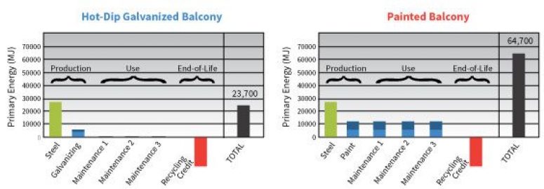

The environmental impact criteria examined were: primary energy demand (PED), global warming potential (GWP), acidification potential (AP), and photochemical ozone creation potential (POCP).  The results show the durability of the coating plays a huge role in the overall environmental impact.  The three maintenance-cycles required for the painted balcony account for almost half of the energy requirement for the painted structure, while the galvanized balcony required no additional material or energy inputs.   The following graphs illustrate the total PED of each phase of the LCA, the percentage of the PED consumed by the coating, and the GWP, AP, and POCP values.
Total primary energy demand
The graphs above show the total primary energy demand (PED) for the hot-dip galvanized balcony is 23,700 MJ (30.5 MJ/kg), or just 37% of the 64,700 MJ (83.2 MJ kg) required for the painted balcony.  Keep in mind, if the painted balcony is left in service for even one more year, an additional maintenance-cycle would be required and more energy demand and emissions would be added to the values shown, while the galvanized balcony will remain untouched

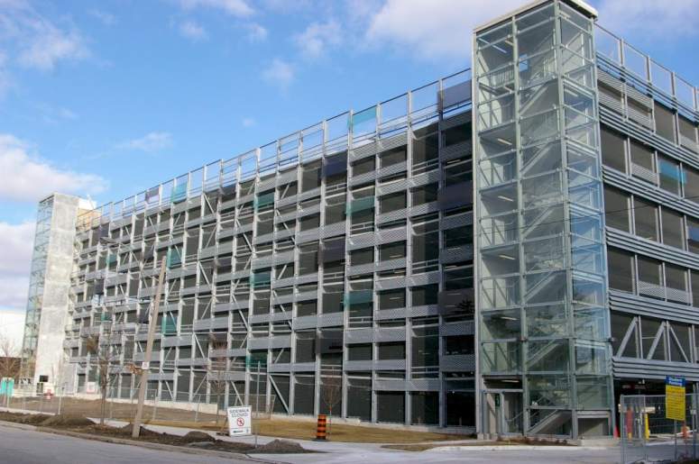

Parking Garage
The Institute for Environmental Protection Technology at the Technical University of Berlin conducted life-cycle assessments (LCAs) comparing a hot-dip galvanized parking structure to a painted one4.  Similar to the VTT Technical Research study, the Technical University of Berlin strived to determine the environmental impact of hot-dip galvanizing as well as establish a benchmark for future improvements.   The results of the study demonstrate once again the significant impact the coating plays in the overall environmental impact of the parking garage.
University of Windsor Parking Structure
The following parameters were used in the parking structure study:
  • 60-year service life
  • 1 m2 steel part (20m2/metric tons
  • Galvanized coating corrosion rate of 1 micron per year (ISO 1461, C3 environment)
    • No HDG Maintenance Required
  • Paint system: 3-coat system, 240 microns thick
    • Paint Maintenance: years 20 and 40 (ISO 12944)
Life cycle analysis for Parking Garage
This study also examines the PED, GWP, AP, and POCP values for each system.  The results for each impact area are much less for the hot-dip galvanized garage than for the painted one.  Similar to the painted balcony, the two maintenance cycles required for the painted garage significantly increase the resource and energy consumption of the painted garage.  As galvanizing requires no maintenance during the 60-year life, the total energy and resource consumption for the galvanized structure is only 32% of that required for the painted garage, where the GWP is 38% of paint.  Furthermore, the AP is 15% less than paint, and the POCP 33% less.
