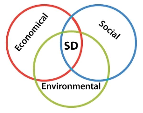

Sustainable development (SD) is the social, economic, and environmental commitment to growth and development that meet the needs of the present without compromising the ability of future generations to meet their needs. Creating a more sustainable community, nation, and world is pertinent, and developers of the built environment (architects, engineers, material suppliers, etc.) shoulder a large part of the responsibility to protect the interests of present and future generations.
