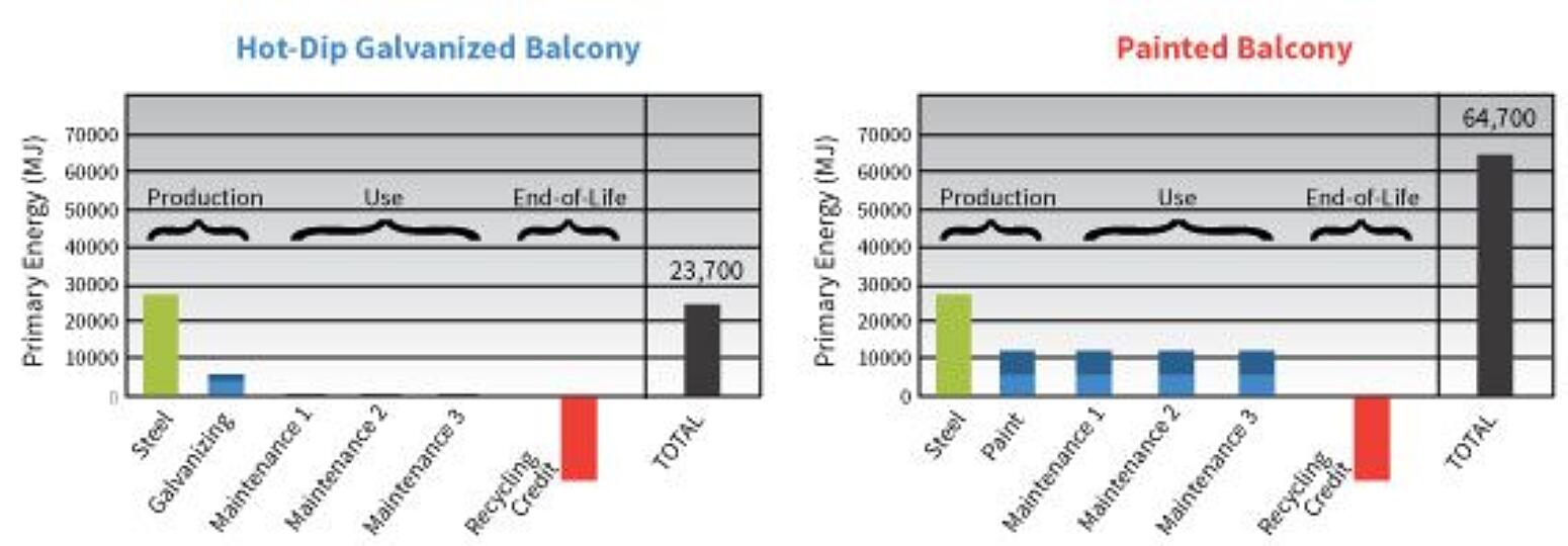

The environmental impact criteria examined were: primary energy demand (PED), global warming potential (GWP), acidification potential (AP), and photochemical ozone creation potential (POCP). The results show the durability of the coating plays a huge role in the overall environmental impact. The three maintenance-cycles required for the painted balcony account for almost half of the energy requirement for the painted structure, while the galvanized balcony required no additional material or energy inputs. The following graphs illustrate the total PED of each phase of the LCA, the percentage of the PED consumed by the coating, and the GWP, AP, and POCP values.
![Total primary energy demand](/uploads/default/_1550xAUTO_crop_center-center_75_none/HDG_Paint_Balconies.jpg)
The graphs above show the total primary energy demand (PED) for the hot-dip galvanized balcony is 23,700 MJ (30.5 MJ/kg), or just 37% of the 64,700 MJ (83.2 MJ kg) required for the painted balcony. Keep in mind, if the painted balcony is left in service for even one more year, an additional maintenance-cycle would be required and more energy demand and emissions would be added to the values shown, while the galvanized balcony will remain untouched
