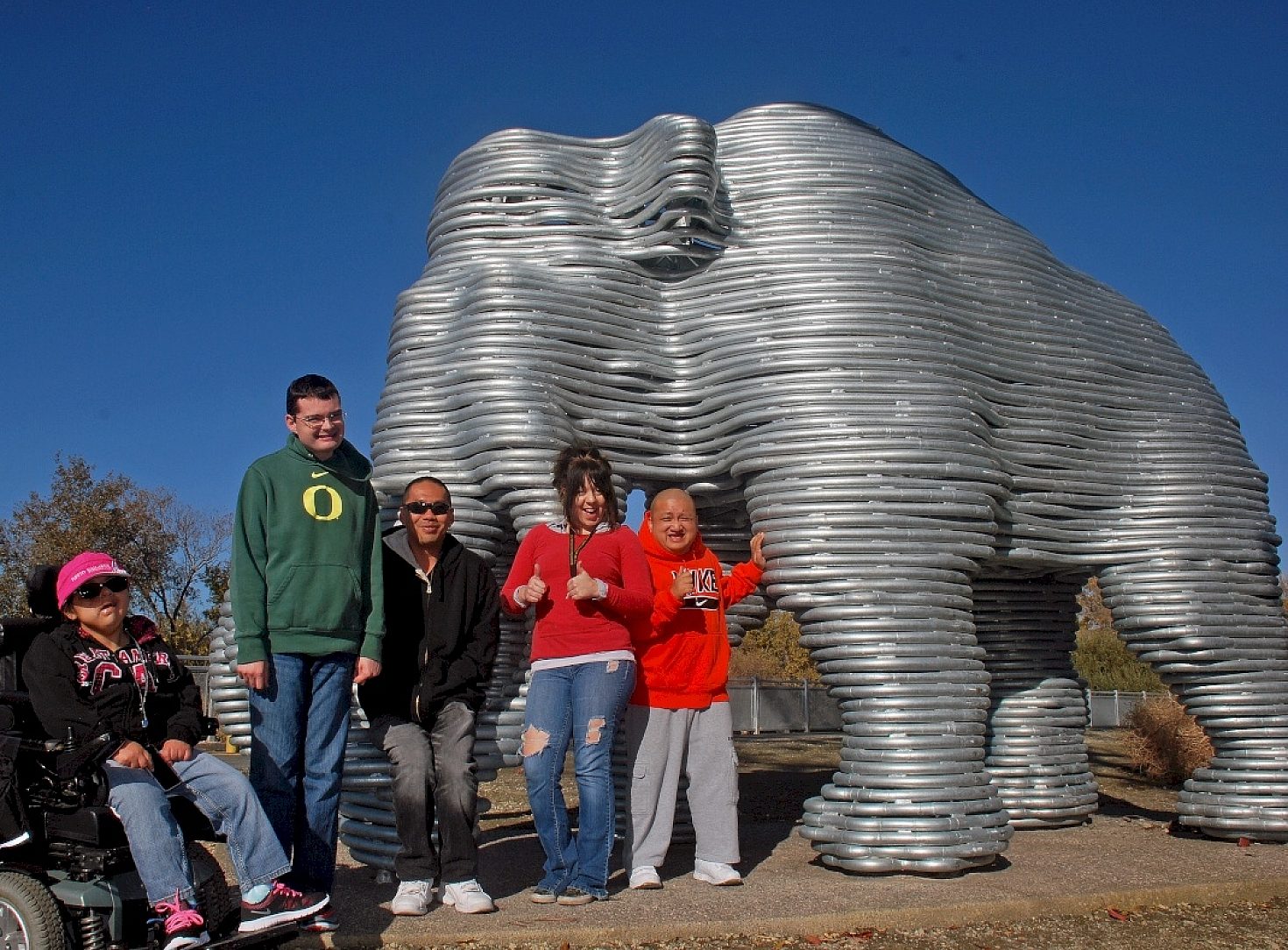

Galvanizing the mammoth was an absolute necessity to protect the steel from corrosion because of the locations harsh temperate marine climate. Not only was the hot-dip galvanizers contribution to this project extensive, but also crucial. The galvanizers involvement started during the initial design concept stage with detailed instruction on the proper placement of vent and drain holes, which were critical due to the continuous roll-formed pipe design with multiple peaks and valleys in each pipe layer.
The massive metal mammoth, each foot big enough to cover the top of a washing machine, was disassembled into four sections to accommodate the galvanizing kettle. More than 1,000 individual holes were drilled into the material to ensure a safe and successful galvanizing process. After galvanizing, the mammoth was re-assembled and loaded onto a custom low-boy trailer, and shipped on a long 400 mile journey north to its installation site in Silicon Valley. Upon delivery, the city council orchestrated a parade through downtown San Jose to celebrate the arrival of Lupe Grande to the permanent site in honor of the most significant archeological discovery ever in Santa Clara County.
