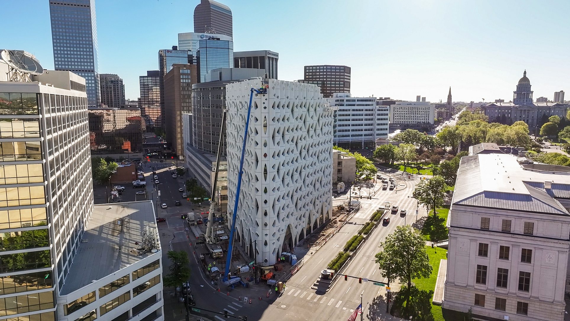

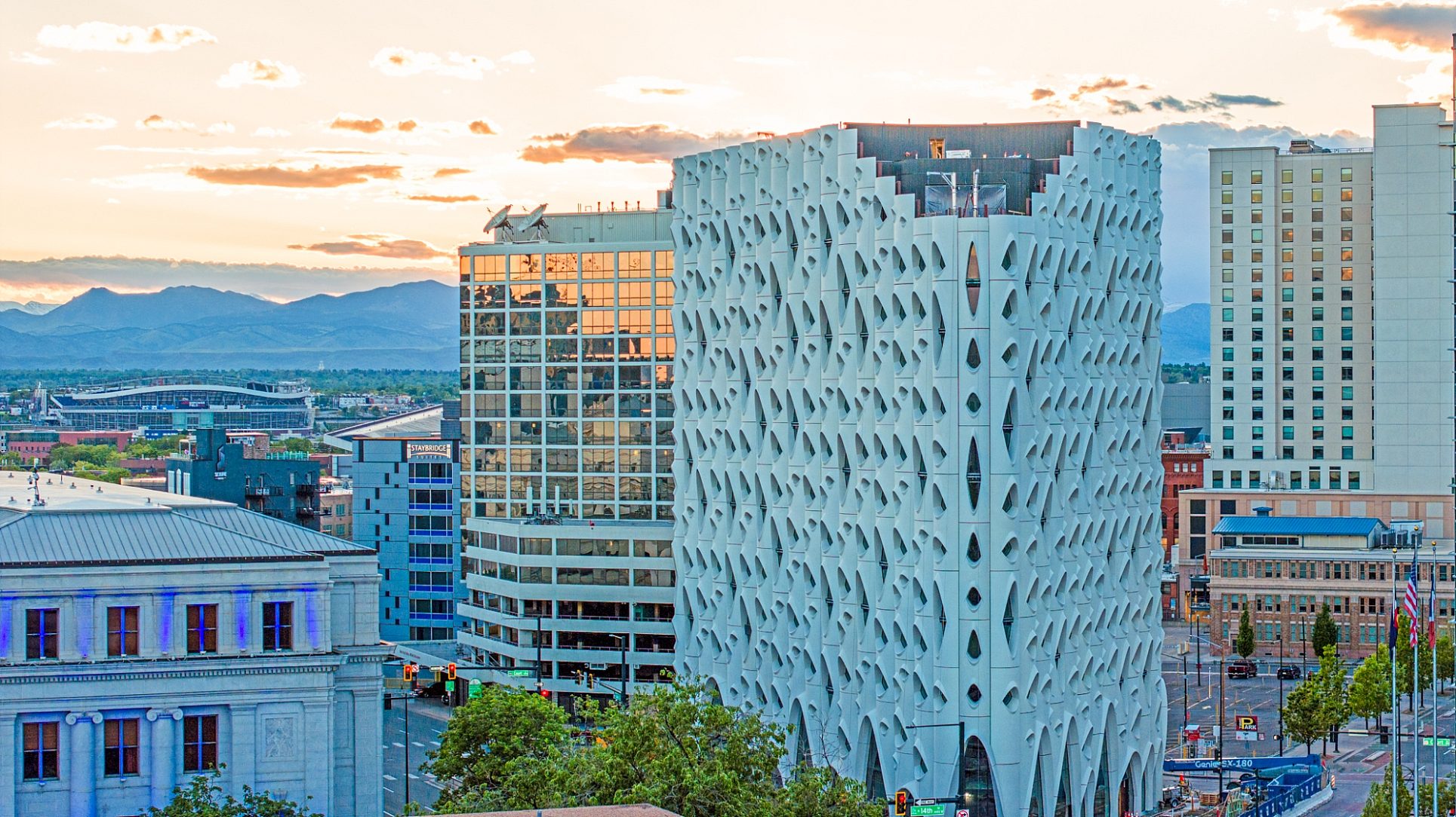

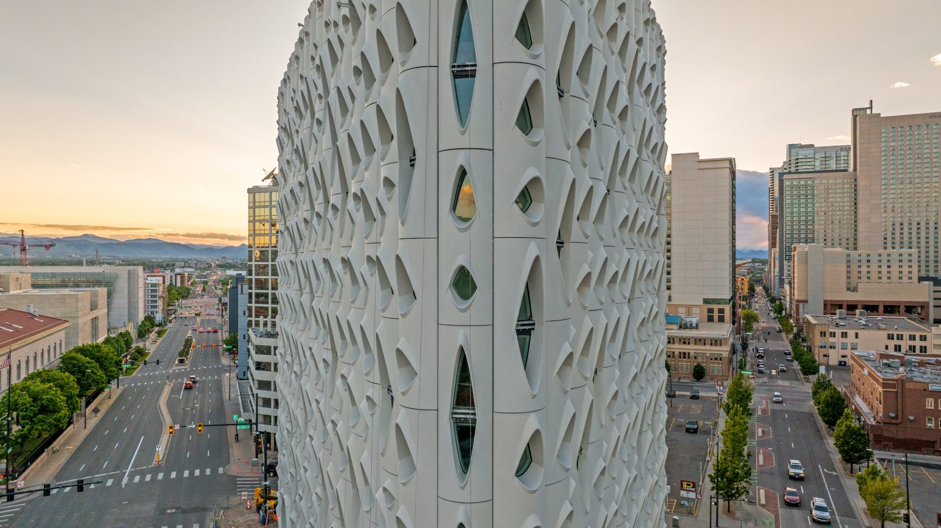

On the corner of 14th and Court Street in downtown Denver, a striking new hotel has emerged, capturing the attention of urban pedestrians with its innovative design. Drawing inspiration from Colorado's iconic aspen trees, the building’s unique façade is only part of the story. Beneath its striking exterior lies a model of smart engineering and long-term durability, thanks to the decision to use hot-dip galvanizing—a choice that ensured both performance and sustainability.

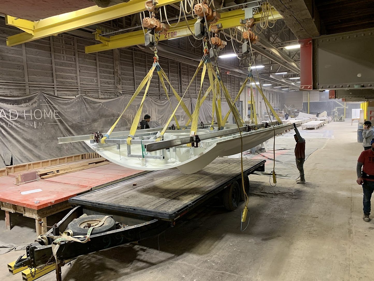

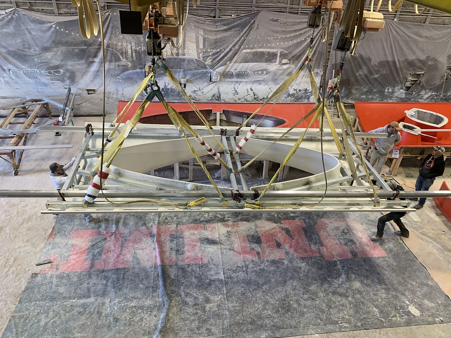

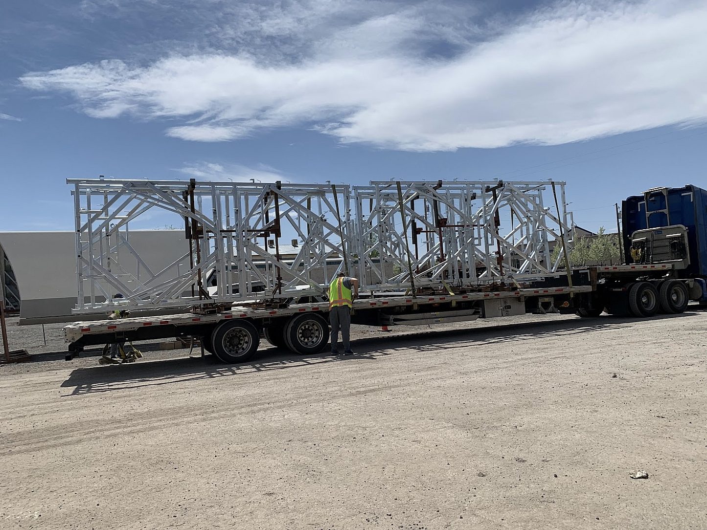

From the outset, the galvanizer worked closely with the fabricator to ensure high quality and on-time delivery. The project presented some challenges, particularly with the large, intricately shaped steel frames that required progressive dipping to ensure full coverage. This meticulous process guaranteed that every surface and crevice received a uniform protective coating. Drawing on their extensive experience, the galvanizer provided invaluable advice, such as attaching flex anchors (the parts securing the steel within the concrete) after galvanizing, which made handling and transporting the frames smoother and helped prevent damage during transit. The galvanizer also met the tight project deadlines with expedited services, ensuring the project stayed on track.

The integral steel frame cast into the Glass Fiber Reinforced Concrete (GFRC) panels were hot-dip galvanized.
Steel: 225
HDG: 225
