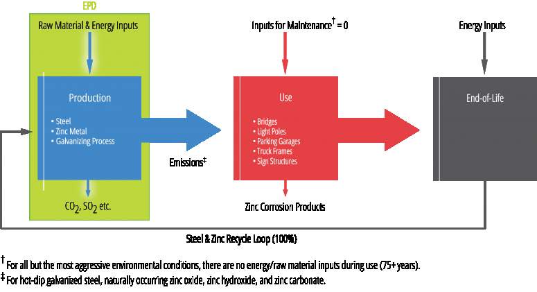

To that end, LEED v4 calls for Environmental Production Declarations (EPDs), which are cradle-to-gate studies of the impact of producing a particular material. In other words, they only account for the impact of raw material acquisition and initial production (manufacturing). To get an idea of the full environmental impact of a material, it is best to conduct a full Life-Cycle Analysis (LCA); which is a cradle-to-grave study that takes into account not only raw material acquisition and initial production, but also all of the impact during construction, use, and end-of-life management.
This is an overview of the LCA of hot-dip galvanized steel. The green shaded area shows what an EPD, as required by LEED v4, covers. As you can tell, this is only one small part of the whole story of a material’s impact. In the case of hot-dip galvanizing, which does not require maintenance for 70 years or more in most environments, the EPD is a good representation for the total impact. However, this is not true for most materials (i.e. those that require continual maintenance). Thus, for true sustainable development, which by definition is about future generations, it is paramount to consider the full LCA of a material.
Hot-dip galvanizing is unique in that all material and energy inputs and emission outputs are isolated to the production phase, as there is no maintenance required for 70 years or more in most environments, and it is 100% recyclable at the end-of-life. The AGA’s publication Hot-Dip Galvanizing for Sustainable Design has more information on galvanized steel’s sustainability, including the full LCA study.

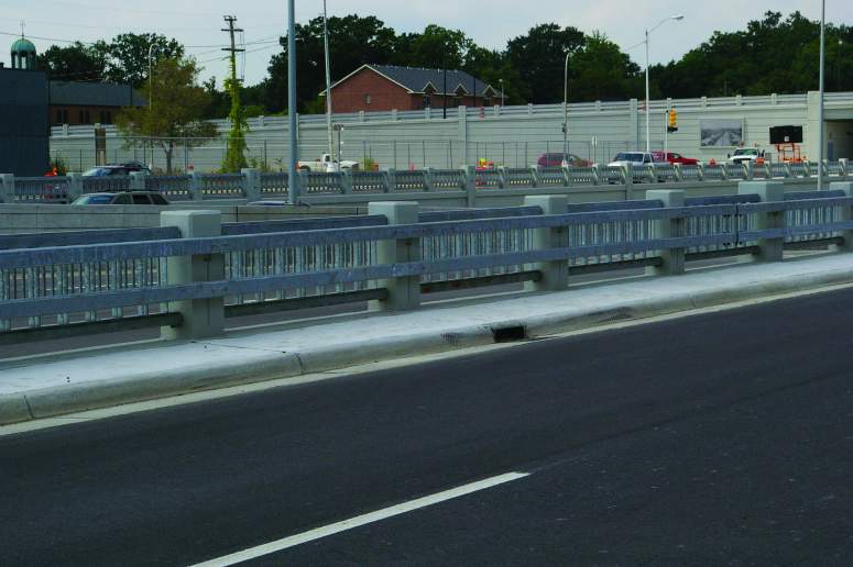

Michigan M-102 Bridge Rail - Detroit, MI 2007
With the original steel guardrail panels galvanized back in 1955, the rails on the MI/M-102 Bridge and Rail Project were due for corrosion repair. Fortunately, because of the protection provided by the galvanized coating on the railing panels, highway traffic damaged only 15-20 percent of the more than 300 tons of steel that would need replacement in the repair. After attending an educational Galvanize It! seminar, Sue Datta of the Michigan Department of Transportation (MDOT) learned how many states have been taking old guardrail, stripping, regalvanizing, and returning it to service - so MDOT decided to regalvanize the existing steel guardrail panels.
MDOT felt recycling the existing steel was an excellent opportunity to contribute to the Keep It Green initiative being supported by the department. The state saved more than half of the budget earmarked for this project because they only had to replace 20 percent of the old material. The money saved on this project allowed MDOT to start the next project one originally slated to begin in 2009.
The cost savings merely added to the original benefits of galvanizing this project after 50 years of Michigan weather, traffic mishaps, road grime, and salts, the galvanized steel remained corrosion free. In addition to contributing to the Keep It Green effort, the new railings for this project will provided maintenance-free corrosion protection well into the future.
