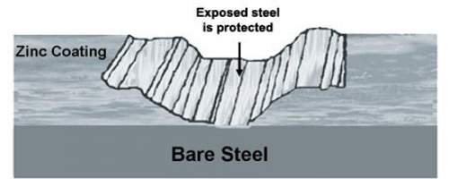

In addition to great barrier resistance, hot-dip galvanizing also provides cathodic protection, which means the zinc will preferentially corrode to protect the underlying steel. We know this based on the Galvanic Series of Metals, which lists metals in order of electrochemical activity in seawater (electrolyte). Metals higher on the list are anodic to those below them, which means they will corrode first when the two are connected. Because zinc sits near the top of the list, it will try to protect many other metals (including steel) it comes in contact with.
![Sacrificial action of zinc, cathodic protection](/uploads/default/_1000xAUTO_crop_center-center_75_none/cathodicprotection.jpg)
In the case of hot-dip galvanizing, where the zinc coating is in contact with the base steel, the zinc will be slowly consumed while the steel remains protected. The zinc’s sacrificial action will also offer protection where small areas of steel may be exposed due to cut edges, drill holes, scratches or other surface abrasion from rough handling, erection, or exposure to elements. In fact, even if the HDG coating is damaged to the point bare steel is exposed (up to about ¼ inch in the maximum diameter) no corrosion will begin until all the surrounding zinc is consumed. For instances where a larger area were exposed, the zinc would keep the corrosion isolated to that area, rather than allow spreading across the part.

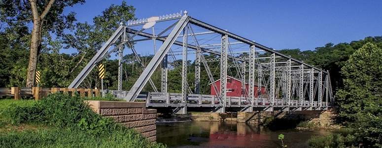

Indian Mill Bridge Rehab: Wyandot County, OH, 2015
![Mill](/uploads/default/_1550xAUTO_crop_center-center_75_none/Mill.jpg)
This single lane vehicular steel truss bridge allows access to the Indian Mill originally built in 1861. The mill was gift to the Wyandot Indian Nation from the US Government as a reward for their aid during the War of 1812. The original covered bridge on the site was replaced by the steel truss after a flood in 1913 destroyed the old structure. In 2010, the local community leaders deemed the old truss functionally obsolete and in desperate need of repair. Because of the historic significance of the site and how integral the truss bridge had become to the overall landscape, the community would not be satisfied with anything less than the original bridge. The local galvanizer and bridge fabricator assured community leaders the original bridge could be rehabilitated; and in fact, be better than ever and able to last another hundred years.
Some engineering was required to bring the bridge to today’s modern standards, but peices of the original 100 year old steel was used which provided a great galvanizing finish. The bridge is in an area with very short summers and long difficult winters, which made the installation window short. The rapid, high-capacity turnaround of the local galvanizer was an important consideration. The rough installation environment and weather could cause substantial damage to other coating systems such as paint, and future maintenance would be difficult. The County Engineer, who was initially very skeptical about allowing his bridge to be taken down, now considers the galvanizer and bridge fabricators as the saviors for this bridge. US Bridge, the fabricator, proposed launching their own Liberty Series Modular Truss Bridge through the existing truss. This approach eliminated all in-stream work, including the construction and removal of the temporary work platforms and piers.
