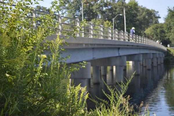

Modern, Natural Appearance
For some galvanized steel projects, such as electric substations, solar panels, or rail line infrastructure, the goal is often to blend seamlessly with the surroundings. As galvanized steel weathers and the zinc patina forms, the coating becomes a uniform matte gray. Whether in rural, wooded areas that are wildlife sensitive or in the city where non-reflectivity is important, the natural, non-intrusive finish of hot-dip galvanizing compliments and blends in with any environment.

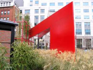

The natural, matte gray finish does not suit every project of every specifier as sometimes color is preferred or needed for branding, safety marking, etc. However, by specifying a duplex system galvanizing your project and then painting or powder coating over to the desired color ensures you dont have to sacrifice the corrosion protection benefits and extended maintenance of HDG steel.
Duplex systems provide more benefit than just aesthetic options. The combination of hot-dip galvanized steel and paint or powder coating provide a synergistic effect. The paint/powder extends the life of the coating by providing an additional barrier coating to the zinc layers, while the galvanized steel prolongs the life of the paint coating by preventing underfilm corrosion and peeling.

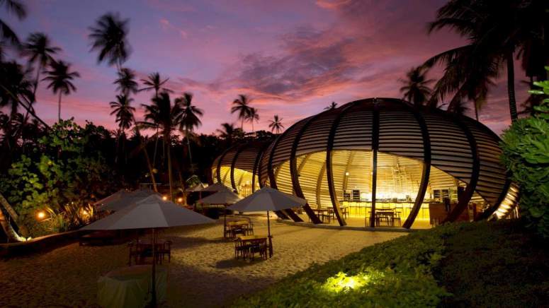

Duplex Case Study
Verele Japanese Restaurant – Anantara Peace Haven Tangalle Resort - Tangalle, Sri Lanka 2017
Verele Japanese restaurant lies at the western-most end of the Anantara Peace Haven Resort Tangalle, overlooking the Indian Ocean. This restaurant on the beach consists of two dome-shaped structures resembling two huge balls. Teppanyaki-inspired dining is enriched by the unique flavors of Sri Lankan cuisine at this specialty beachside restaurant. Because of its location, a duplex system of hot-dip galvanizing and paint was specified to protect these structures from the harsh marine environment and tropical weather of the southern coastal region.
If these structures were painted only, periodic maintenance cost would be much higher due to the rapid rate of corrosion in this high chloride environment. Similarly, adding the additional protective paint coating to hot-dip galvanizing will increase the service life of the galvanizing in this environment.
Anantara Peace Haven Resort is highlighted by this unique restaurant and it is a wonderful tourist attraction. Many tourists enjoy food with the sea view from this restaurant and hot-dip galvanized steel played a major role in making that possible in a cost-effective manner.
