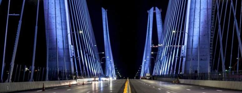

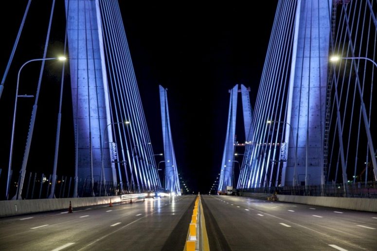

Mario M. Cuomo Bridge - Tarrytown, NY, 2017
The Mario M. Cuomo Bridge is the largest bridge project in New York state history, and one of the largest design-build projects in the United States. The bridge replaces the Tappan Zee Bridge, spanning over the Hudson River, connecting Tarrytown and Nyack, about 30 miles north of New York City. The 60+ year old bridge had been heavily refurbished in recent years but was still becoming a traffic nightmare while carrying 140,000 vehicles per day. Maintenance and upkeep over the next 20 years were estimated to cost as much as a replacement, thus the solution was to build a new structure.
Developed by Tappan Zee Constructors, LLC (TZC), a consortium of top design, engineering and construction firms including Fluor, American Bridge, Granit, Traylor Bros., HDR, Buckland & Taylor, URS, and GZA, the new 3.1-mile twin span cable stayed bridge was built to have a 100-year design life. Working closely with the New York State Thruway Authority and the State Department of Transportation, the TZC completed the bridge on a strict 32-month schedule and within a $3.98 billion budget. The first span opened in August 2017 and the rest was set to open in 2018.
Once completed, the Governor Mario M. Cuomo Bridge will ease traffic between southern and western New England with eight traffic lanes, four emergency lanes, and state of the art traffic monitoring systems. Furthermore, there will be a lane solely for commuter buses as well as a bicycle and pedestrian path, and thanks to forward thinking the bridge also has the possibility to add mass transit options in the future.

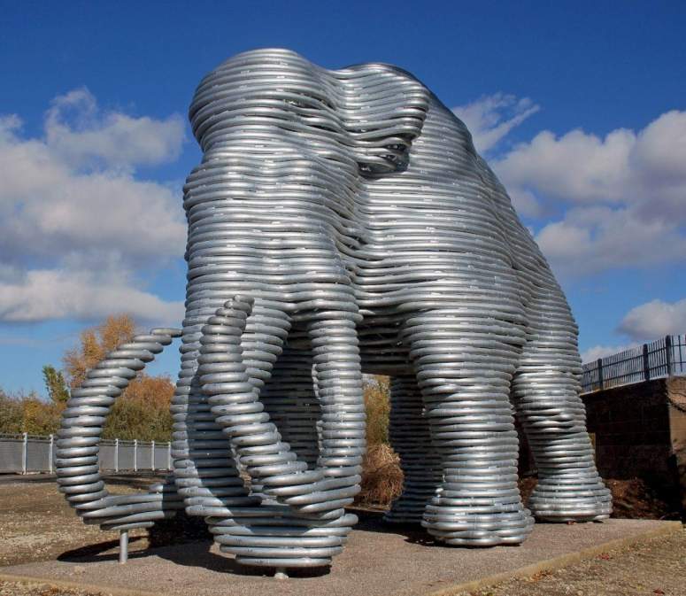

Mammoth - San Jose, CA 2015
On a well-traveled trail head on the Guadalupe River in San Jose, CA stands a tribute to a long gone, but not forgotten mammal. A galvanized bent-pipe sculpture of an enormous adult mammoth, towering over 12 feet tall and 18 feet long weighing in at a massive five tons, it is truly a sight to behold.
The inspiration for this galvanized work of art began five years ago after the unearthed bones and teeth of an extinct Columbian Mammoth were discovered in the area in 2005. The bones were extracted and taken to the Department of Paleontology at the University of California at Berkeley to be studied and cataloged, and Lupe was eventually installed as a hands-on exhibit at the Childrens Discovery Museum.
However, in 2010, numerous city leaders began thinking about putting an artistic tribute at the dig site to commemorate the Columbian Mammoth. Ultimately, two designers were commissioned to design, fabricate, and erect a sculpture in a picturesque location near the initial discovery site. The concept and fabrication process went through multiple iterations before settling on a galvanized bent-pipe design.
