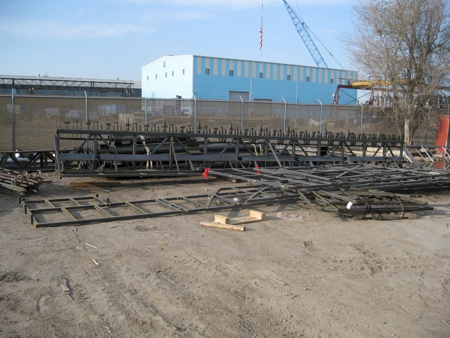

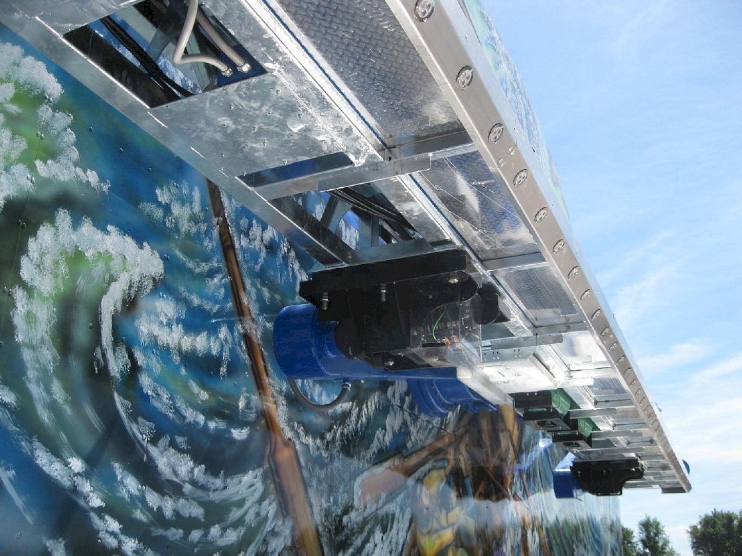

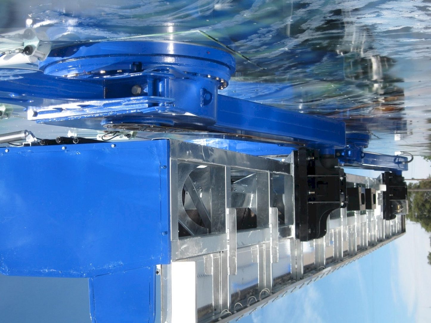

Hot-dip galvanizing has become the essential protective coating for battling the effects of corrosion in these harsh, high salt/precipitation environments. Wisdom Rides offers hot dip galvanizing options on all steel components including the transport trailers the rides are mounted to.

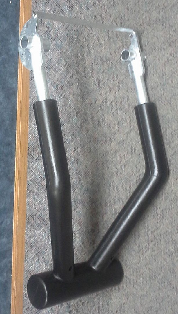

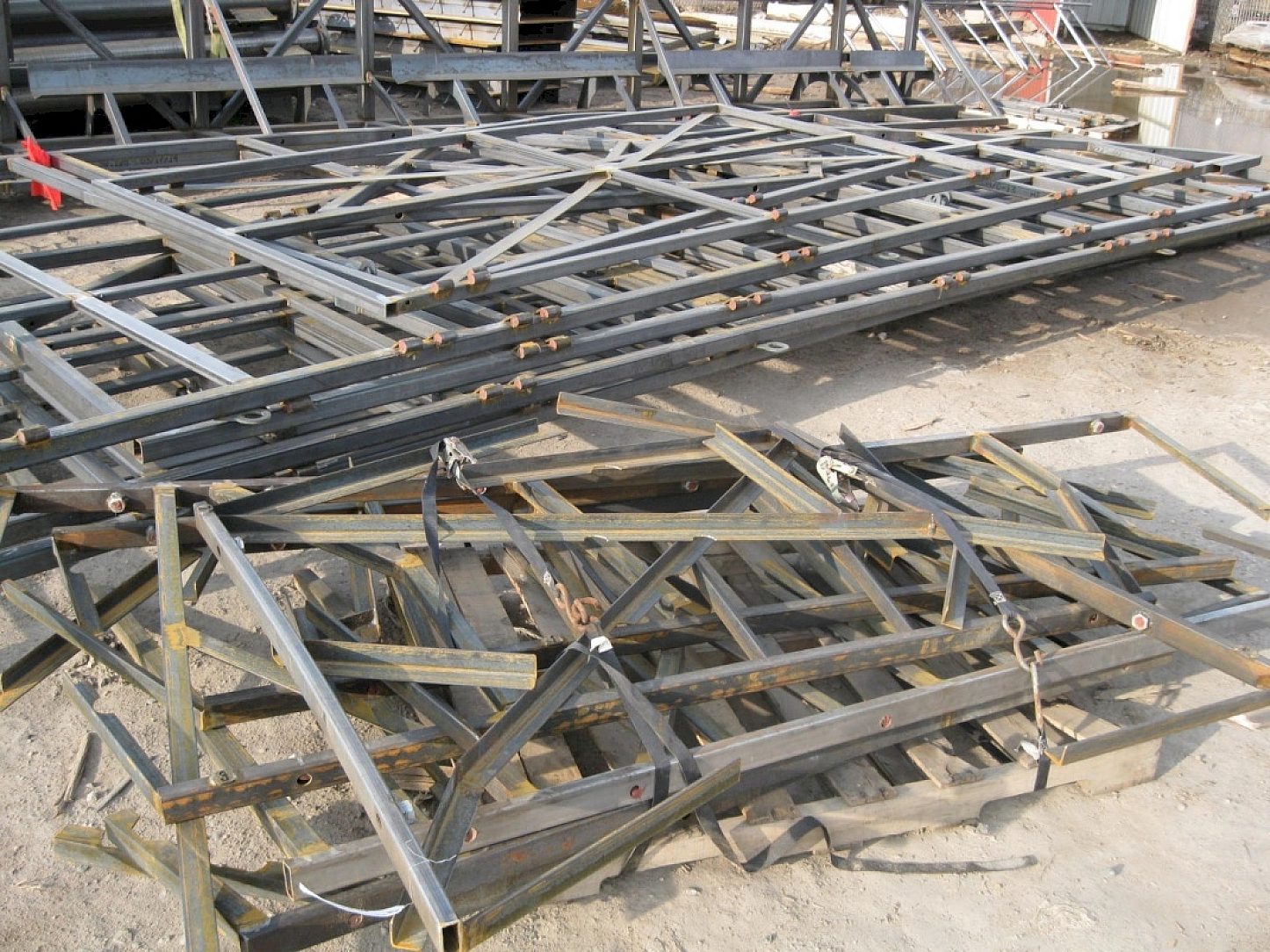

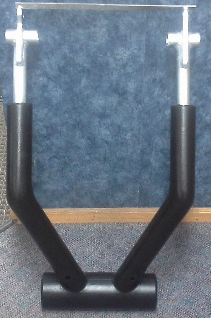

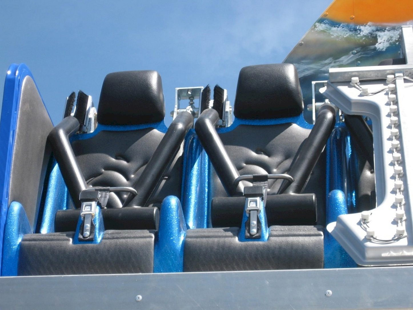

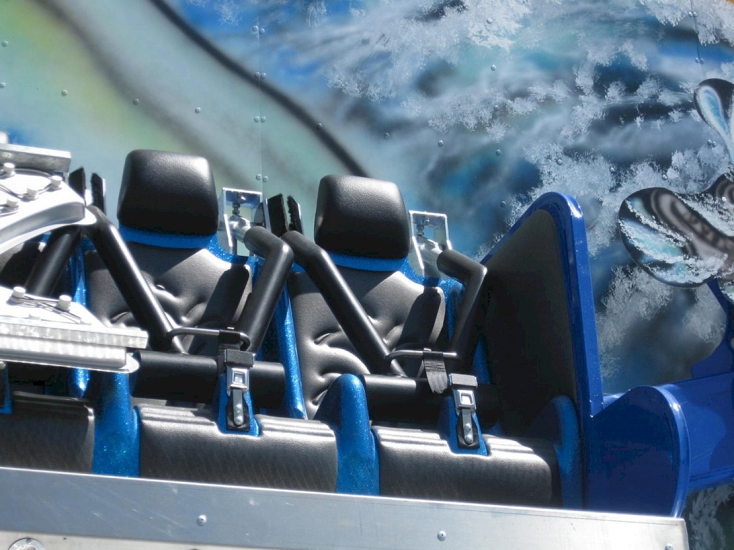

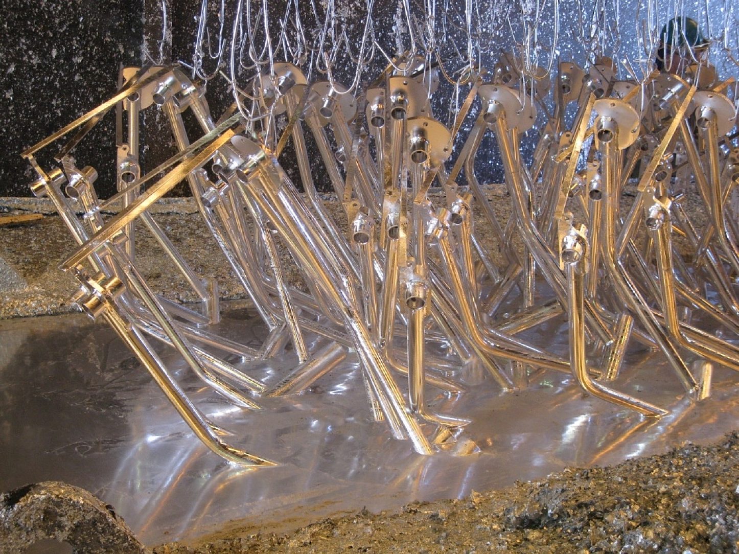

Many of the structural components for these rides including the seat frames, personal restraints and scenery framework are of tube design and unseen internal corrosion is one of the biggest concerns for Wisdom Rides.
Since the inside of these hollow components are not visible, it is not apparent if there is a corrosion problem. Fortunately, hot-dip galvanizing coats all surfaces, providing the critical, long lasting internal protection to ensure structural integrity and instill confidence.

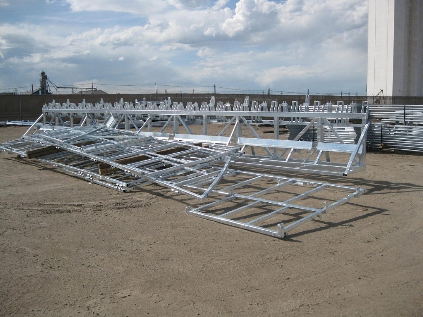

Wisdom Rides works closely with the galvanizer to design hollow components with precisely sized and located vent and drain holes that will allow the galvanizer to completely coat the internal surfaces of each component with equal protection to the outside surfaces. Once galvanized these holes are easily repaired using aluminum tapered plugs that can be installed quickly without damaging the galvanized coating.
The versatility of the hot dip galvanized coating is an added bonus as special safety materials including molded, soft urethane foam covers for rider restraints and lap bars can be applied directly over the hot dip coat. Once the galvanizing is complete, urethane safety features added and the ride is reassembled, its ready to battle the corrosive elements for the long haul.
