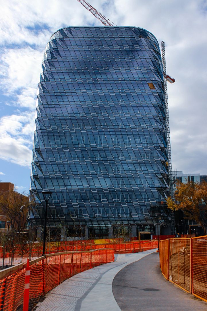

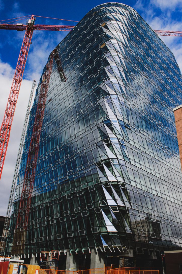

In September 2017, the crews on site began demolition of the existing tower, recycling the concrete, steel and glass while keeping the main support of the tower intact. Two additional floors were added, then the reconstruction of the exterior continued. According to the University of Calgary, “Unlike any other building on campus, MacKimmie Tower’s double-skin exterior will respond to changing weather and work with the exposed concrete structure and mechanical systems to minimize energy use and optimize internal temperature, daylight, and air quality for occupants.” The reuse of the existing structure reduced the amount of waste created during construction, a key initiative that aligns with the university’s Institutional Sustainability Strategy.

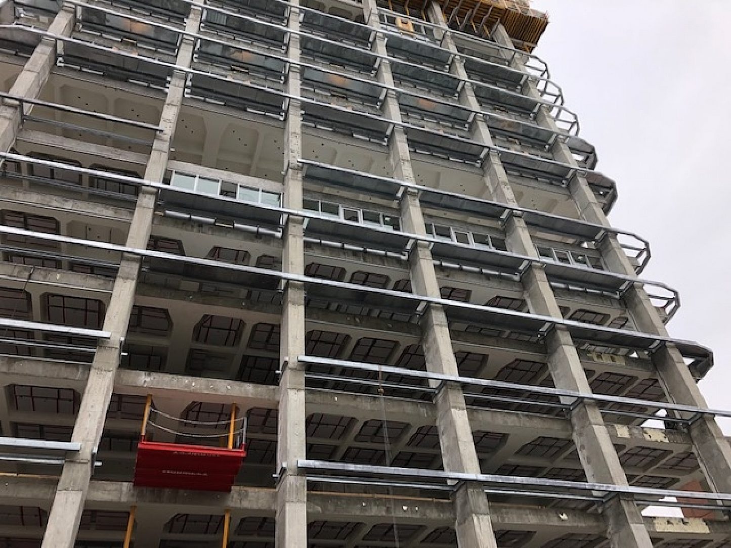

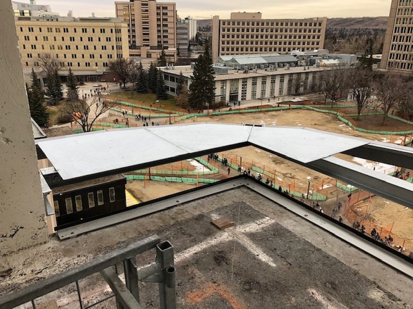

As a pilot project for future net zero carbon building in an institutional setting, the use of hot-dip galvanized steel addresses both sustainability and affordability. Both steel and zinc are natural, abundant, and infinitely recyclable, so investment in their use eliminates waste and ensures availability of the materials for future generations. Furthermore, the addition of hot-dip galvanizing to the steel provides maintenance-free performance – extending the life of the structure with minimal environmental impact.

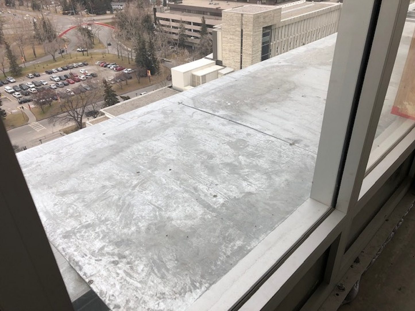

The plates and structural steel supporting the double-skin exterior were hot-dip galvanized with ease. However, a challenge arose as the large pieces sat in the wet and snowy weather for extended periods of time, leading to wet storage stain. The skids consisted of 20 plates each and were initially bundled together after galvanizing with wire separating each piece. When unbundled on site, the plates had visible formation of zinc oxide and hydroxide. Although there was very little zinc metal lost, around 10% of the total quantity affected, the aesthetics of the piece was of tremendous concern, so they were stripped and regalvanized. The second time around, the plates were bundled together with 6mm gaps between each and stored indoors until needed for erection to ensure no wet storage stain could form. This expensive lesson created a new internal process for similar material going forward.
