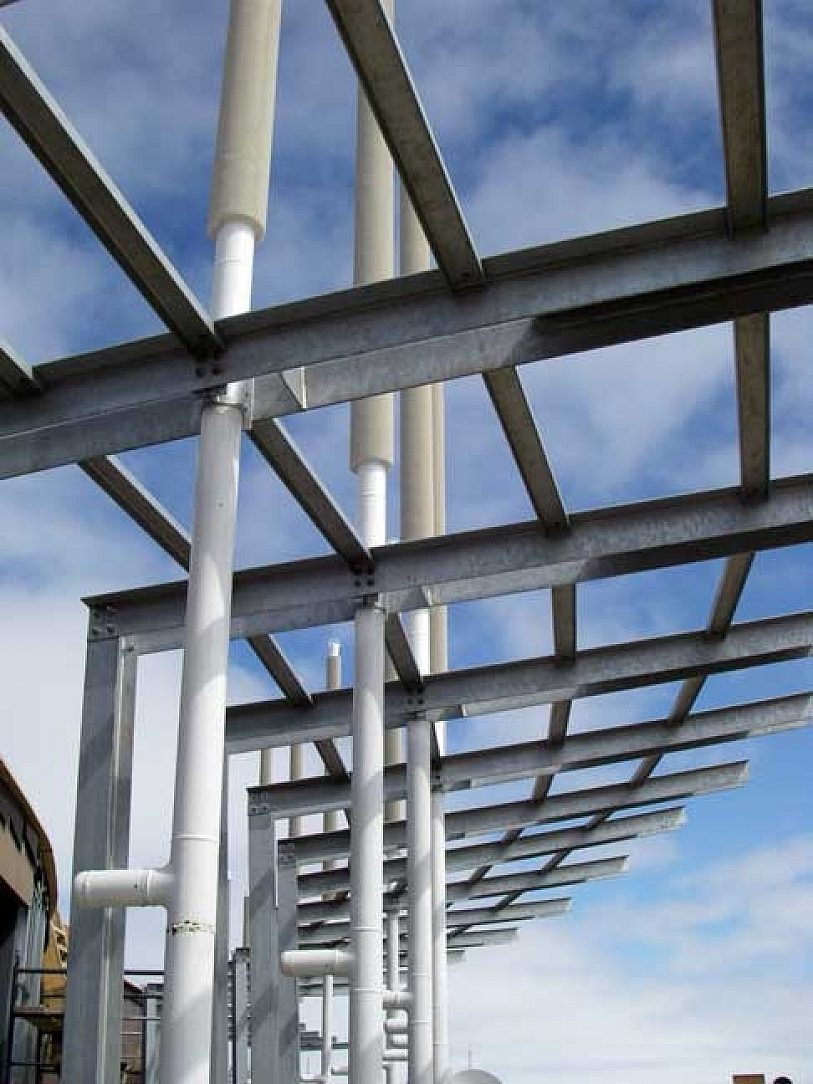

Eppley Airfield North Hangar Snack Bar
Sioux City, IA United States | 2006
2006
