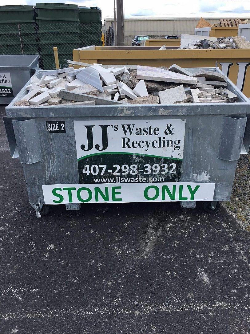

Take a look around the next time you drive past a construction site or commercial business, and you will likely see they have one thing in common; a trash dumpster that is rusting and falling apart because the paint coating could not protect it from its harsh and abusive environment. What makes JJ’s Waste & Recycling so unique was their decision to hot-dip galvanize all of their industrial size trash dumpsters.

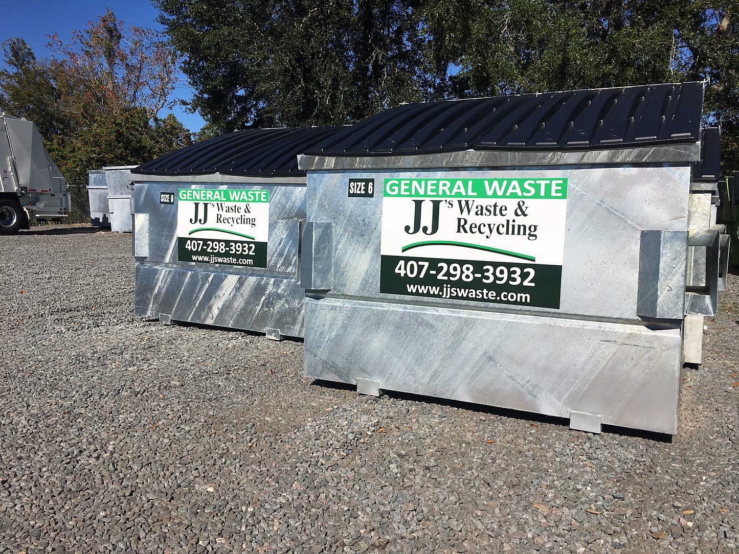

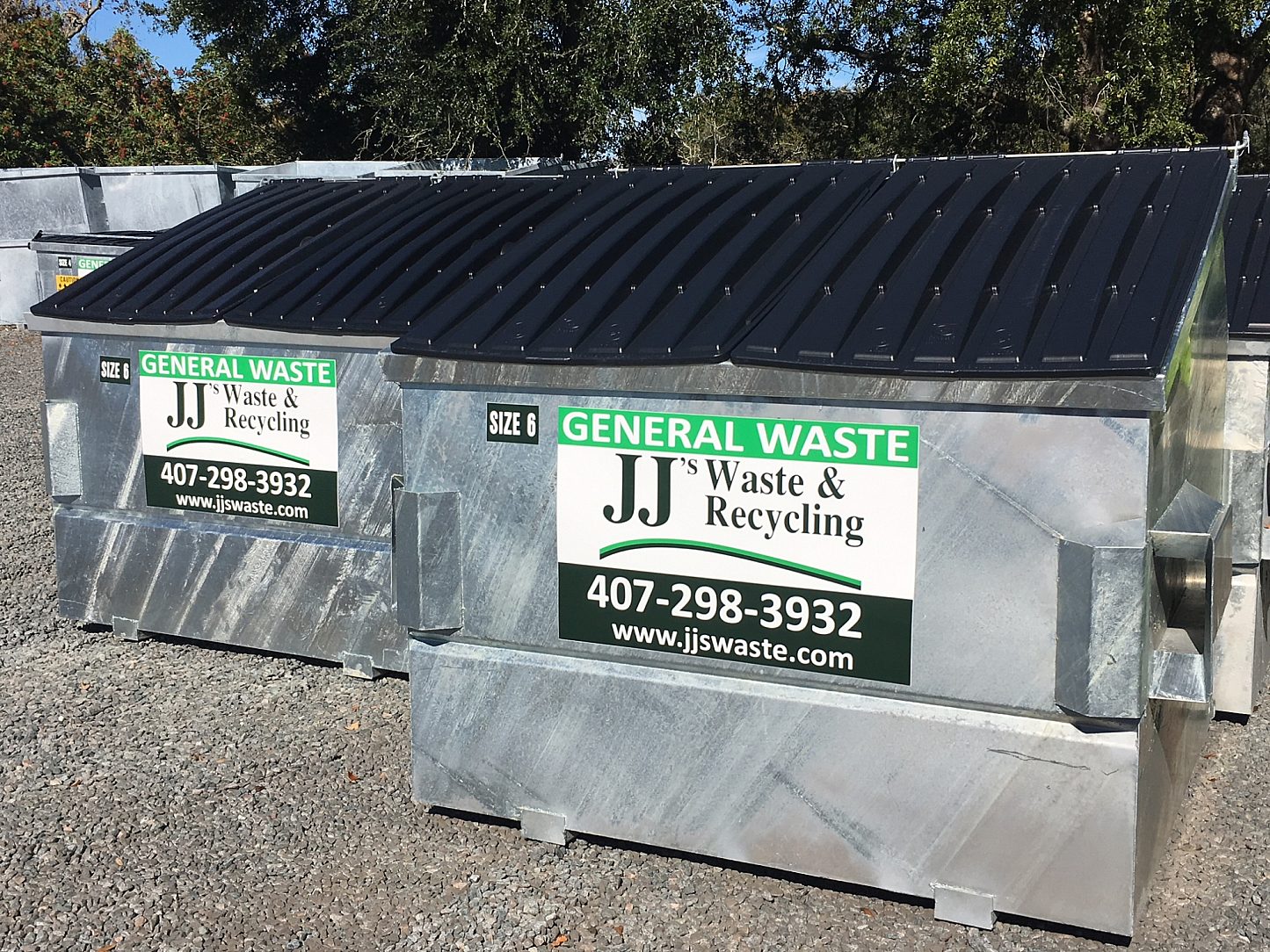

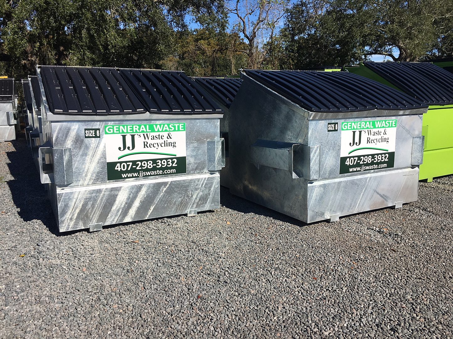

With their industrial trash service, JJ’s Waste & Recycling offers 2yd, 4yd, 6yd, and 8yd size dumpsters. They started galvanizing the dumpsters in the 1980’s and quickly realized that the benefits were abundant. Darrell Corbett, Vice President of North American Operations, revealed that dumpsters coated with paint tend to yield approximately 4-5 years of service. Corbett expects to yield at least 8-10 years, but possibly as many as 15-20 years depending on the harshness of the environment, with the hot-dip galvanized dumpsters. Based on average zinc coating thickness, the Time to First Maintenance is approximately 50 -75 years, even in the most extreme environments.

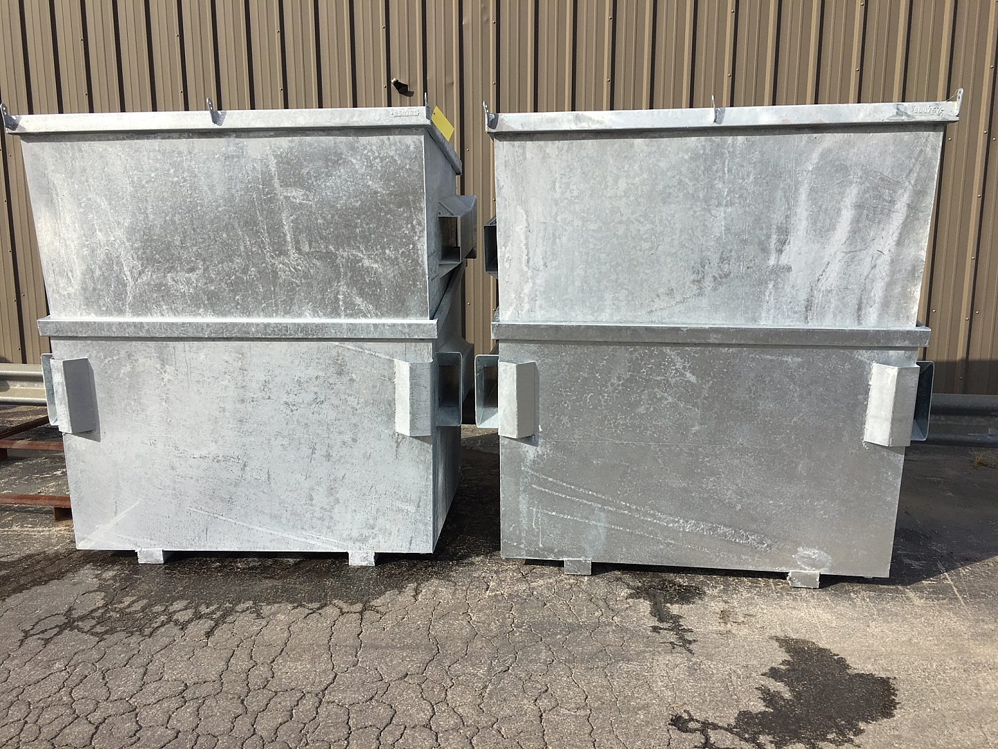

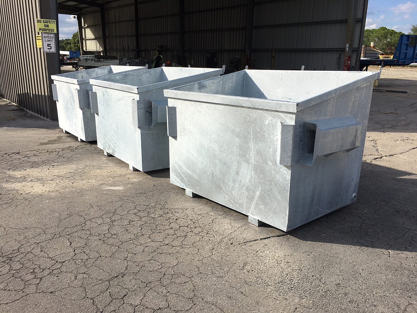

The sheer shape and size of the dumpsters meant that fixturing techniques must be optimized for the hot-dip galvanizing immersion process. Trash dumpsters serve a very specific purpose, therefore, vent and drain hole locations were designed to accommodate both product functionality and a quality hot-dip galvanized coating. The galvanizer was able to perfect their processes to ensure a smooth, uniform coating, both inside and out. The beauty of a zinc coating only adds to the overall appeal, and by choosing to hot-dip galvanize their dumpsters, JJ’s Waste & Recycling has gained a competitive advantage and created a new standard of excellence in the waste industry.
