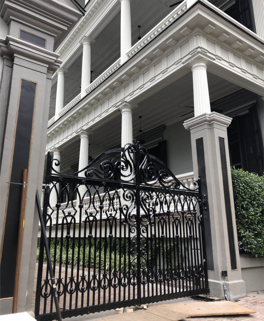

After over 40 hours of labor; using only handmade tools, this gate was designed with care. It was first hot-dip galvanized and finished with a blackened zinc patina coat; advancing the coating strength. Adding an extra layer of zinc protection while providing enriched aesthetics, the combination of hot-dip galvanizing and this blackened layer will allow this gate to shine for years to come. Galvanizing was the choice for corrosion protection because it delivers maintenance free performance for decades.
Roberts’s talent as a blacksmith and his experience with hot-dip galvanizing allowed him to find a unique advantage offered by the process that is not often embraced. When buildup is generally frowned upon in the galvanizing community, he incorporates this effect to improve the strength of his structures. He is able to adhere joints and ensure stability without leaving unsightly pins or weld marks on his work, providing a smooth surface his clients can appreciate.
This type of intricate work tends to be delicate and requires special handling. It is essential that the surfaces be smooth and the quality of the blacksmith’s work integrity stay intact. For that reason, galvanizing was an ideal coating option.
