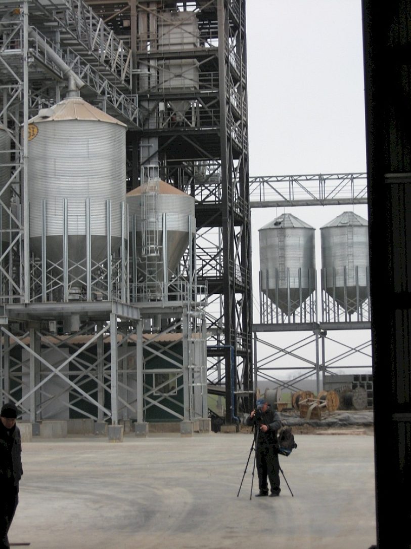

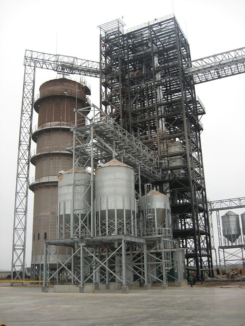

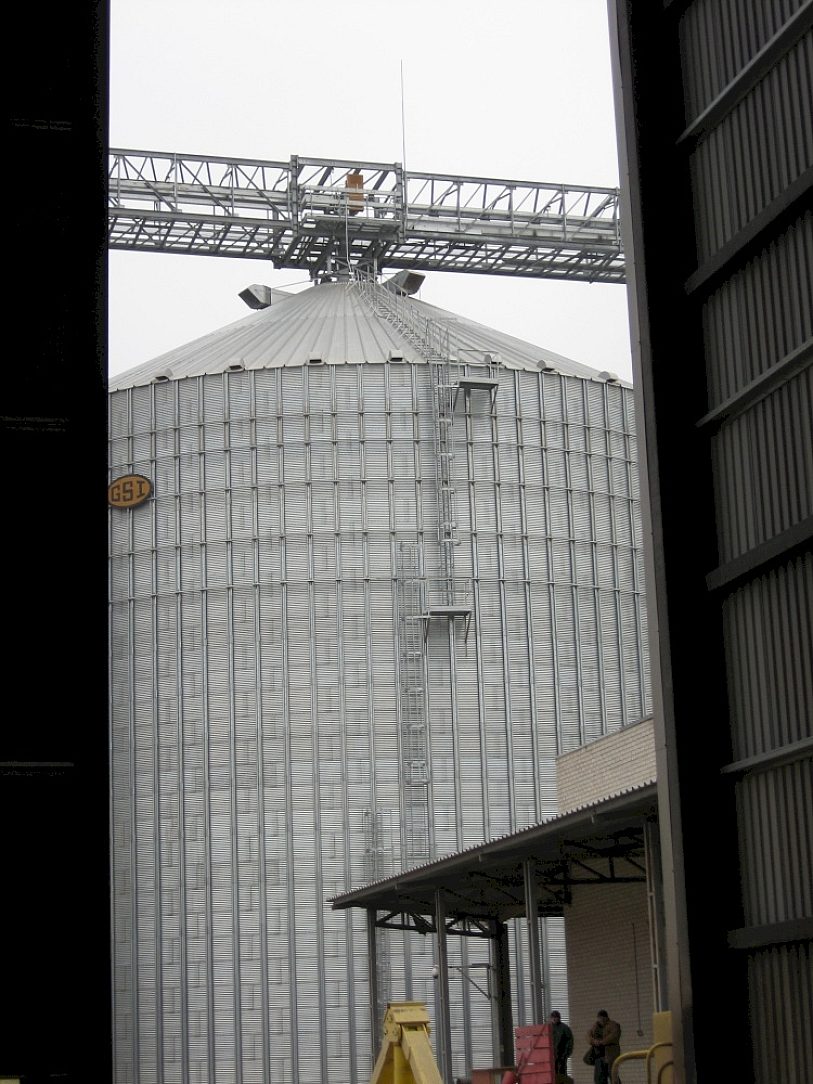

Ukraine is the breadbasket of Eastern Europe. In spite of the military conflict in the Southern regions, Ukraland Farming was able to continue its large expansion of grain handling sites throughout Ukraine with no military conflict interruptions. Five sites of grain processing and storage equipment were developed and built. Each was comprised of at least 1,000,000# of galvanized structures. These sites have the ability to process and store corn, wheat, sorghum and soybeans.
The consistent appearance of hot dip galvanizing and the quick turnaround at the galvanizer made it an easy decision to choose hot-dip galvanizing.
GSI Johnson Systems was chosen by Ukraland Farming for its ability to handle such a large project with five different locations thousands of miles from the point of manufacture. GSI also has the reputation of providing top quality structures made of entirely galvanized steel. Michael Johnson of GSI said, Hot-Dip Galvanizing is the key to GSI Johnson Systems success. We know that in spite of the shipping to Eastern Europe, hot-dip galvanizing will arrive undamaged by material handling.
The harsh winters in the Ukraine required a corrosion control system that provides maximum protection. Michael noted, We also know that hot dip galvanizing will provide years of unmatched corrosion protection. We are confident that there will be no corrosion problems to address on such a faraway site. No paint system can compare. The consistent appearance of hot dip galvanizing and the quick turnaround at the galvanizer made it an easy decision to choose hot-dip galvanizing.
The success of galvanizings quality and durability on this project makes it easy for GSI to recommend hot dip galvanizing for all of its projects. Ukraine Farmland accepted GSIs recommendation and looks forward for years of corrosion free operations.
