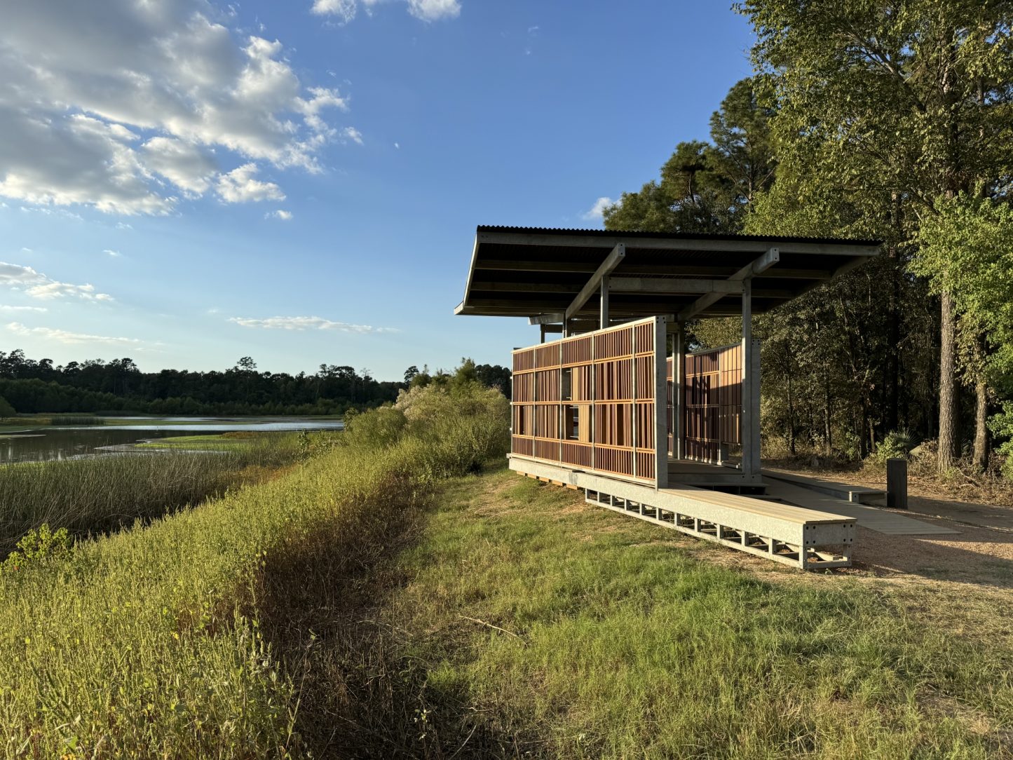

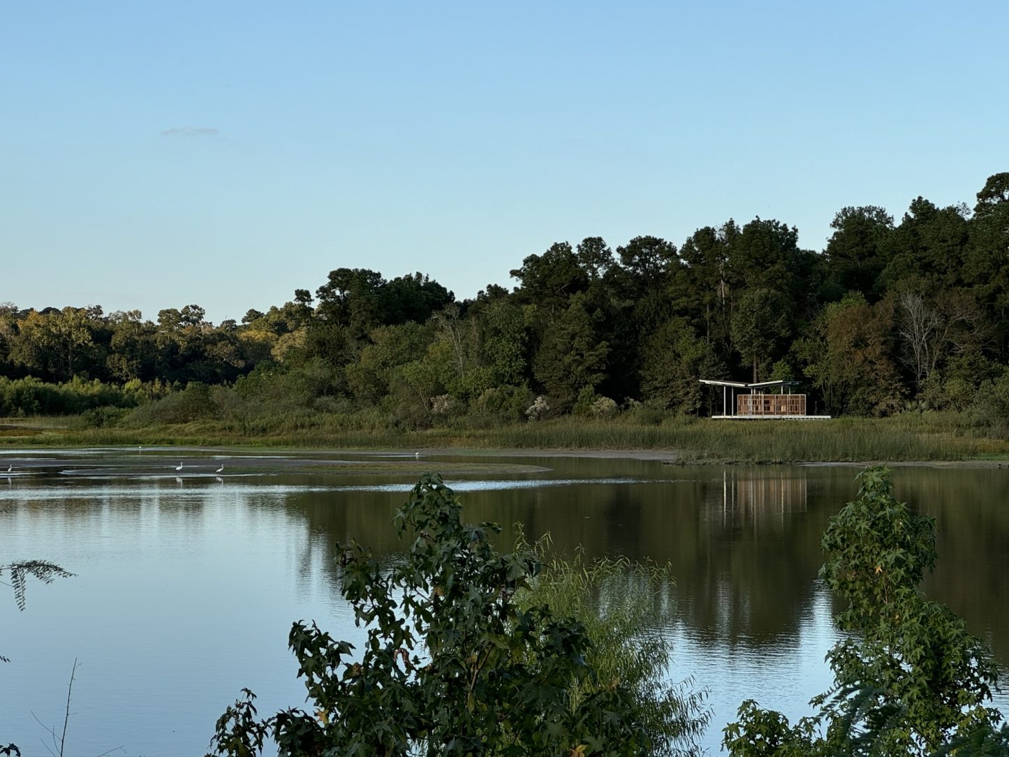

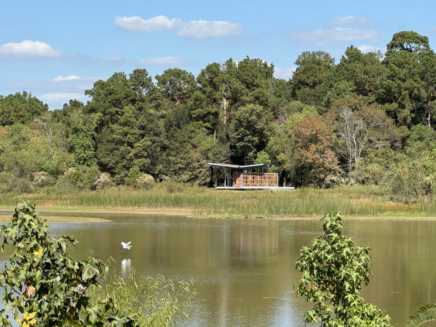

The Bird Blind Wildlife Observatory was designed with dual purposes in mind. It not only provided an opportunity for architecture students to engage in a real-world project, from concept to completion, but also serves as a long-standing public amenity for the local community. Located along the Spring Creek Nature Trail, part of The Woodlands’ extensive 220-mile network of trails, it has quickly become a popular destination for birdwatchers. Positioned next to a water body rich with bird habitats, the Bird Blind has contributed to sightings of more than 130 bird species, offering respite from the Texas heat with its shaded, elevated platform. The vertical screen walls are designed to protect local wildlife by minimizing disturbances.

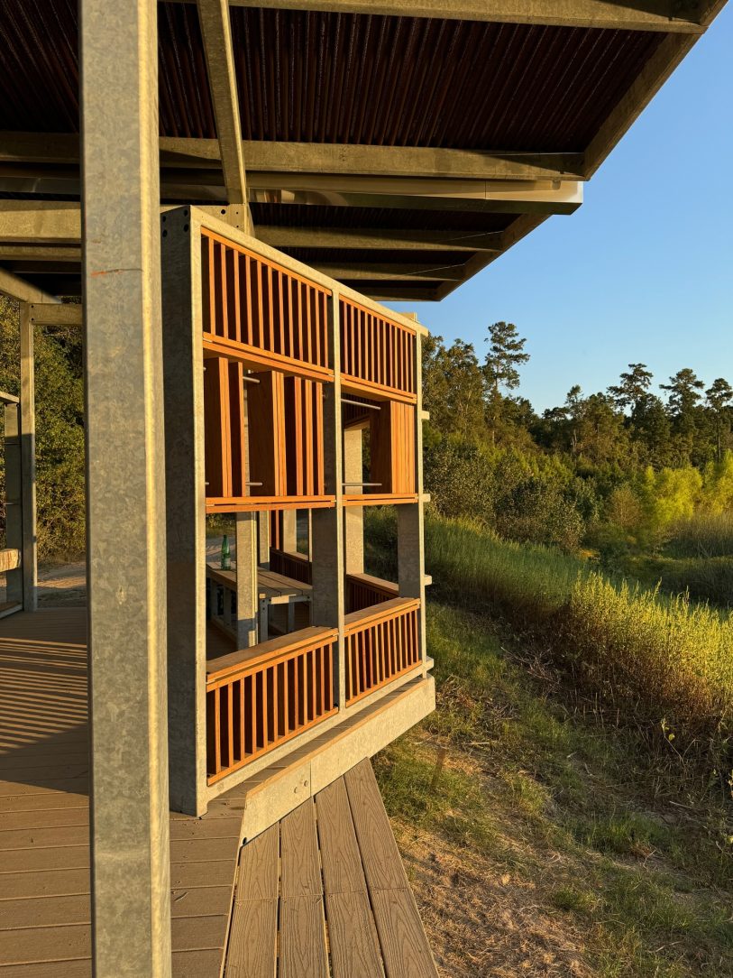

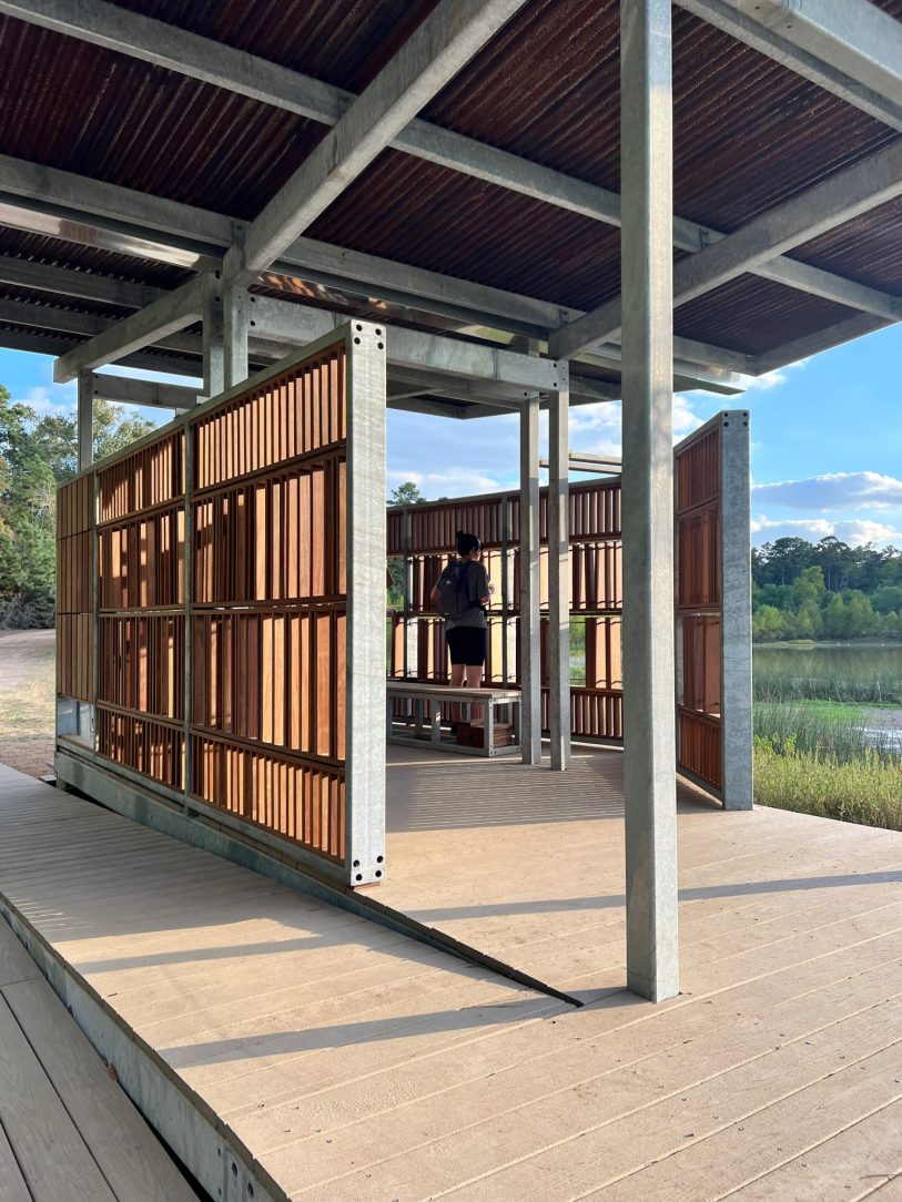

The blind's design features a galvanized steel frame that supports columns, roofs, ramps, and vertical walls raised above existing flora and fauna. While wood dominates the surfaces, the galvanized steel frames ensure structural integrity and resistance to wind and moving water. The matte gray color of the galvanizing blends effortlessly into the natural surroundings, while its durability offers a vital defense against the intense heat and flooding common in the area. With a lifespan of nearly 100 years, hot-dip galvanizing was the ideal choice for this sustainable project, providing long-term corrosion protection with minimal maintenance.

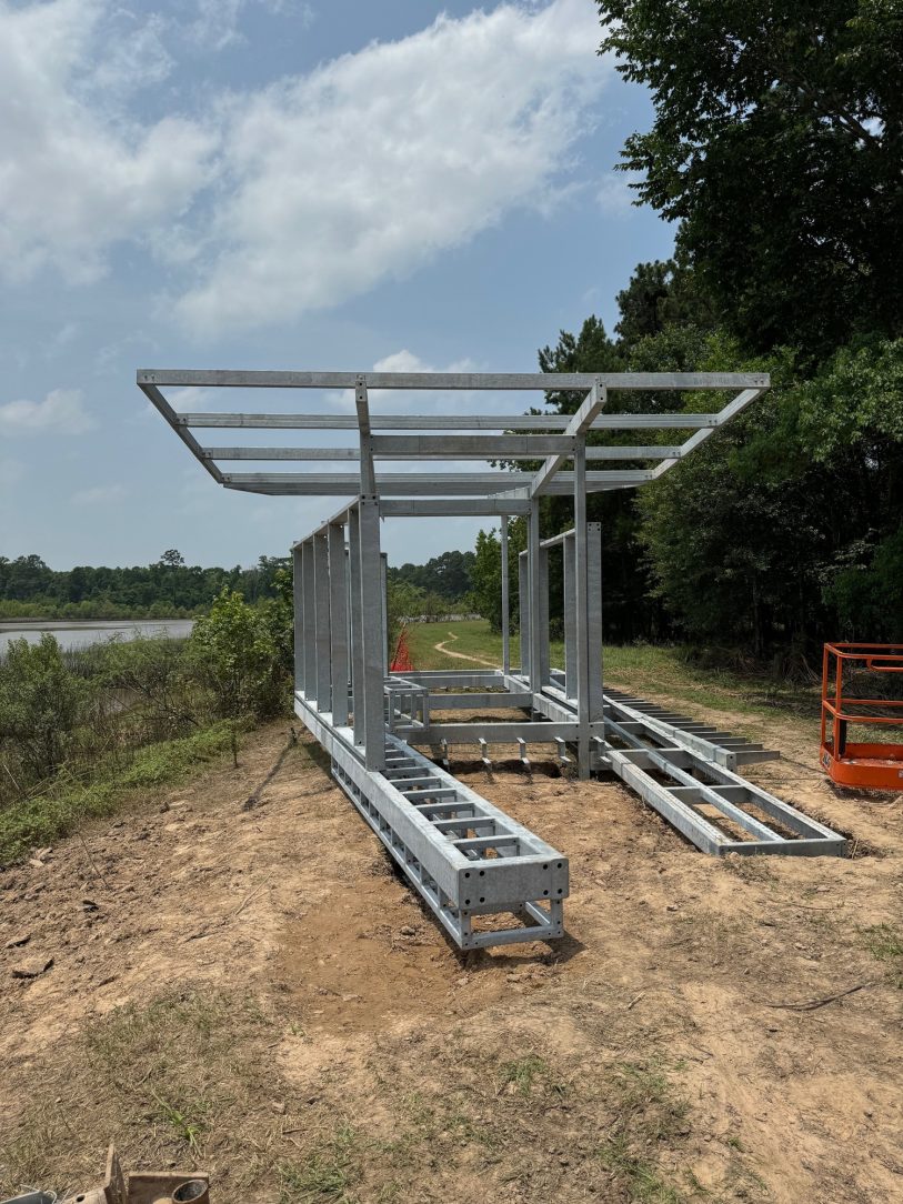

What truly sets this project apart is its thoughtful design informed by galvanizing. Architecture graduate students, after touring the galvanizer's plant, grasped the critical role of hot-dip galvanizing in ensuring the building's longevity and resistance to the elements. The design considered the intricacies of this coating protection, including scaling, venting, and drainage. Pre-welded assemblies were constructed before reaching the site, streamlining the on-site construction process.
