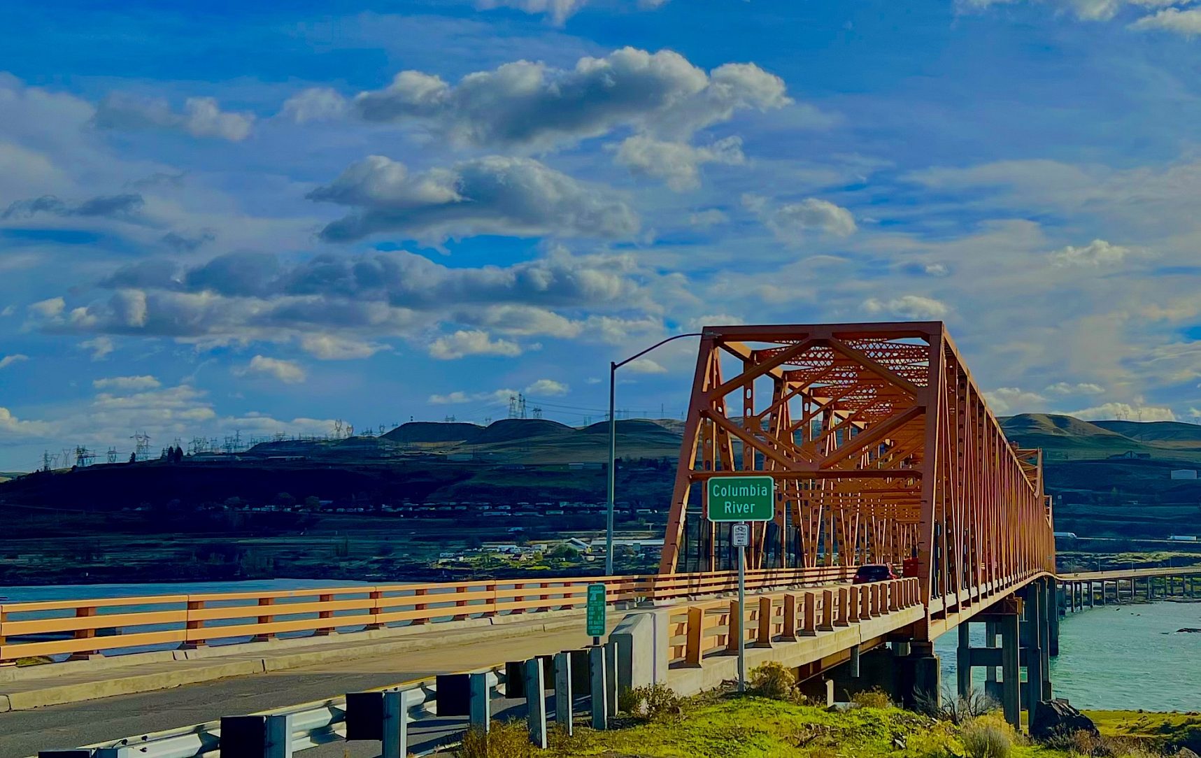

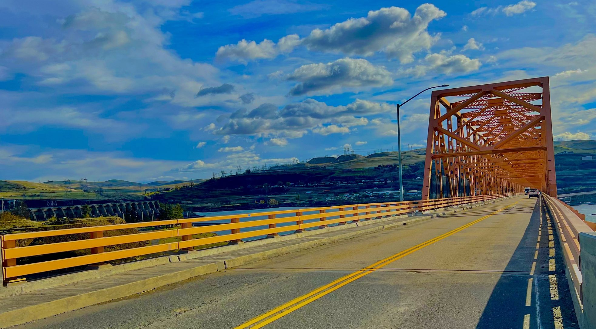

The newly galvanized and powder coated steel posts and rails were chosen due to the harsh climate that The Dalles Bridge is exposed to.
In 2023 the bridge rail and guard rail were replaced to meet current highway standards and crash codes. The original concrete posts were replaced with steel beam posts and 3-line tube steel railing pieces. Each section of 3 tube railing is different due to needing to not interfere with original truss members and rivets. Over weekends long sections of bridge decking were replaced with new concrete decking and the accompanying duplex coated steel tube rail and posts. Tube lengths had to match the differing concrete deck lengths. Presenting a greater design challenge for the fabricator. The cost of this upgrade was $41 million shared 50/50 between Oregon and Washington.
The newly galvanized and powder coated steel posts and rails were chosen due to the harsh climate that The Dalles Bridge is exposed to. Winters are extremely cold, and summers are extremely hot with high winds throughout the year blowing down the Columbia Gorge and river. The Dalles receives annual average rainfall of 14” and annual average snowfall of 15” creating a great need for corrosion protection. The duplex coating selected will ensure a maintenance free lifespan of 50-75 years.
