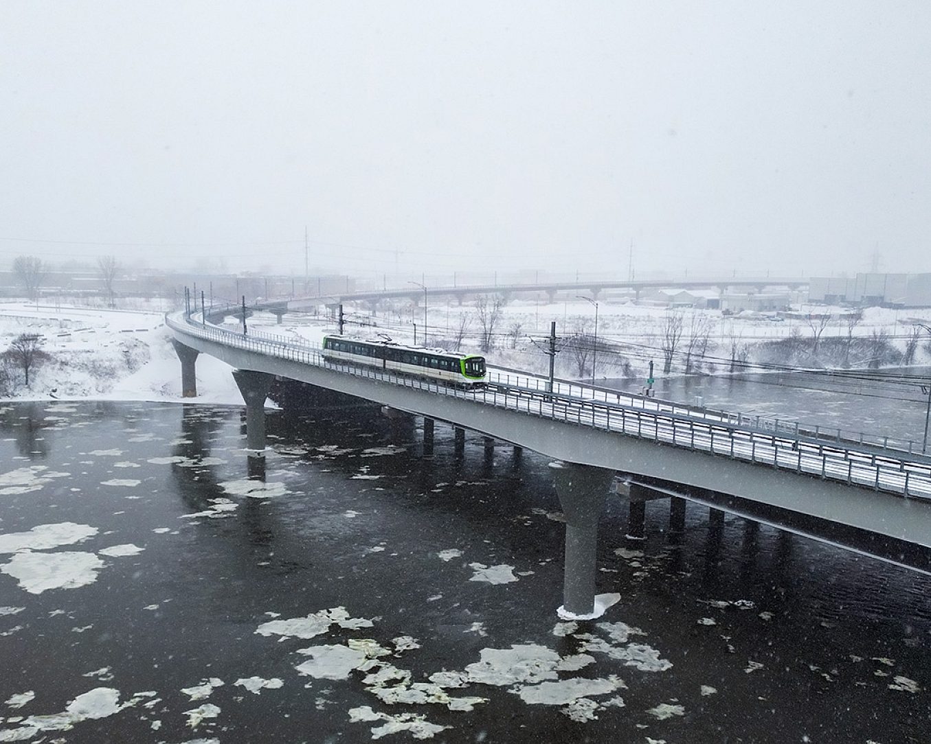

On July 31st, 2023, Phase One of the long-awaited REM Light Rail system opened for public use. This 10-mile, five-station line connects the island city center with suburbs on the south shore of the Saint Lawrence River. The line uses elevated sections, bridges, and tunnels as well as on grade railbed. This section was completed first as it is the most urgently needed due to severe congestion on the bridges crossing the Saint Lawrence River in the Montreal area.

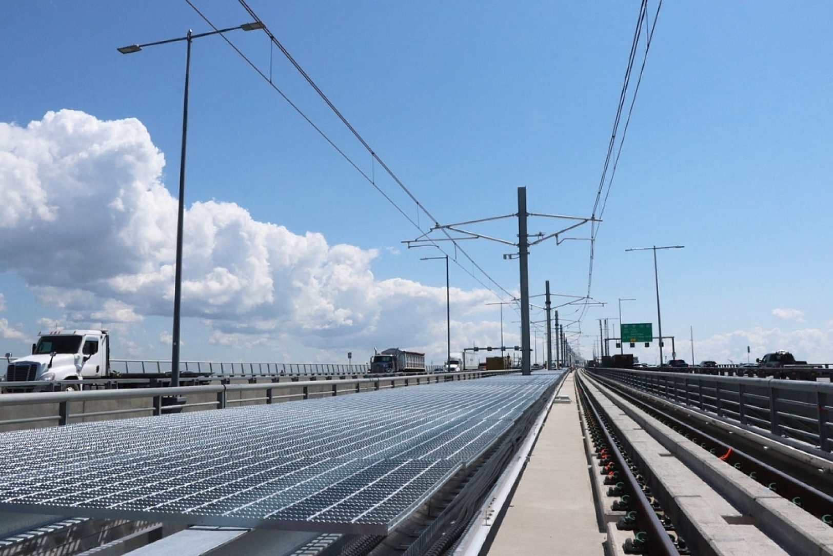

Hot-dip galvanizing brought powerful benefits to the project, especially when considering the damp cold climate and the widespread use of de-icing chemicals. The long-proven low-cost performance of hot-dip galvanizing on corrosive Canadian roadway conditions was well known to engineers but less well known were the precision product control capabilities of modern galvanizing plants. Consistently high-quality finishes and bar-code-controlled bundle identification streamlines on-site erection and the amazing impact durability of zinc coated steel eliminated almost all costly onsite damage remediation. Additionally, the project’s quick turnaround further contributed to lowering costs and speedy completion schedules.
