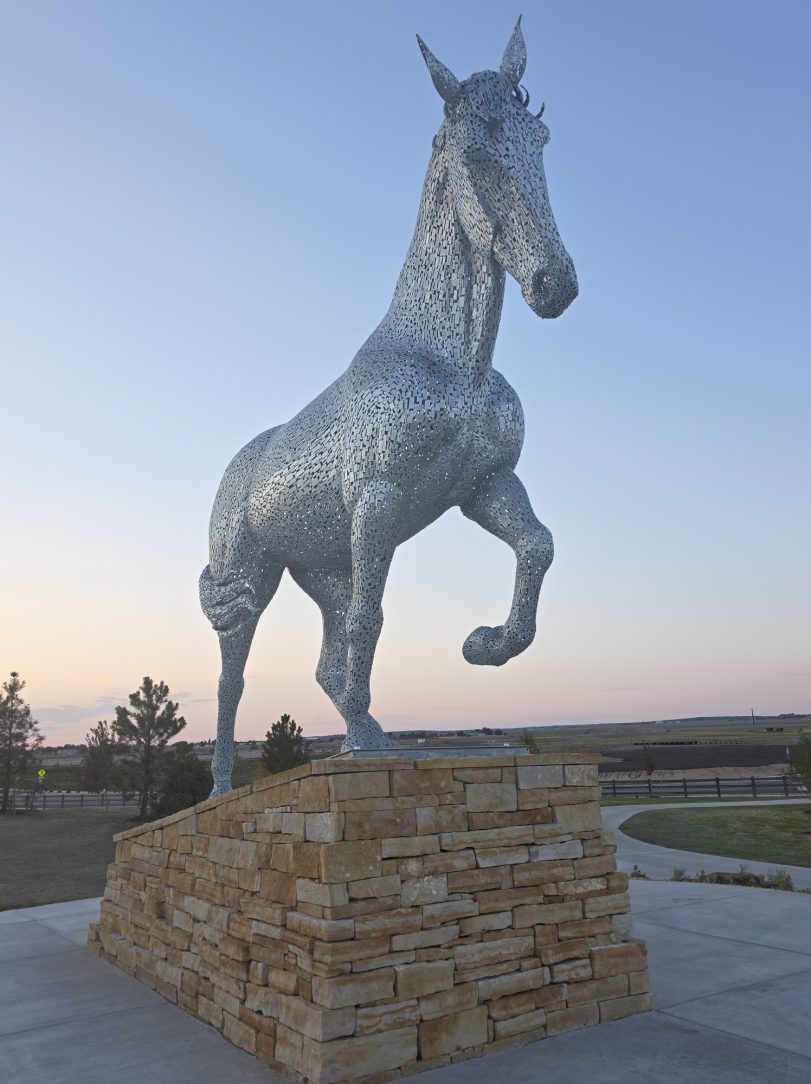

Imagine a draft horse caught mid-stride on the high plains, mane and tail lifted by Front Range wind, musculature defined through bust and rib, light playing across a zinc-armored steel form. “Belle” is a 5,000-pound draft horse sculpture by the world-renowned Scottish artist Andy Scott, now anchoring Percheron, a Norwood Development Group community, at East Woodmen Road and Banning Lewis Parkway in Colorado Springs.
Scott’s portfolio spans major commissions across Europe, Australia and North America, his reputation built on turning industrial materials into lyrical, site-specific icons, and his work is almost universally regarded as nothing short of creative genius. Rising 15 feet (21ft on her stone plinth) “Belle” is both landmark and namesake, a sentinel whose galvanized finish reflects the region’s working-class spirit. Poised between open plains and the Rocky Mountains, she serves as a point of orientation and a place to gather, her faceted geometry catching sun, snow, and shadow alike, an enduring emblem of strength, resilience, and purpose.

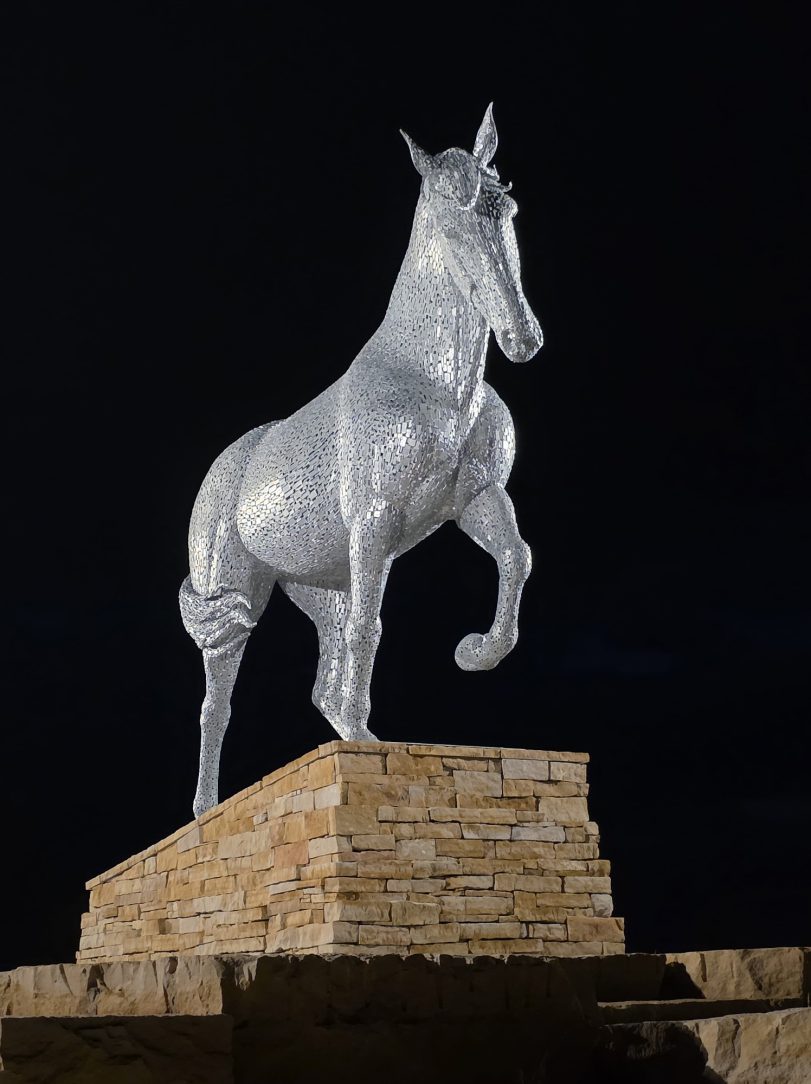

“Belle” advanced through a disciplined public-art process: context, engineering, fabrication, protection, and placement. The concept linked Percheron heritage to key sightlines, evolving directly from sketches to the completed sculpture, defining the pose, anatomy, structure, and service access. The artist uniquely relies only on hand-skills and draftsmanship – no computers or digital modeling is used.

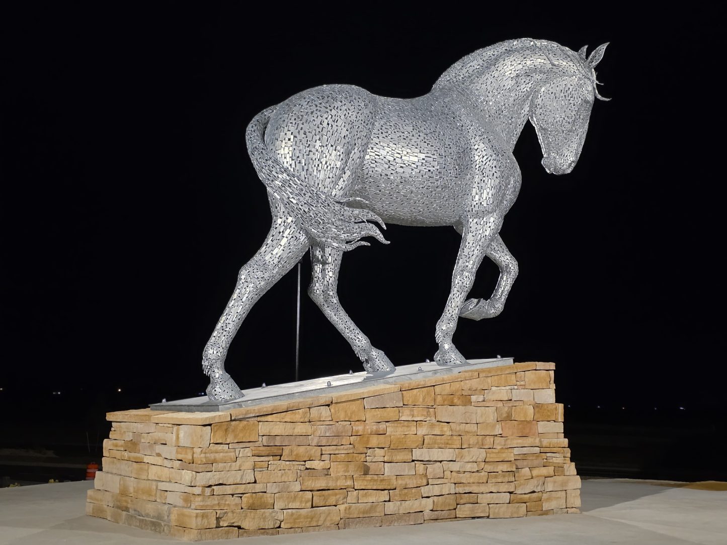

The artist designed concealed structural reinforcement and a panelized exterior that reads as skin and light while preserving the sculpture’s curves. Crucially, thousands of small steel flat bars, guillotine-cut and faceted to create the impression of curves, were welded hand-stitched across the surface. This creates a fine pattern that softens reflections, evokes the mane’s motion, and channels water to discreet drains. It resembles a three-dimensional pointillist painting.

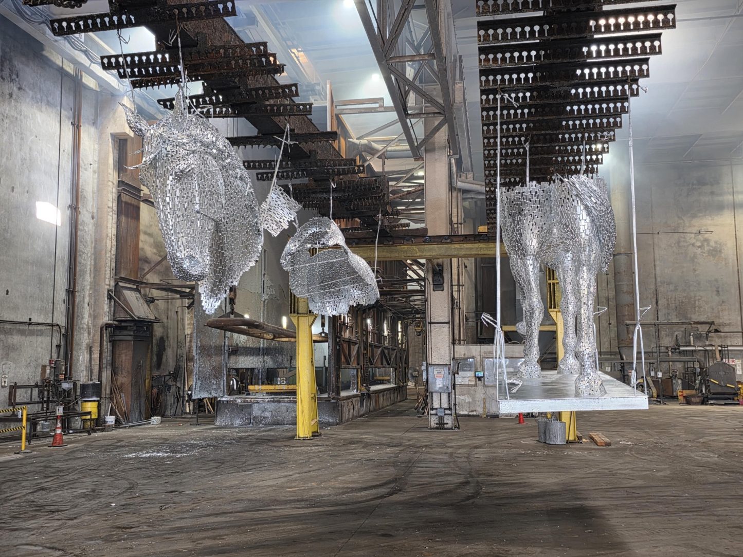

In the shop, parts were formed, fitted, and welded in controlled sequences, then trial-assembled to verify alignment; every enclosed cavity included vents, drains, and temporary pick-up lugs. For durability, the piece was degreased, pickled, fluxed, and hot-dip galvanized, immersed in molten zinc at ~830°F (450°C) to form alloy-bonded layers, then inspected and cleaned at cutbacks. The resulting coating, a few thousandths of an inch thick, provides both barrier and sacrificial (cathodic) protection and gradually weathers to a soft matte gray zinc patina that complements the work’s crisp geometry.
Colorado Springs can swing from snowy and cold to sunny and mild in a single afternoon; wind-blown grit, de-icing salts, and high UV are everyday realities. Hot-dip galvanizing meets those demands with a metallurgically bonded iron-zinc shell whose thickness can be measured and maintained over decades, built for the long haul, gleaming now and designed to endure the harsh seasons as its zinc patina matures.
