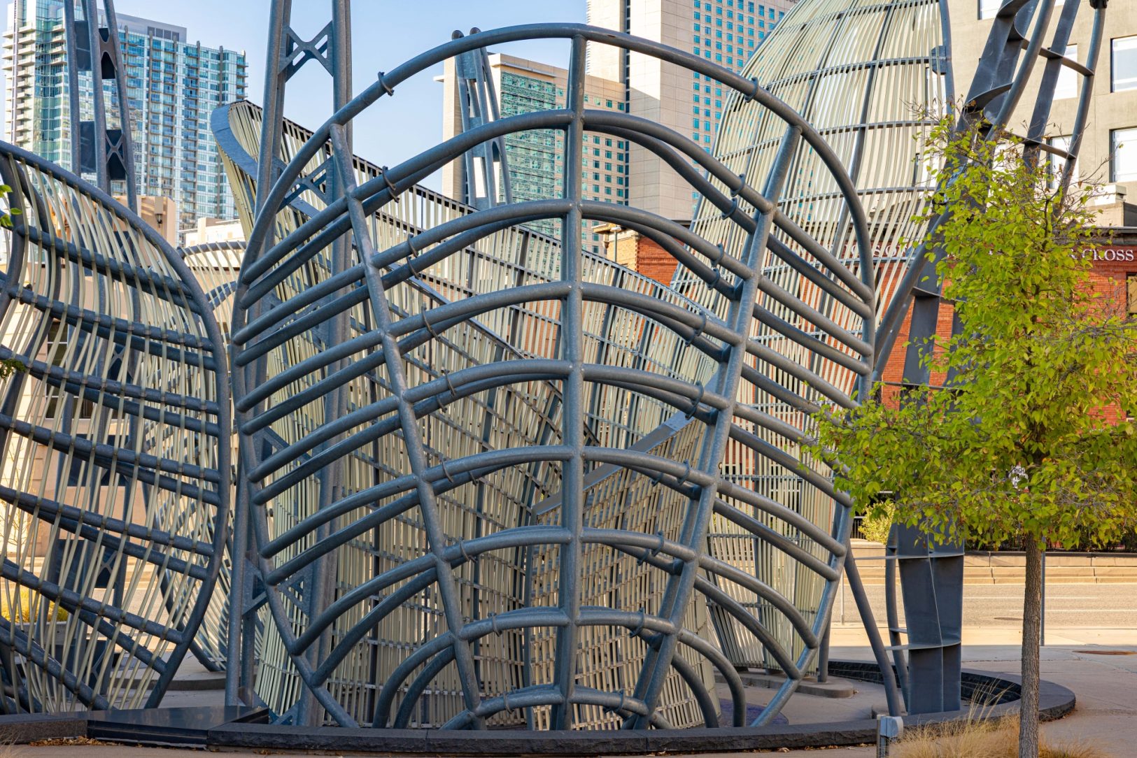

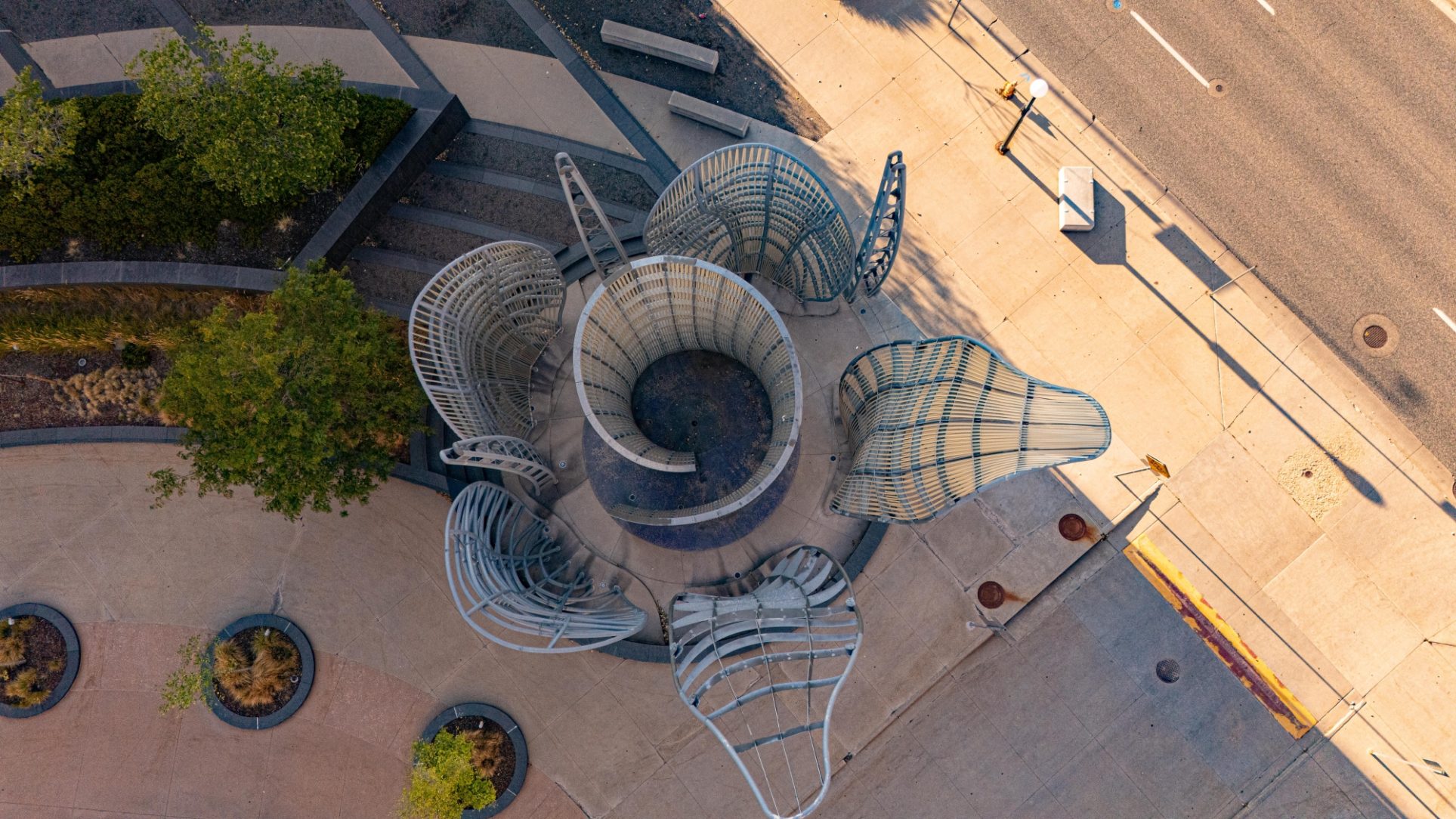

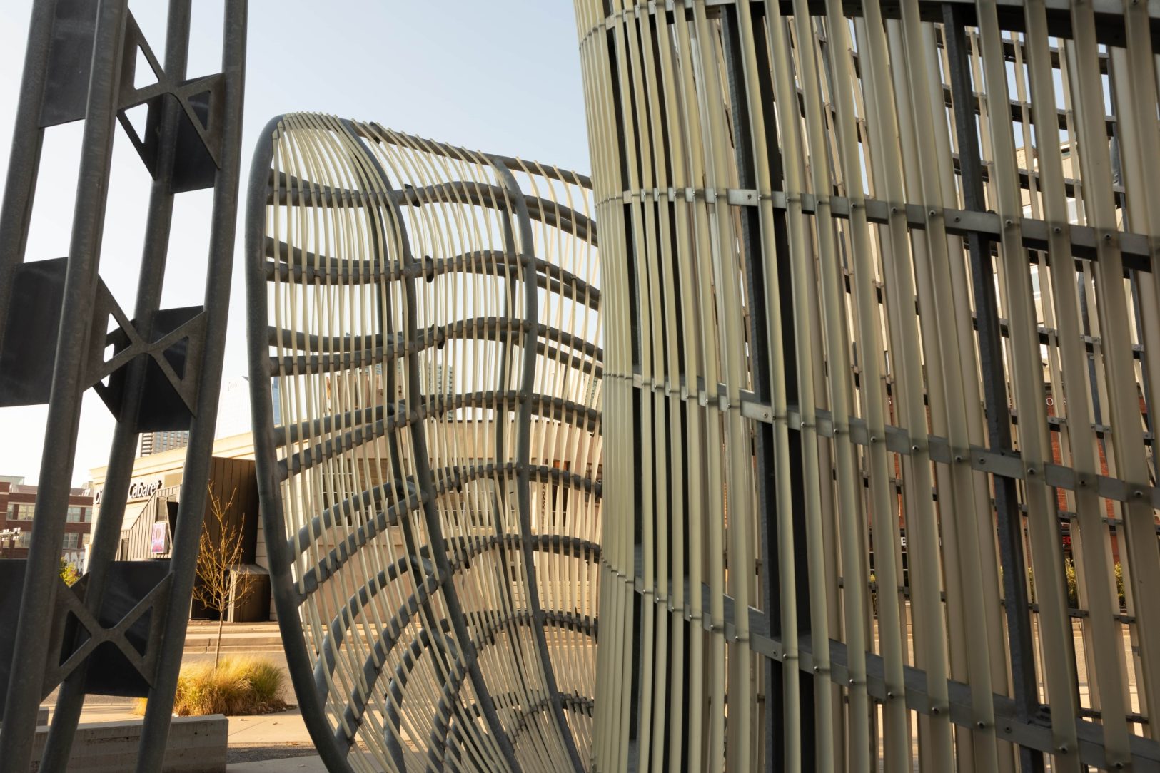

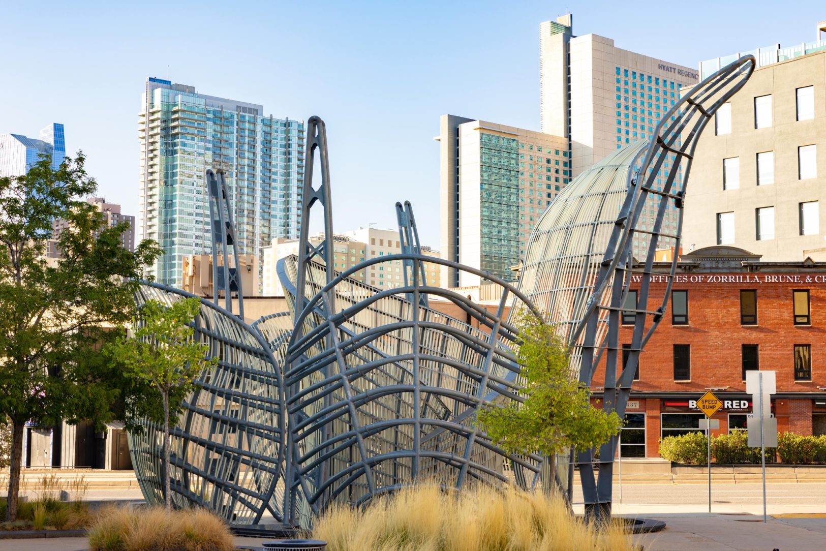

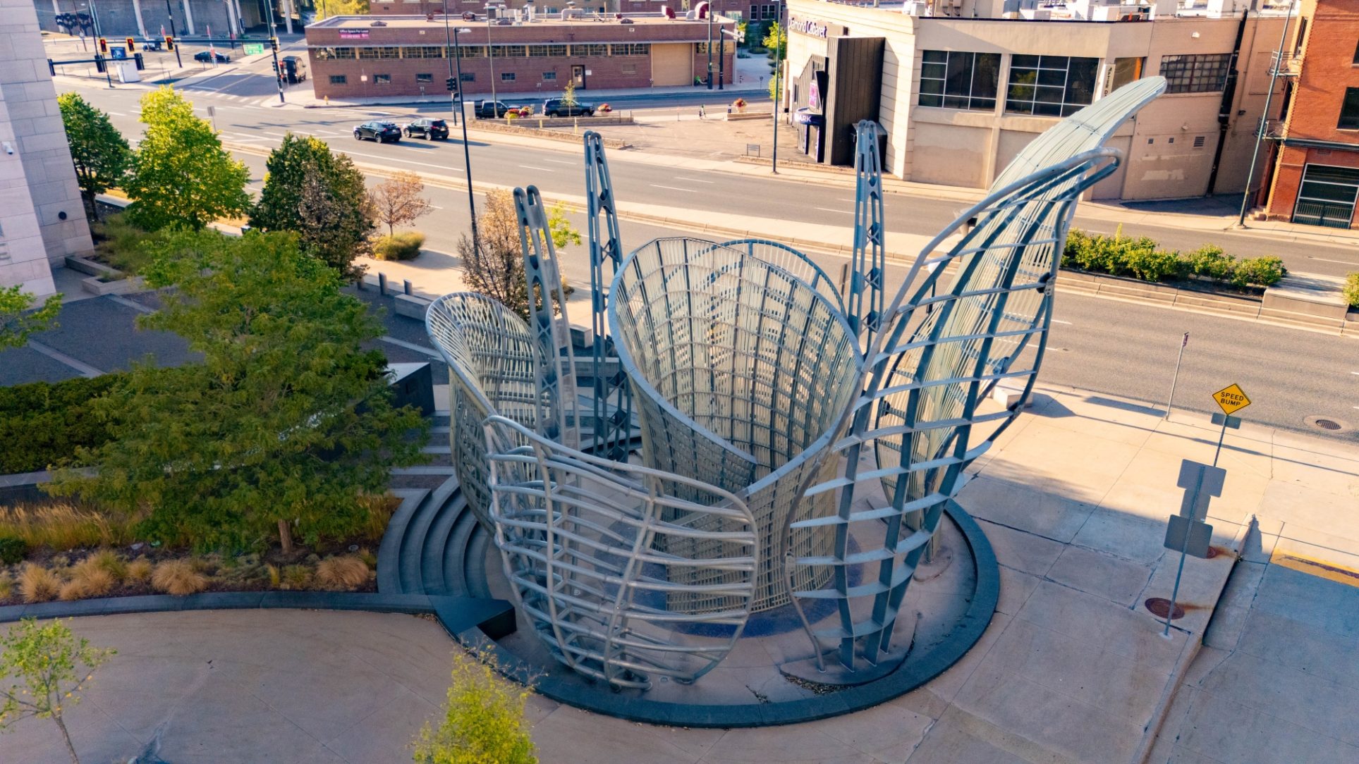

Fifteen years on, the Light Chamber has fulfilled precisely what its materials and makers promised: Quiet strength, everyday service, and a presence that feels both civic and humane. Denver’s high-altitude sun, sudden temperature swings, spring snows, and windblown grit have tested the sculpture in every season. The galvanized steel has met those tests with unwavering grace. Its zinc patina has matured to a soft, even dull gray, sealing the surface and shrugging off the stains and streaking that so often mar large outdoor works. Routine inspections have found the coating sound and continuous across edges, seams, and connections; no rusting, no peeling, only the steady proof that barrier and cathodic protection do what they were engineered to do.
In the fabric of downtown, the Light Chamber has become more than a marker at Colfax and Elati. It is a point of orientation for jurors and visitors, a rendezvous for students on public-art tours, and a daily companion for the people who work within the Justice Center. It softens the hardscape without surrendering stature, embodying the institution’s dual charge: clarity and compassion, structure and openness.

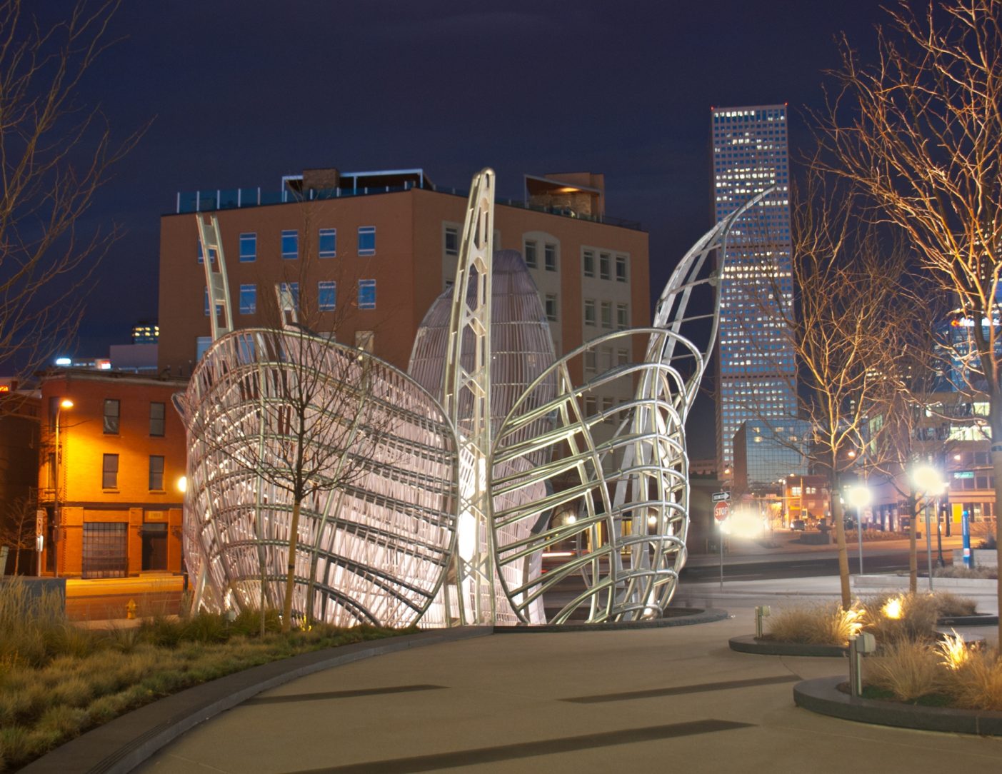

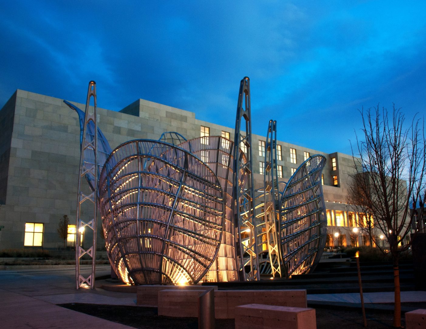

By night, the sculpture’s illumination completes the metaphor. Uplighting gathers along the ribs and pathways, sending a gentle radiance through the petals so they appear to breathe, an open hand rather than a raised wall. For many who pass after dark, including neighbors, without stable shelter, that light offers more than visibility; it offers welcome. The piece acts as a steady beacon on the courthouse block, signaling that public space belongs to the public, to everyone, as a place to pause, to orient, and to be seen.
The Light Chamber remains stately and free from corrosion, its visual presence undiminished after fifteen years. This lasting integrity is a testament to the collaboration between artist, engineer, fabricator, and hot dip galvanizer, who aligned design with process from the first sketch to the final lift from the kettle. Its durability is not the result of a favorable climate or chance, but the outcome of deliberate choices: An organic form at civic scale, protected by a hot dip galvanizing system designed to withstand a lifetime of weather. As Denver continues to grow around it, the Light Chamber stands at the Denver Justice Center as a symbol of the city's best aspirations—deliberation in daylight, guidance after dark, and beauty preserved for future generations.

All major components of this sculpture were galvanized. Various radius panels and frames.
Steel: 30
HDG: 30
