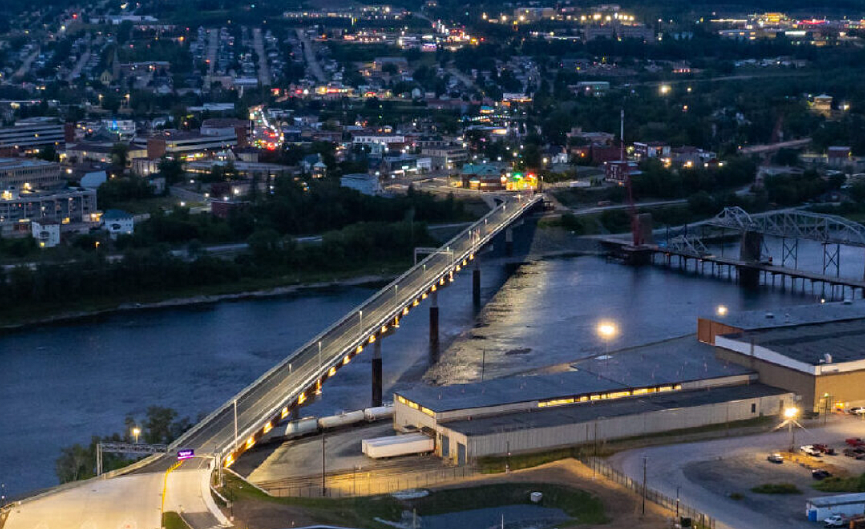

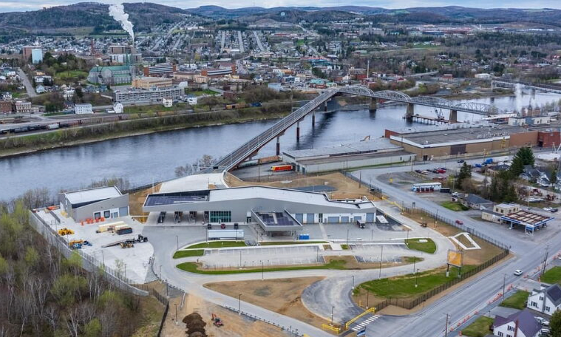

The Madawaska-Edmundston International Bridge serves as a vital connection between Madawaska, Maine, and Edmundston, New Brunswick, Canada. Originally constructed in 1920, the bridge stood as a testament to early 20th-century engineering but had significantly deteriorated over the decades due to age, heavy use, and the challenging northern climate. Recognizing its crucial role in fostering economic and social ties between these two communities, a replacement project was undertaken to ensure the continuation of this historic connection.
"This modern structure ensures a safer and more efficient connection for both communities"

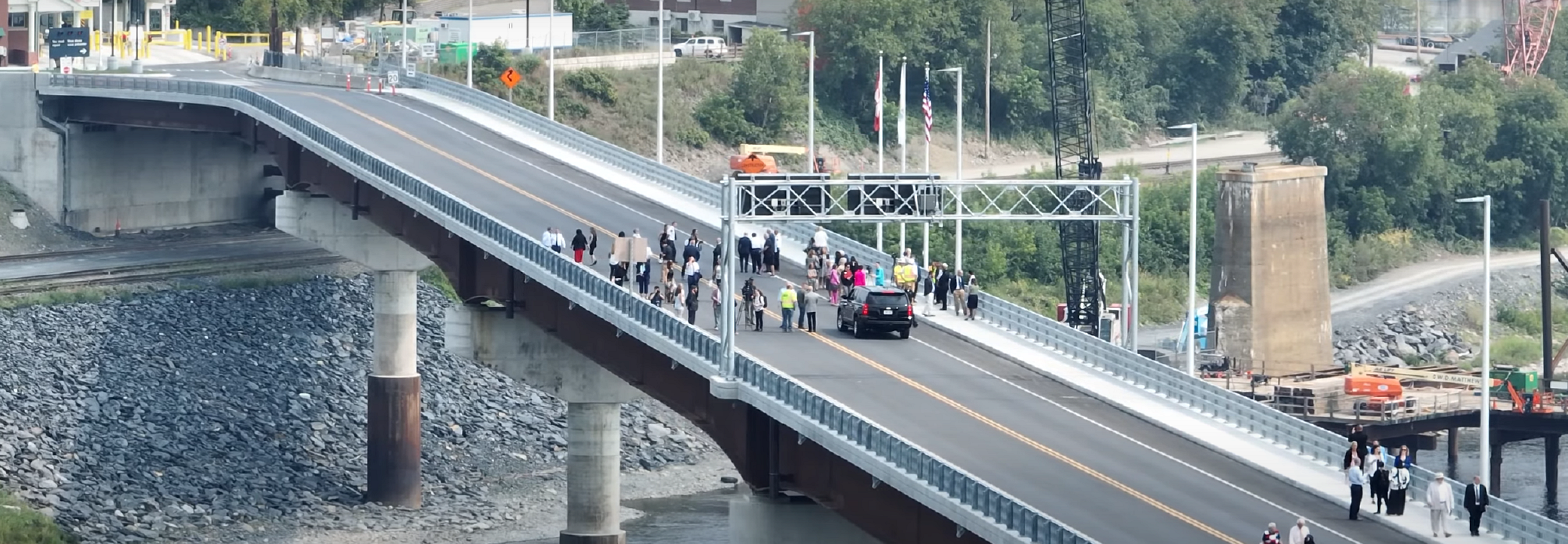

The new bridge is designed as a six-span structure utilizing a steel four-girder system. This design not only supports two lanes of vehicular traffic but also accommodates six-foot shoulders for multimodal transportation and a six-foot sidewalk, ensuring safe passage for pedestrians and cyclists. In embracing modern design principles, the bridge prioritizes functionality while offering subtle aesthetic refinement—an intentional nod to its international significance.
From its inception, the project was guided by high standards of material quality and construction precision. The international nature of the bridge, combined with the symbolic importance of its inauguration, prompted the owners to prioritize a virtual AESS finish. Special attention was given to material handling, ensuring that the structural steel was timed, spaced, wired, and treated with care to reduce imperfections. This meticulous approach minimized post-galvanizing touch-ups and allowed the bridge to shine.
The use of hot-dip galvanizing was another key decision, reflecting a deep understanding of the environmental and maintenance challenges posed by this over-water structure. Given the severe winters, corrosive exposure to water and road salts, and the difficulty of conducting repairs in such conditions, galvanizing offered unparalleled long-term corrosion protection. This technique, historically proven and widely respected in modern architecture and engineering, ensures the durability of the structure for decades to come.
The Madawaska-Edmundston International Bridge stands as a symbol of connectivity, resilience, and thoughtful design. Its construction respects the rich history of its predecessor while embodying the values of contemporary architecture: sustainability, efficiency, and community focus. For architects, the bridge serves as a reminder of how infrastructure projects can balance technical excellence with cultural significance, seamlessly integrating functionality and form to create structures that enhance both the landscape and the lives of those who use them.
