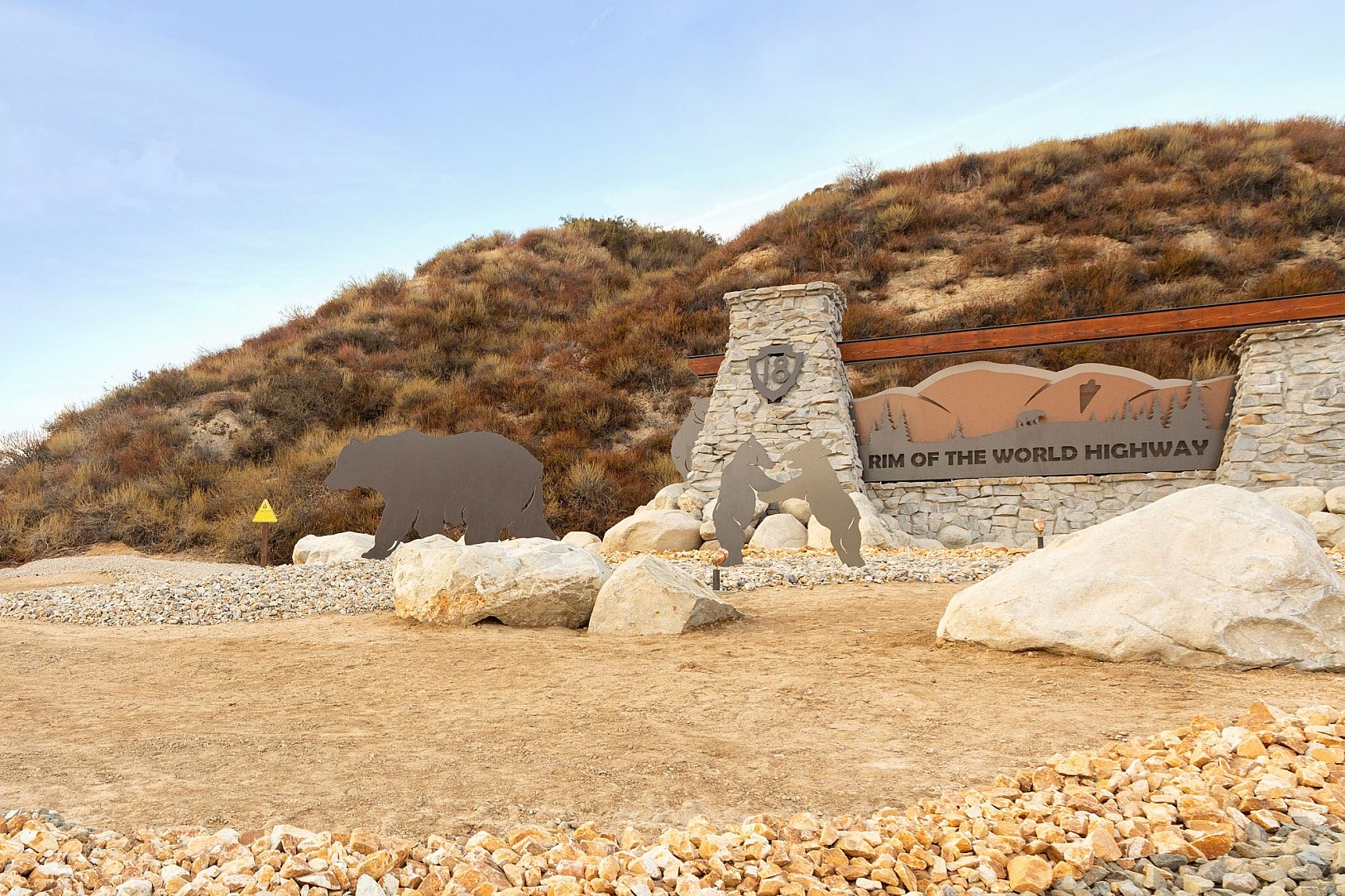

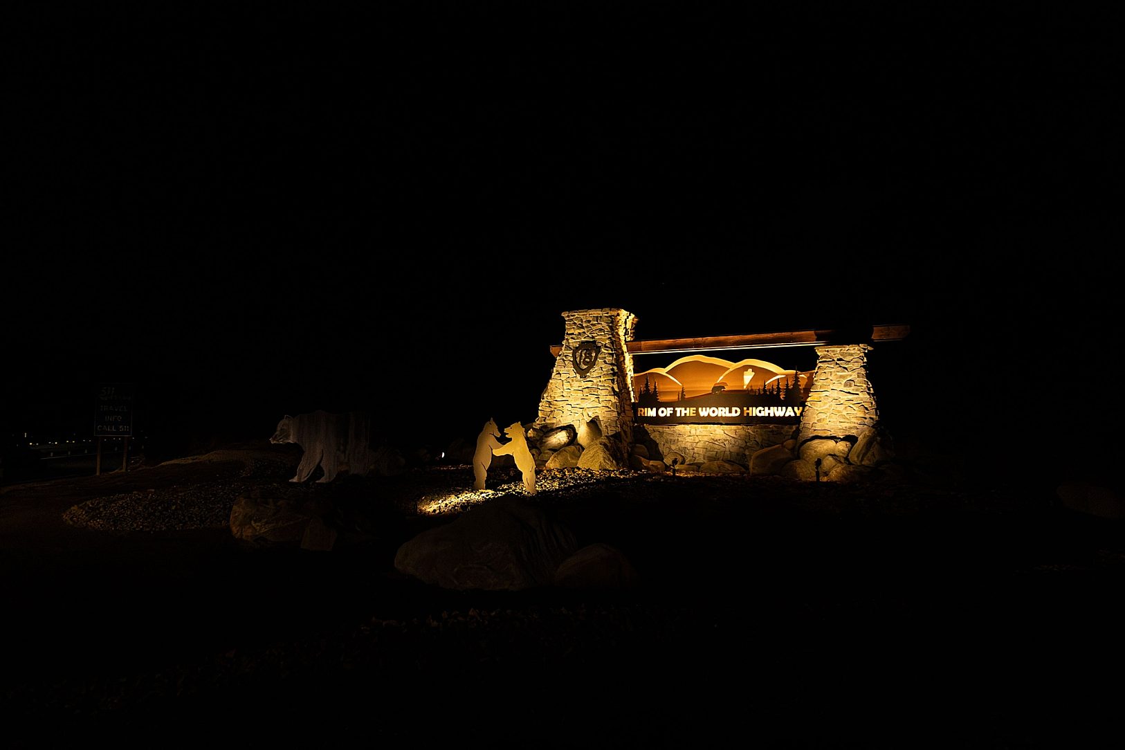

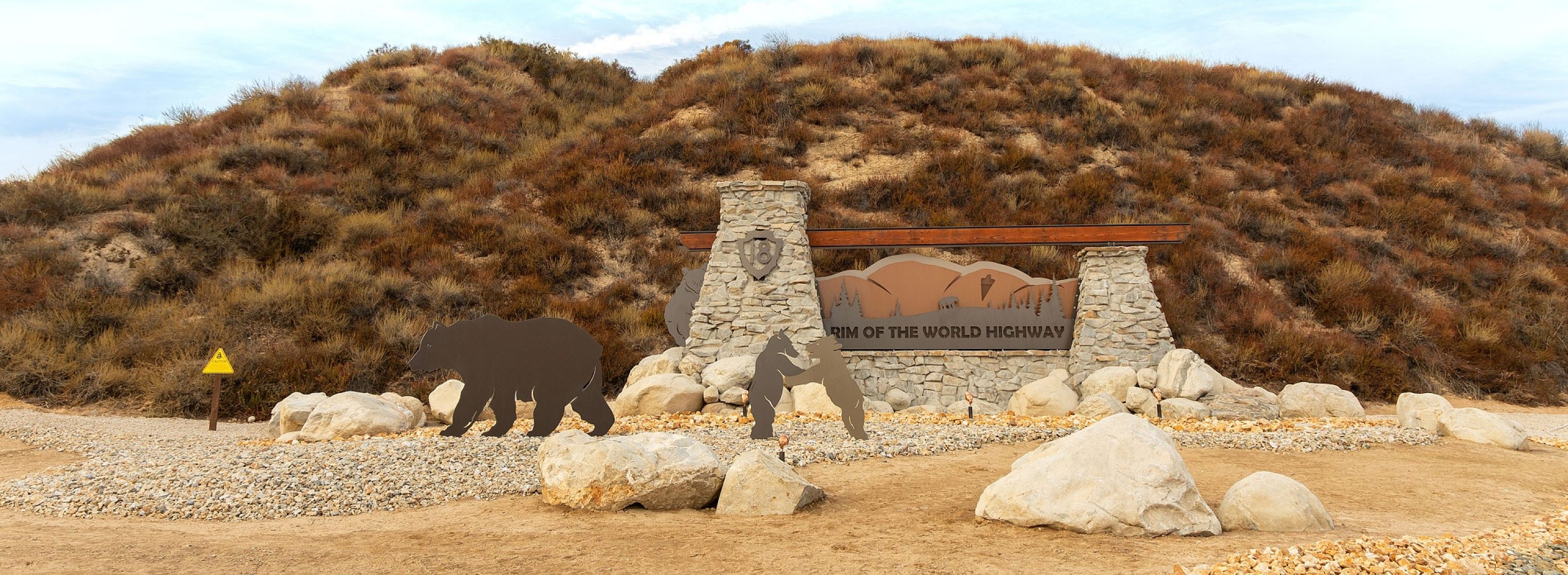

In an innovative response to a unique safety challenge in San Bernardino County, the California Department of Transportation (Caltrans) launched a project that skillfully blends art with functionality. At the Y-junction of State Highway CA-18 and Old Waterman Canyon Road — a region known for frequent bear crossings—the objective was to enhance driver awareness and safety while introducing an element of public art to the area. To achieve this, Caltrans commissioned a series of striking bear sculptures, meticulously crafted from fabricated carbon steel beams, angles, and plates. These sculptures were designed not only for visual appeal but also for durability in the harsh outdoor environment.

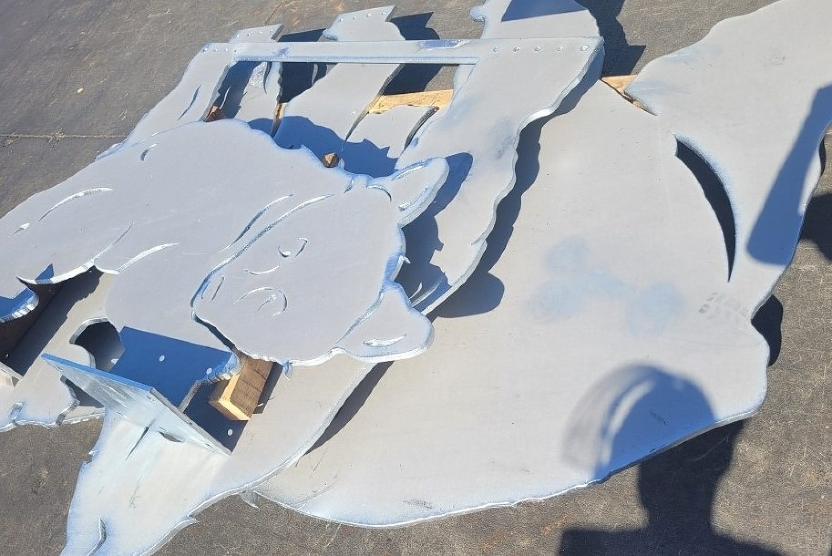

A critical factor in ensuring the longevity of these sculptures was the application of hot-dip galvanizing, a sophisticated metallurgical process that involves immersing steel components into a bath of molten zinc. This process metallurgically bonds a protective zinc layer to the steel, creating a robust barrier against rust and corrosion. The hot-dip galvanizing process not only provides cathodic protection—where the zinc layer sacrifices itself to protect the steel underneath—but also results in a durable coating that can withstand extreme environmental conditions. This step was crucial for maintaining the structural integrity of the sculptures over time, ensuring they would remain intact and visually captivating for years to come.

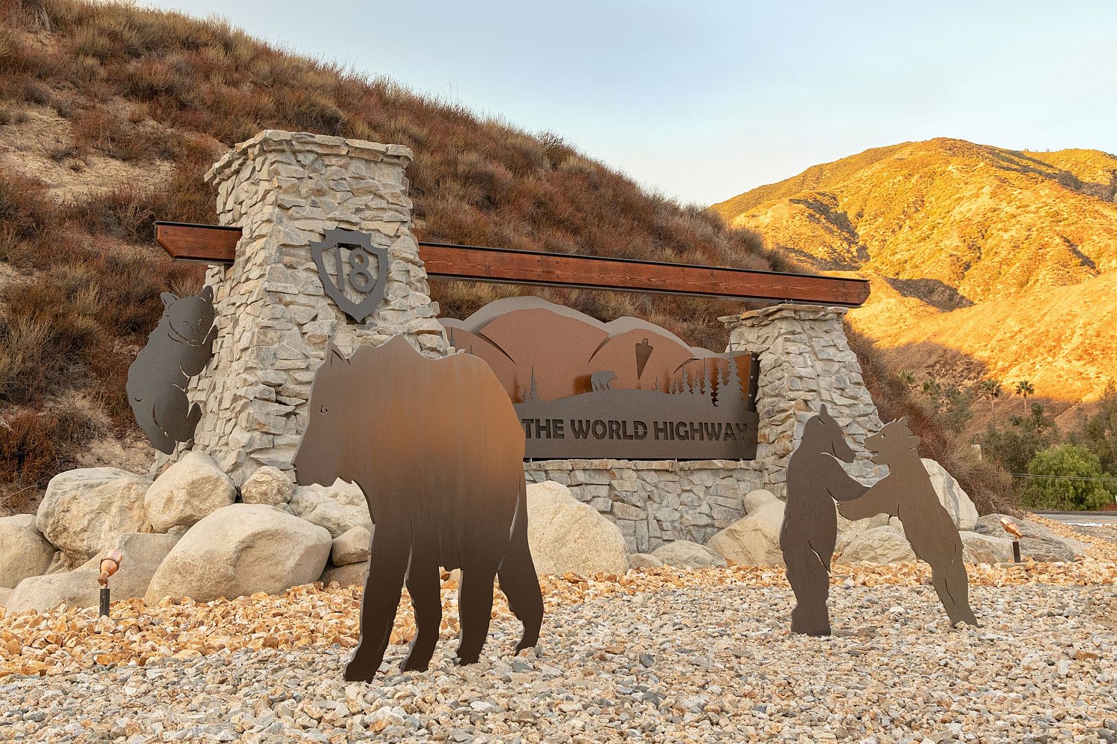

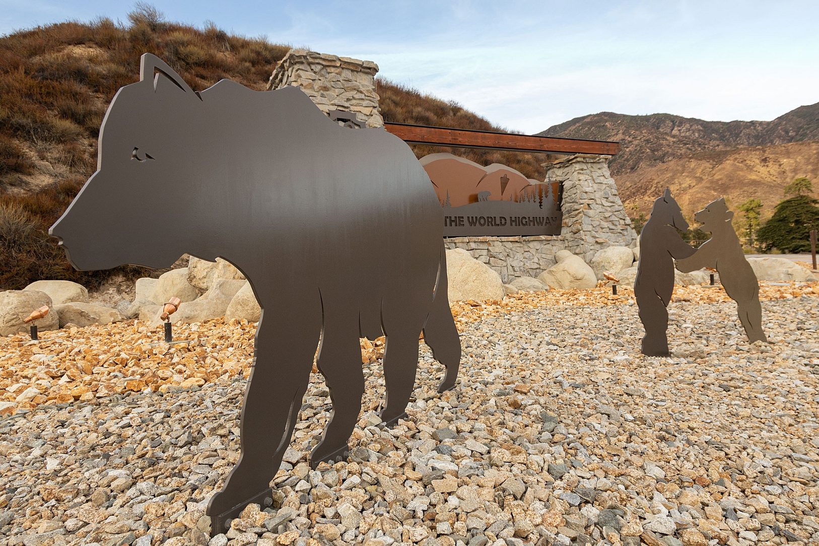

Following the galvanizing process, the sculptures were carefully painted to enhance their visibility and add a vivid, artistic touch to the intersection. While the paint contributes an extra layer of protection against the elements, it is the hot-dip galvanizing that fundamentally underpins the sculptures’ resilience. This process enables them to endure the coastal weather conditions typical of Southern California, ensuring their longevity and effectiveness in enhancing road safety.
