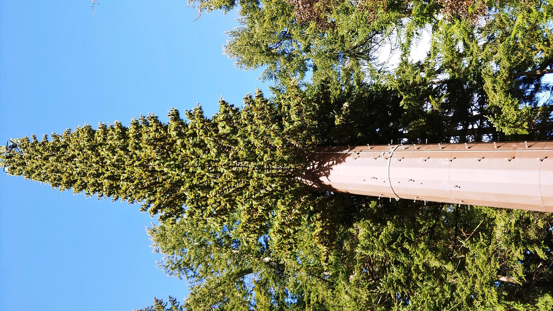

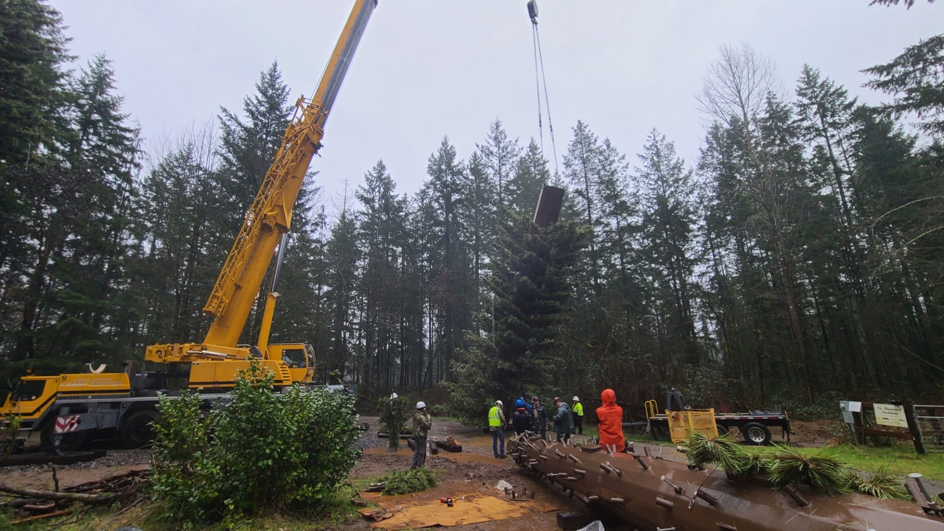

The suburban neighborhood of Port Orchard, Washington is known for its dense, wooded surroundings full of natural beauty. Sitting up in the Pacific Northwest, it has been the home for human residents and a variety of wildlife. Residents of the area began to express concern about cellular connection in the area and the potential eyesore of a traditional tower. The solution? A 150-foot “monopine” - a cleverly designed structure that mimics a tall pine tree, native to this area of North America.

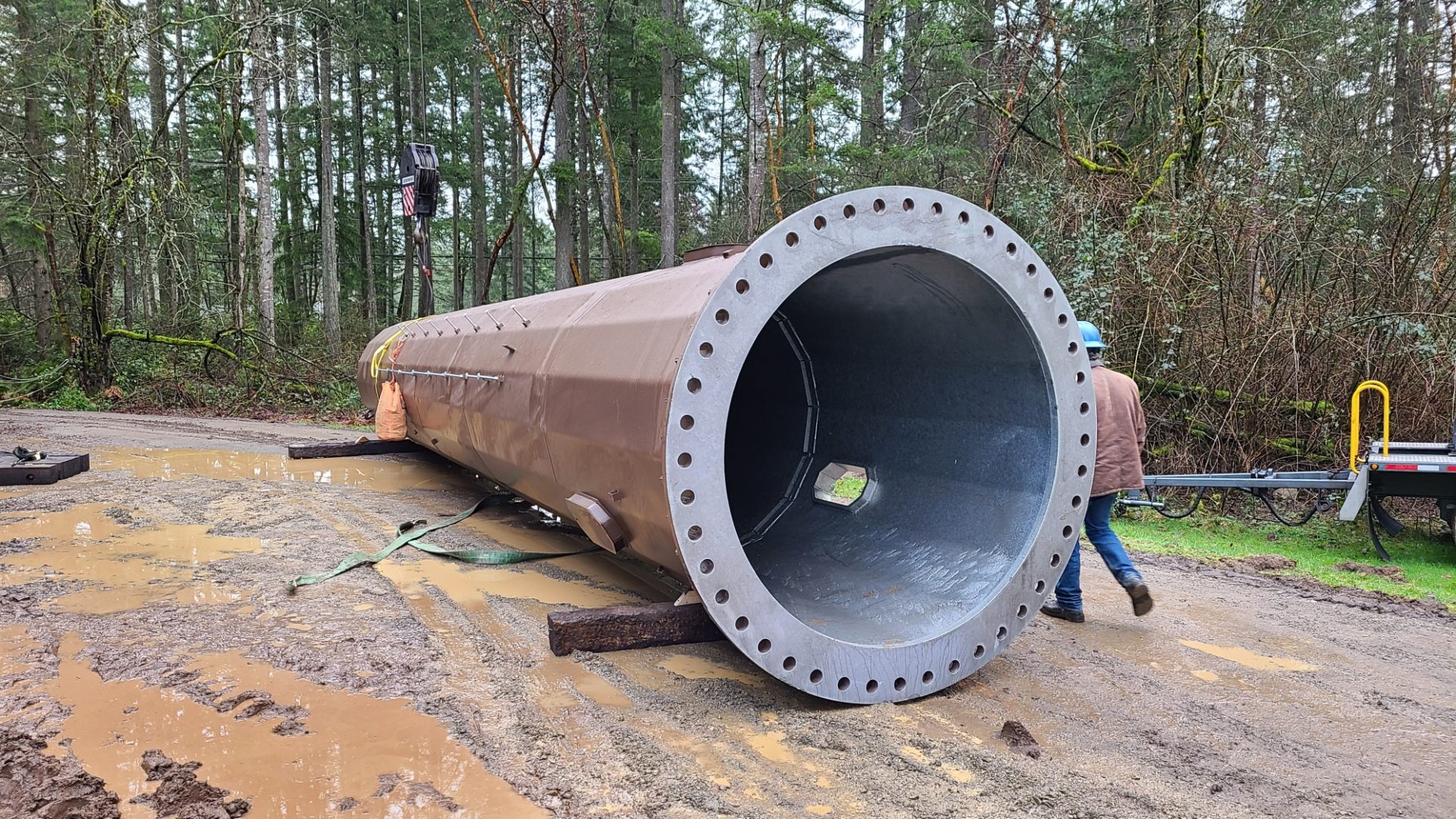

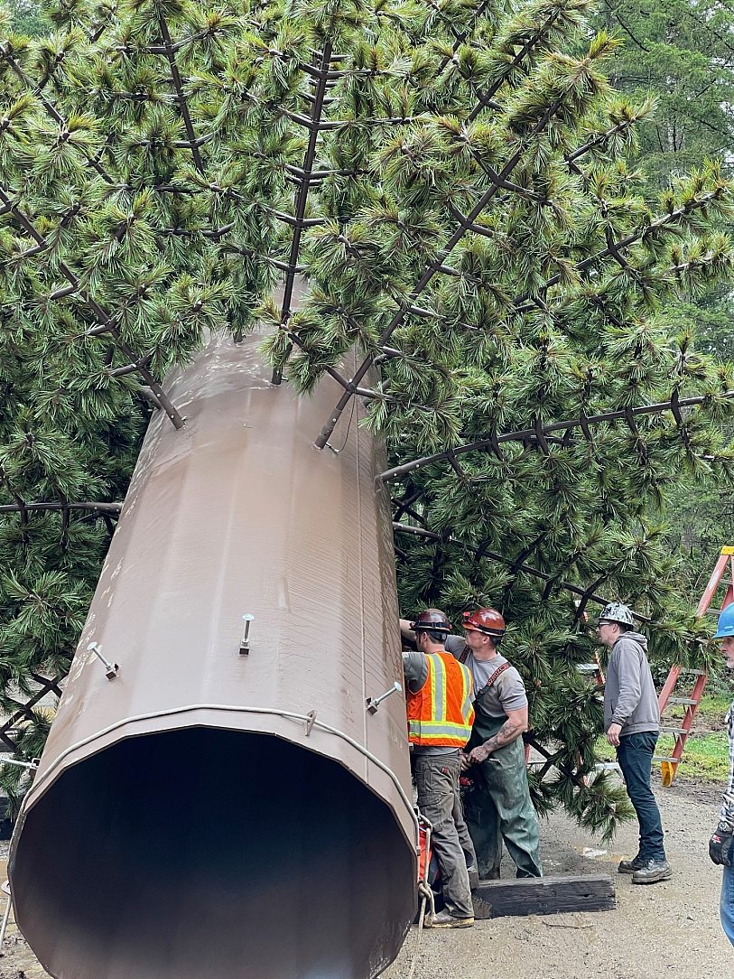

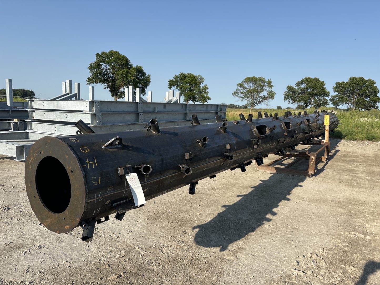

The galvanizer chosen for the project worked alongside the contractor to ensure a seamless process from start to finish. This required frequent communication and the ability to adapt quickly to any changes along the way. The challenges in galvanizing this unique structure were considerable. There were multiple anchor points and attachments to embody the “branches” and “needles.” Careful attention to vent and drain hole placement was paramount in this project to ensure a quality finish. Each step of the galvanizing process (hanging, pre-processing, dipping, and cleanup) had to be meticulously planned and executed by the galvanizer to assure a finish that would provide excellent corrosion protection, meet all functional requirements, and provide a beautiful structure.
Standing tall as an example of how essential infrastructure can be designed to serve modern needs while respecting the natural aesthetics of the environment, the Monopine Communications Tower blends seamlessly into its environment and provides critical communication support to the area. For future generations, with a life-expectancy of more than 100 years, this project will continue to impact the people of Port Orchard by representing innovative design and thoughtful technology.
