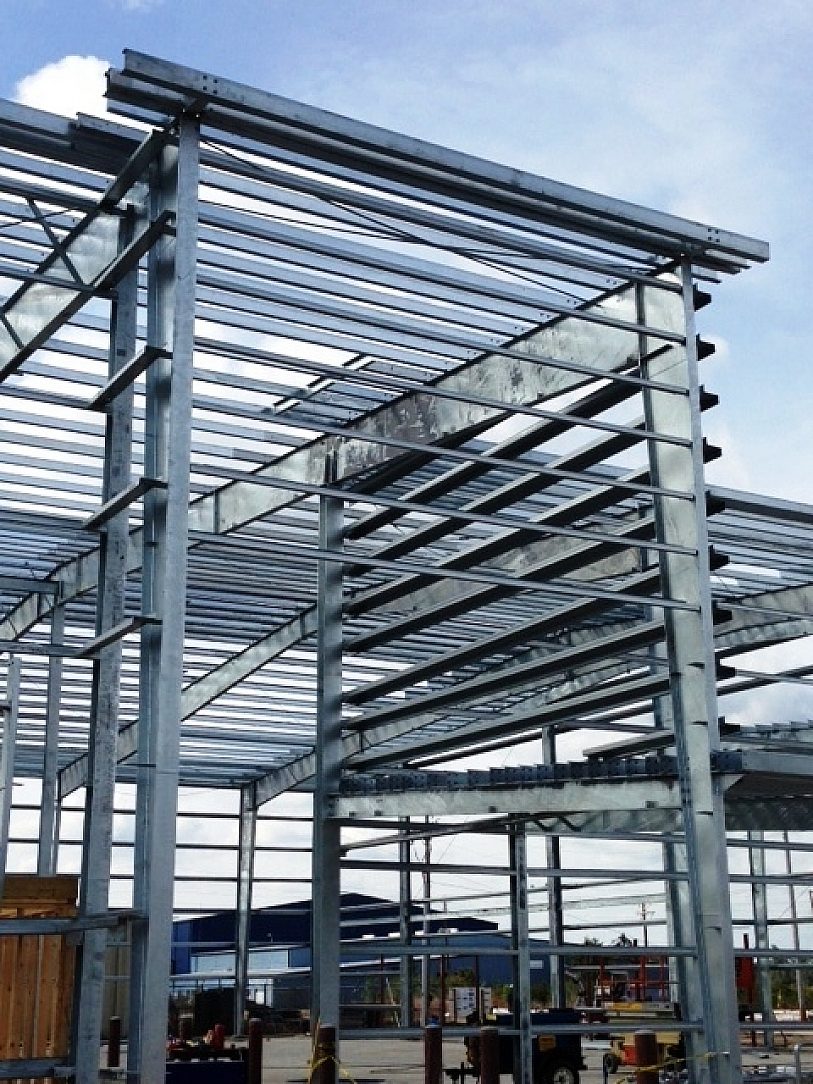

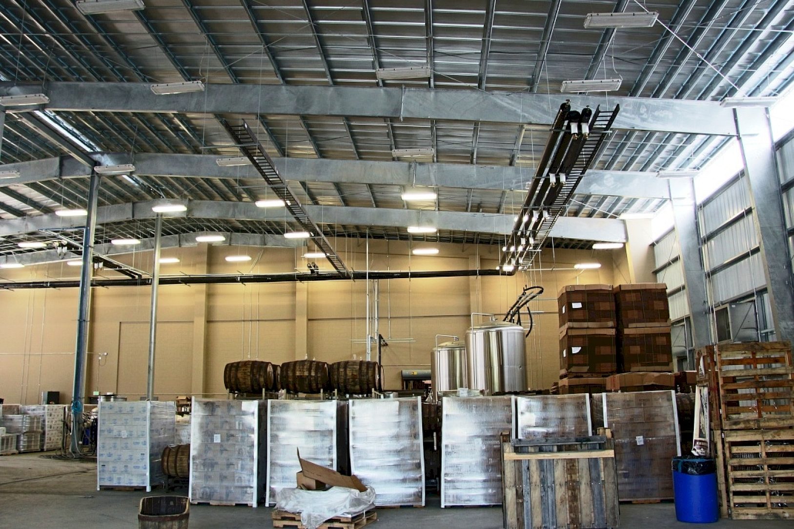

Hot-dip galvanized steel will be needed for corrosion protection.
The owners specified hot-dip galvanized (HDG) steel for the building expansion because of its cost-effectiveness and durability in the harsh conditions of the brewery. Steam and changing pH levels required a degree of protection only HDG could provide. The owners are engineers so they used ingenuity in design making the building tall enough for the brew house and large enough for additional equipment when needed for any future expansion. Planning for low maintenance included HDG trusses that could be inaccessible due to process equipment placement, and any down time would be costly. The brewery was in operation while the construction was in progress so on time delivery was critical to avoid delays. The fabricator and the galvanizer worked together to expedite the job and provide progressive dipping on the trusses where required.
Craft beer is catching on in Mississippi. The Magnolia State has recently changed beer laws allowing alcohol by volume at 10.2 percent. This will mean more expansion of craft breweries where hot-dip galvanized steel will be needed for corrosion protection.
